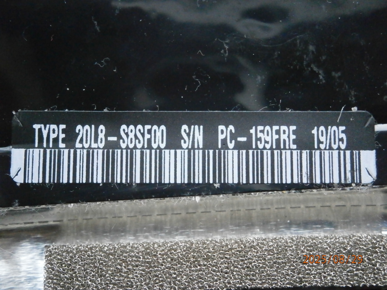

            • CountDImi
              • Aug 2025
              • 4
              • Estonia
              Hello. Having Issues with my Bios. Black screen. Keyboard lights up nothing else. Tried to replace Bios chip from other same model computer did not help.
              T480S 20L8
              Premium supporters get full download access and other benefits.
                • 24660
                T480S 20L8
                Type the laptop serial number, full name and model, motherboard model, etc.
                read the forum rules..https://www.badcaps.net/forum/troubl...before-posting
                • CountDImi
                  • Aug 2025
                  • 4
                  • Estonia
                  Here

                      #30
                      Hello after swapping BIOS chip between 2 same model laptops second working one stopped booting.
                      TYPE 20L8-S8SF00 S/NPC-1339ZJ 19/03 Bios and EC.bin attached.
                      Thank you.
