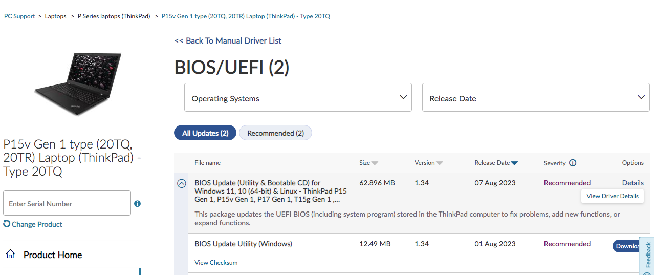

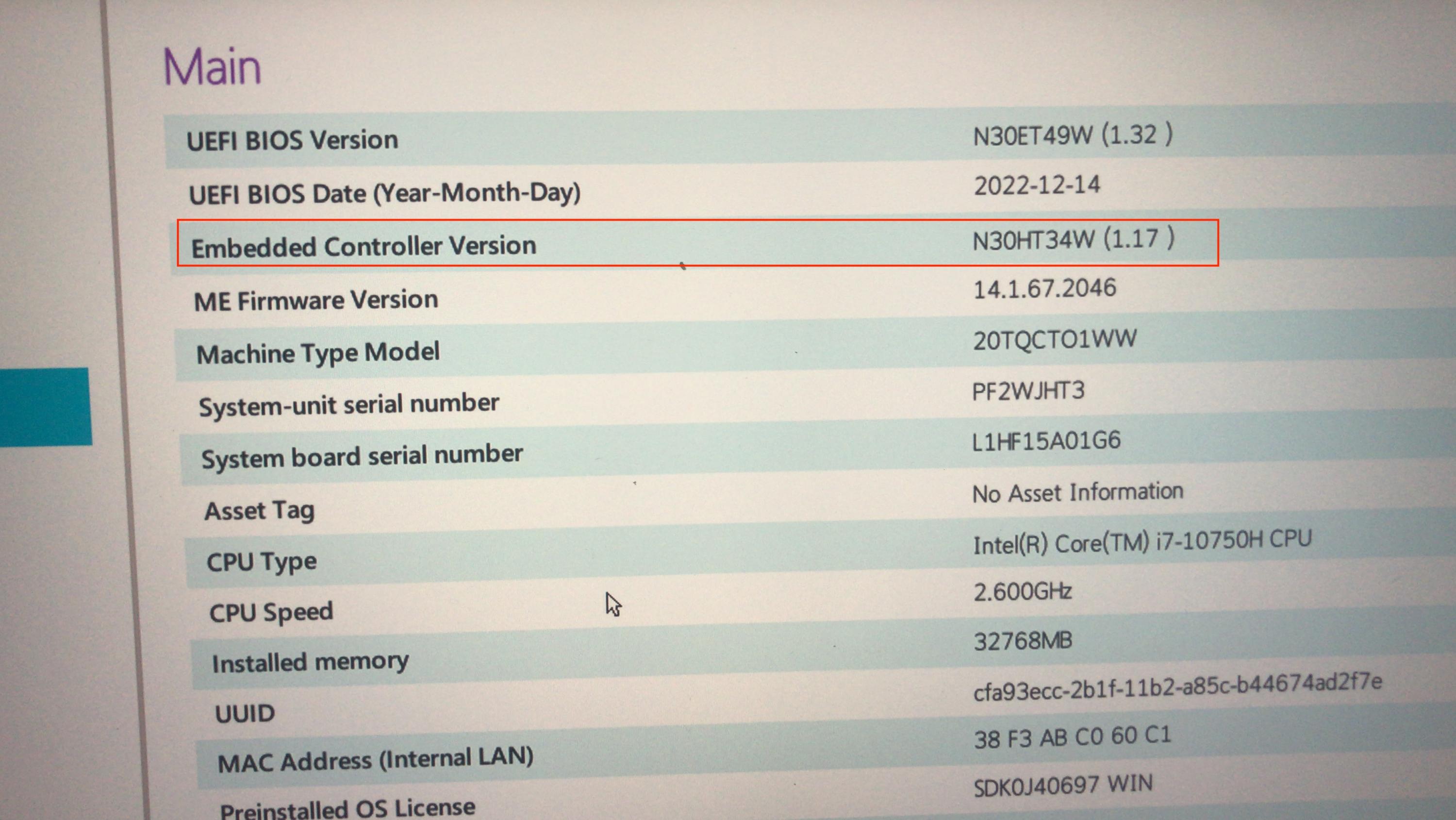

              Re: Lenovo ThinkPad P15v bios needed
              I have a P15v that, after bios update from windows update, it started overheating and CPU is throttling. I noticed that windows update made a EC update to v1.14 (N30HT34W) and this version doesn't exist in Lenovo official update, last EC version being v1.16 (N30HT33W). I was able to downgrade bios but it doesn't also downgrade EC version. So, my question is if lenovo bios upgrade program can be altered to force a EC downgrade (something like alter ini file to skip verifying EC version but I can't find ini file). EC is NPCX897 and I can't modify it (I have a RT809H).
              S/N: PF-2WJHT3, model 20TQ , attached bios dump, please verify also bios dump maybe something is also wrong in it.
              Thank you!
                • 20949
                Thank you!
                The last EC version is N30HT34W
                https://download.lenovo.com/pccbbs/mobiles/n30uj17w.txt

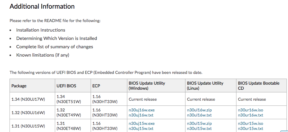

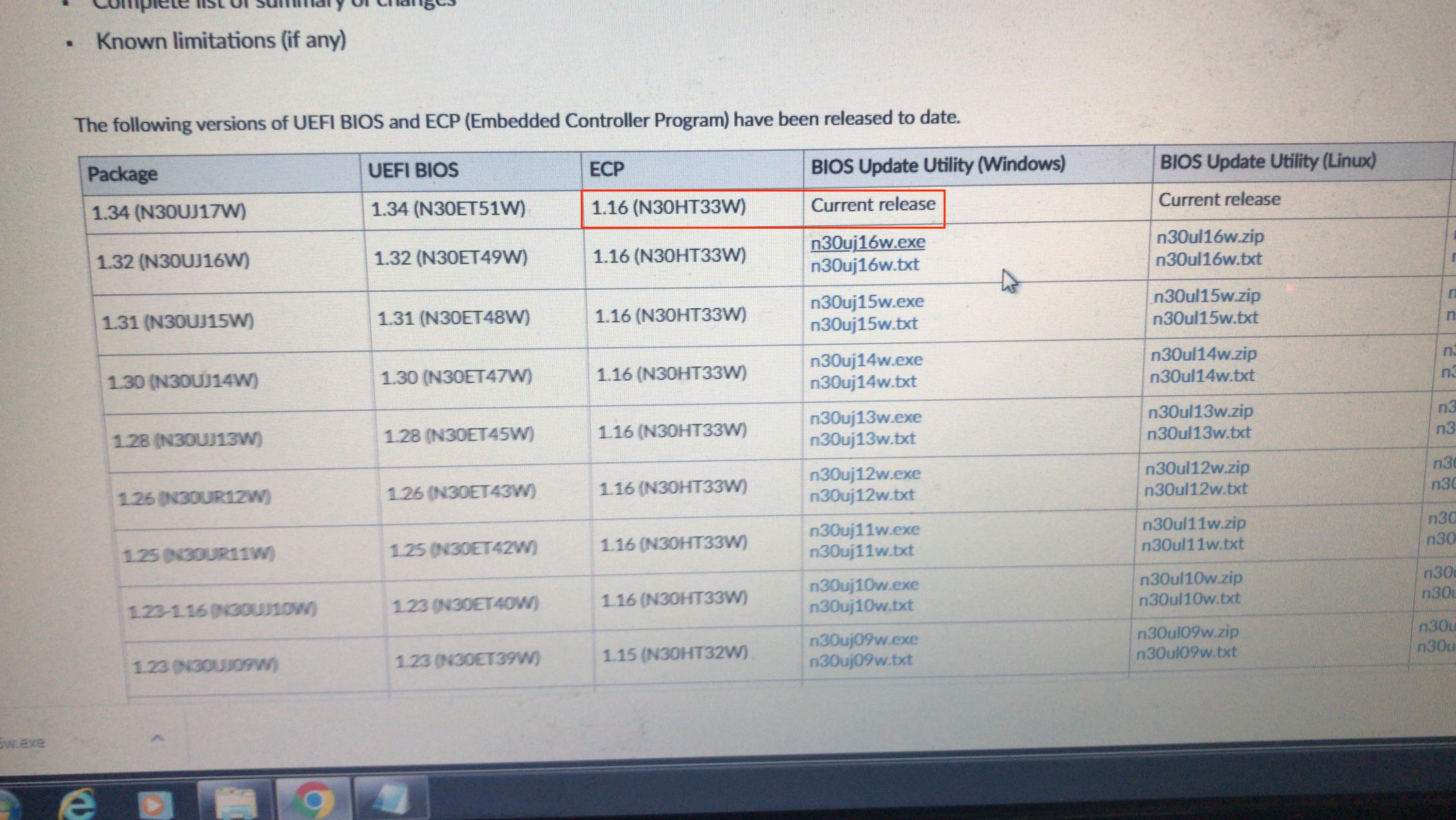

                  Code:
                  Package   (ID)   UEFI BIOS (BIOS ID) ECP (ECP ID)   Rev. Issue Date
                  1.34   (N30UJ17W) 1.34 (N30ET51W)   1.17 (N30HT34W)  02  2003/08/04
                  D1702 looks a little bit wonky
                  that's funny, if you click on "details" and scroll down you'll find this: (see photos) . But it's good to know that v1.17 was released in 2003
                  also, extracting files from latest bios update i found for EC "N30HT33W" which coresponds with v1.16
                    • 20949
                    2003 i didn`t notice that

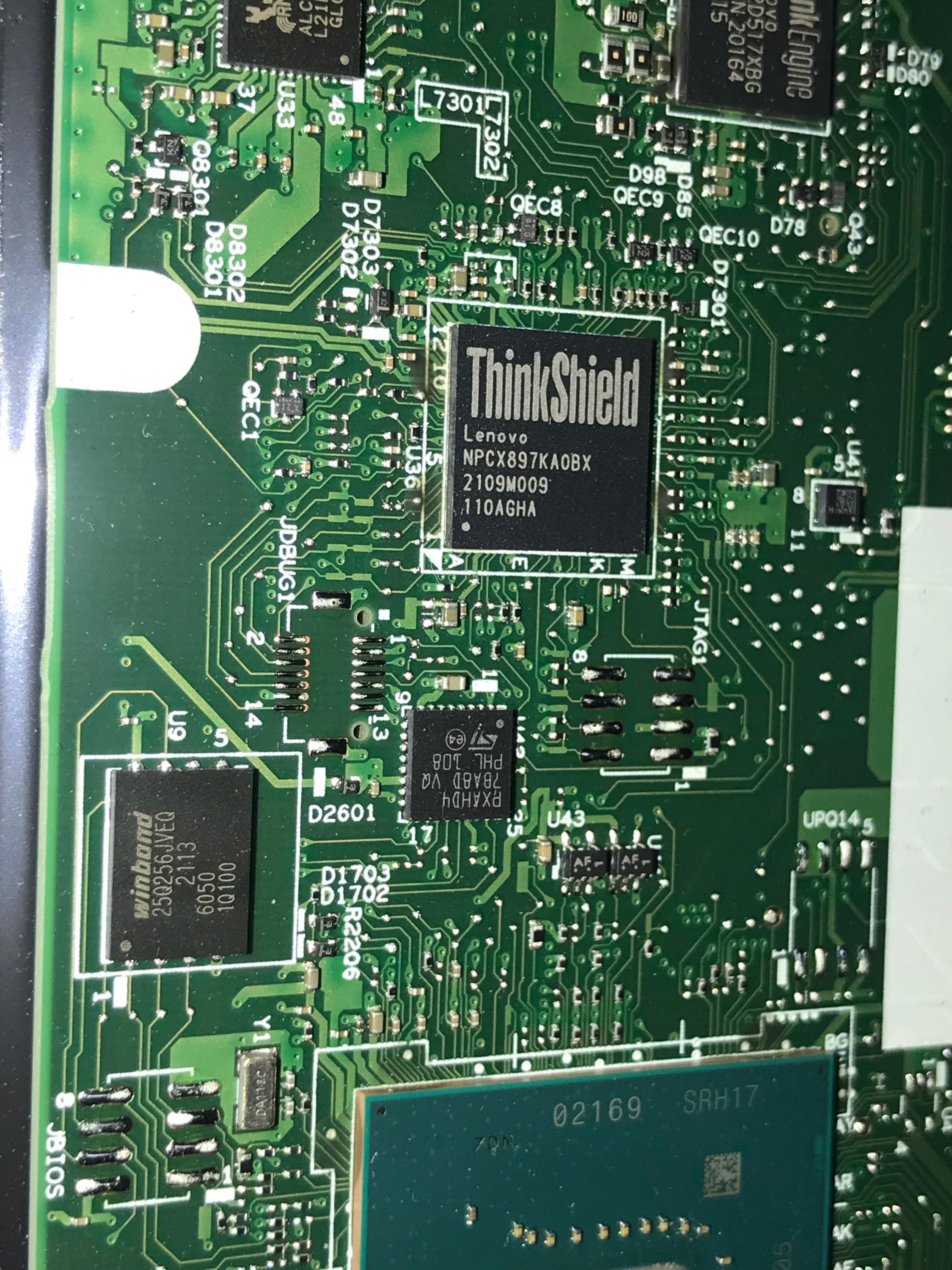

                                hi there
                                have here p15v thinkpad lenovo
                                serial number pf-309c95 ,
                                goes off after sometime , then it turns on again with self healing process , and so on ,
                                changed the bios chip with new one after transfering the orginal dump .. still the same, tried to rebuild the dump file but it ends up with wrong size file
                                i dont know what im missing here
