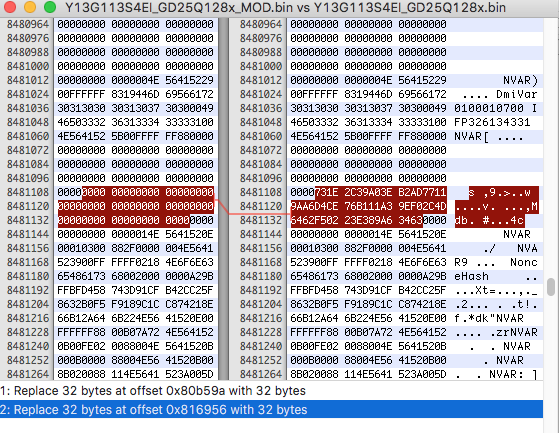

      Ah ok
      When I open my file whith Hydra it give me :
      &l;V[j\H8-. in (QWERTY)
      (SHIFT + 7) & m V ^ j * H _ ( MAJ + ) ) : in (AZERTY)​
      It's not possible ?
      I Try in azerty but it doesn't work
      I can replace 26A5D2826C1FDBF2F93B1380D356C383F85B086AAA5C489838F8AC5FF22E1FE9 by 0000000000000000000000000000000000000000000000000000000000000000 to have no password ?

            see how simple it is when you follow the rules?

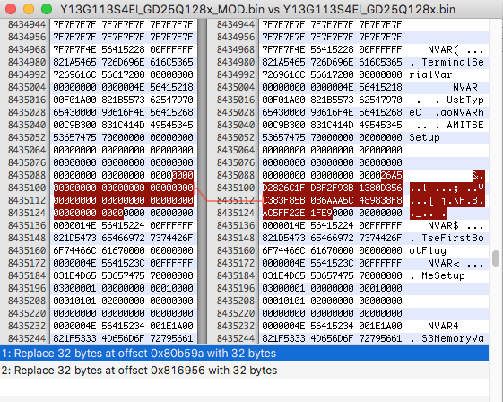

                #47
                Originally posted by MaxKweeger
                Sorry
                I try
                Thank you very much
                Is it possible to explain how do you do that ?
                password is in 2 places, if you compare original file vs. modified file you'll figure out ...

                  #48
                  Ok you replace by 00
                  It's work very well No password in my BIOS now 😍😍😍

                          #52
                          Originally posted by minhdigital
                          Send to you
                          no work sir
                          i try we can change in 2 place or one
                          password stay here

                            #53
                            Originally posted by jackx
                            no work sir
                            password stay here
                            try
                            • jackx
                              • May 2020
                              • 220
                              • casa1
                              #54
                              try
                              thank you volinakis you are the best in this forum
                              it workk
