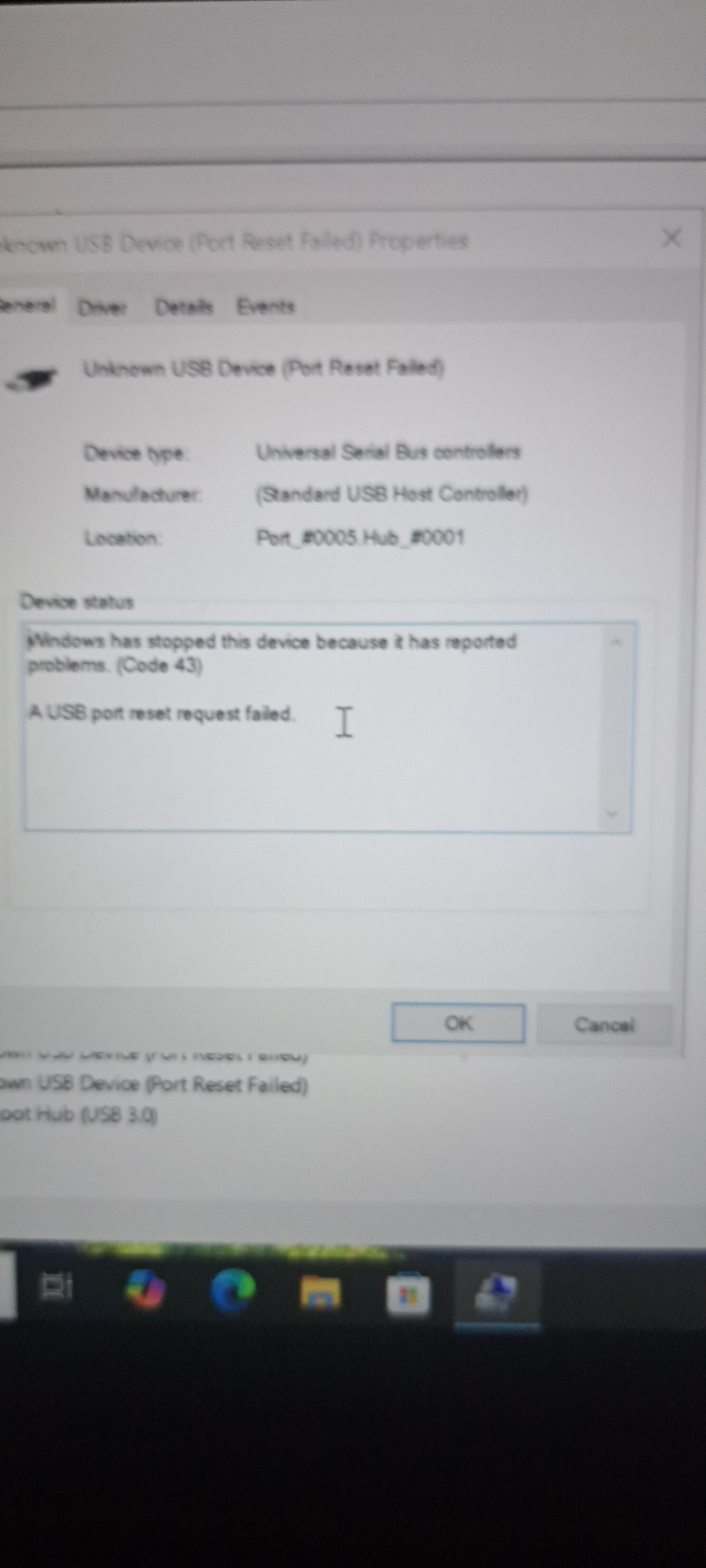

                Please i need password for BIOS UNOWHTY Y13 ÎLE DE FRANCE
                model: Y13G010S4EI
                sn: IFP045001537
                bios version: V0.5.0_P1S0M2E0F3L6B0T0P2G00A0U0D601_ENE
                motherboard model: MG133(EM_IG116_366B_ENE_V2.0)
                bios date: 10/28/2020
                Motherboard : EM_IG116_200b_ene_F_V1.0.
                Cannot boot to USB after Factory Reset (only if there is a key combination to do so), don't have the tools to unsolder the chip.
                BIOS and EEPROM .bin file in attach.
                I can upload some photos of MB if needed
                Thanks in advance !
                P.S. F8Hv4U3T67 doesn't work, I also tried another 7 passwords for 2021 Unowhy.
                • martingheorghita

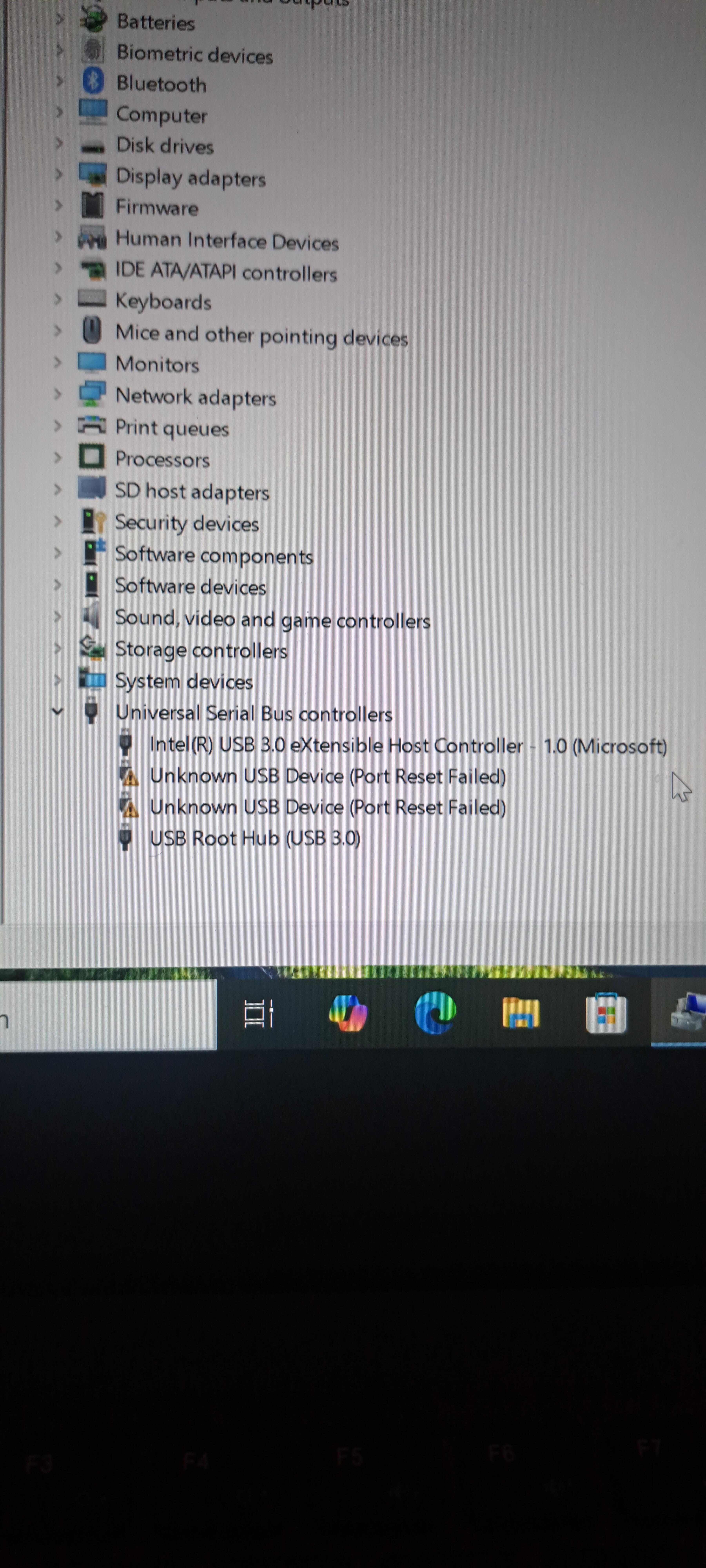

                      • martingheorghita
                        • Jul 2018
                        • 9
                        • RomΓ’nia
                        #171
                        Originally posted by martingheorghita
                        Thank you a lot !
                        I will write it this evening.
                        As I said I write Bios and no password at boot and the laptop works fine.
                        Unfortunately the USB 2.0 and camera don't work (as initially ) and it requires password when I try to enter in Bios Settings.
                        Is there a default password??
