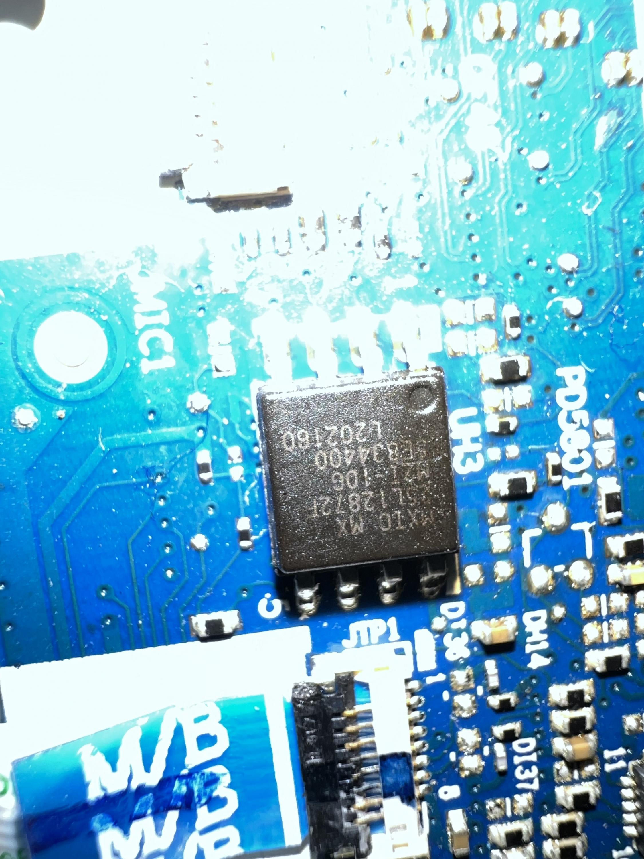

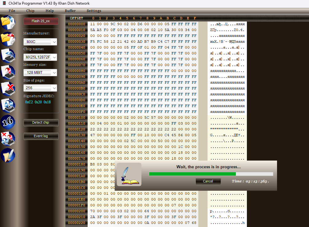

        FYI this is my bios chip and the software I am using (Asprogrammer does not have 25l12872f, only 25l12873f). I unplug the CMOS battery and main battery before flashing, I cleared it before writing and also verified after. Once I boot the bios is different from the virgin one but I am guessing that is what is supposed to happen.
        I guess it's also worth mentioning that I suspect the GPU on my laptop has an issue which is why I updated the BIOS in the first place. Is it possible that the BIOS is booting into discrete graphics mode only? Is there a way to change that without a screen? (I tried external monitors, but no dice)
          Try NeoProgrammer V2.2.0.10 , it does support 25l12872f
          https://www.badcaps.net/forum/showpo...postcount=2374
          Also try with older version of the bios, look at the fist page of the thread.

            I tried the programmer and the bios hardware1 made and I managed to get it to the original issue where disabling hybrid mode would cause the black screen issue. I did some stupid maneuvers to disable it within windows but now I can finally see the screen!
            Thanks!
            Now to fix the 2060 vbios
