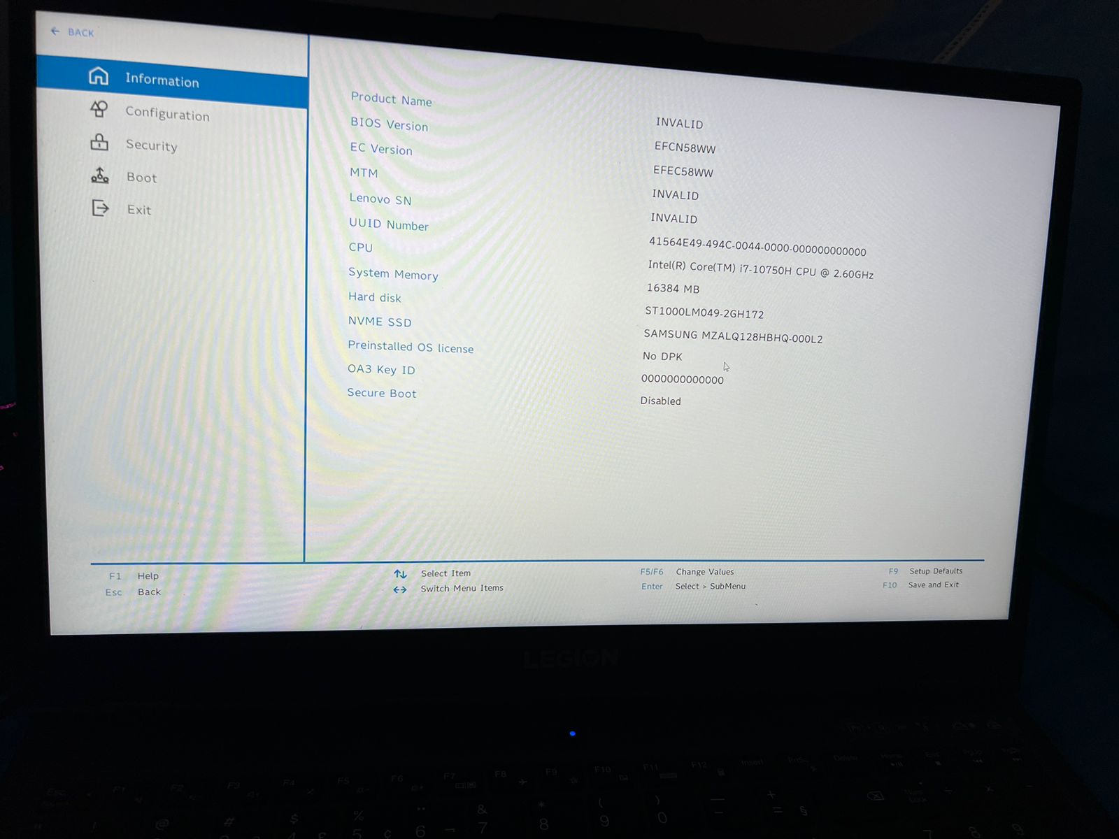

                                  the only thing that makes him give an image is this one
                                  • Vesko356
                                    VIP Moderator
                                    • Aug 2018
                                    • 4386
                                    • Bulgaria 🇧🇬
                                    Re: Need LenovoLegion 5-15IMH05H NM-c911 bios Clean dump
                                    This is exactly the same type but the latest available (58) version EFCN58WW.
                                    And the file by hardware1 at post #10 is also latest EFCN58WW, it's a virgin one with your DMI info, so should be working. Try again, maybe you didn't programmed the file to the chip as it should, or something else. Do it again, the file is 100% OK, I just checked it out.
                                    Become a Badcaps supporter
                                    Thanks to all supporters.

                                      yes friend... but this notebook is so crazy that it is not recognizing neither BIOS that you made nor Hardware1. The screen goes black with the light blinking
                                      and when I put that other BIOS that I honestly don't know why it's called 58WW because it's definitely not 58WW.
                                      It's actually an Ideapad Bios and when you turn on the notebook in the image and it recognizes itself as an ideapad
                                      but the keyboard does not work. it turns on the leds and works the keys from f1 to f10. but not the rest
                                      • Sergio06
                                        • Mar 2023
                                        • 16
                                        • Brasil
                                        in the bios it is saying that it is the 58WW but in reality the bios that is in it is the one in the print
