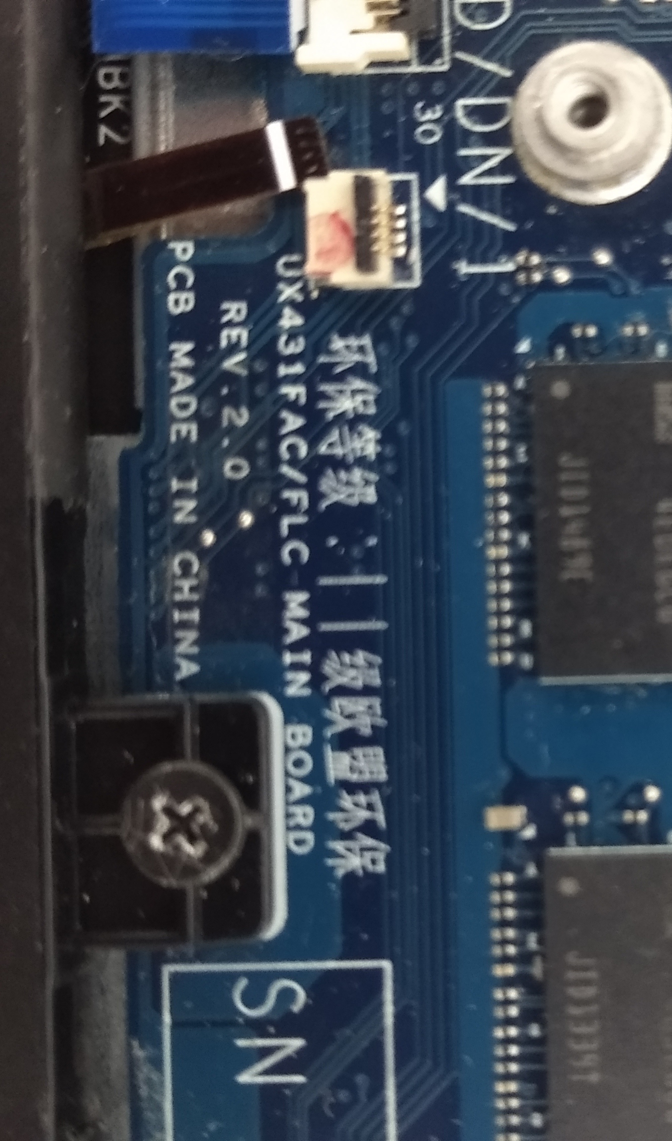

    Please, I need bios bin file for Asus UX431F
    The motherboard is: UX431FAC/FLC REV 2.0
    The bios chip is: XM25QH128AHIG
    Attached original bin file and photo of the motherboard with its reference.
    Thanks in avance

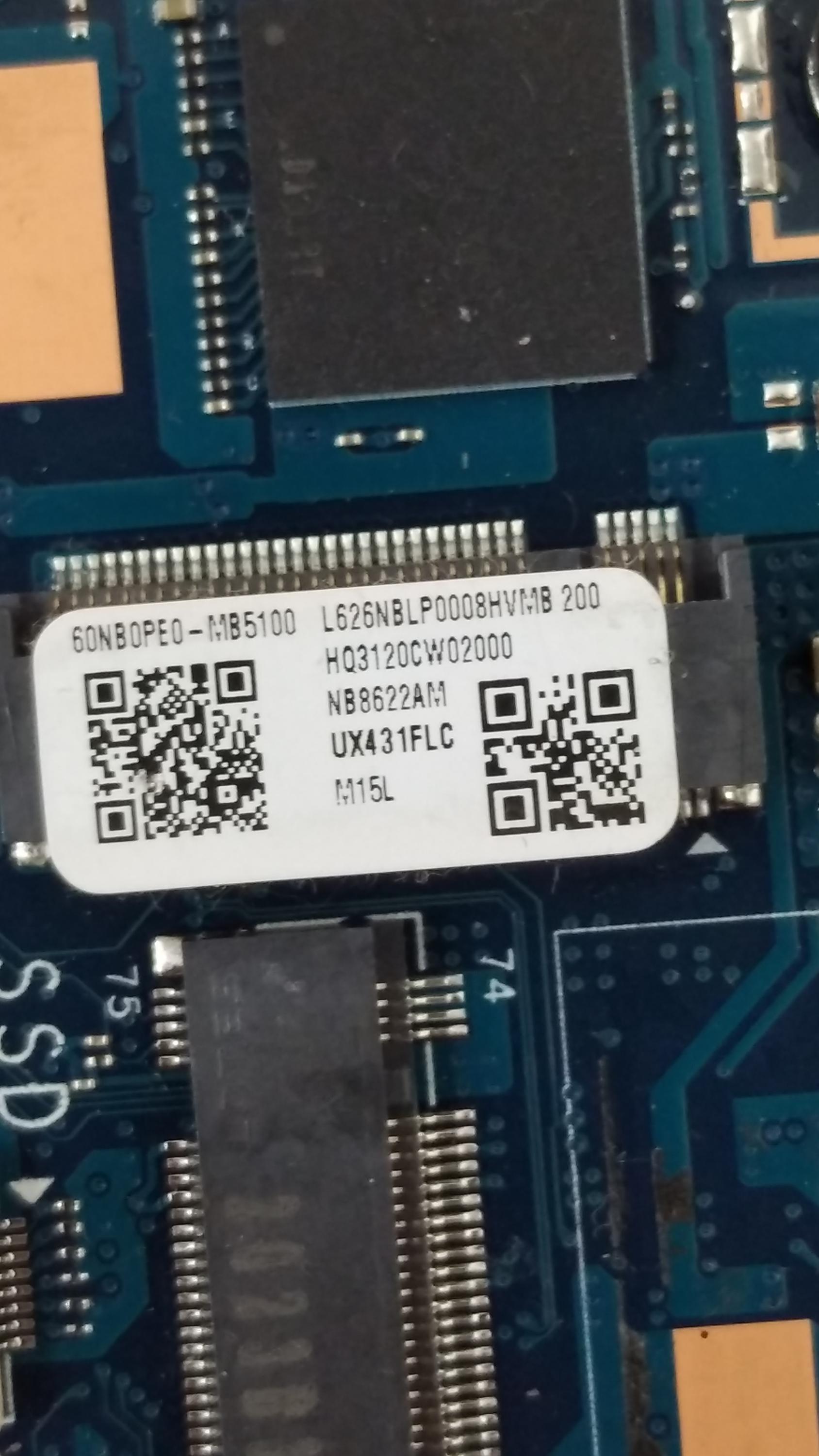

          Post pictures of all long white/green barcode stickers, or square white QR codes on the motherboard

            Re: ASUS UX431FAC/FLC REV 2.0 Bios need
            Again, thank you both for your help.
            I haven't tried the file provided by ddhlawi yet
            Attached photo with motherboard sticker

                            Read posts 5,6 and 12.If you have UX431FLC on your white QR sticker flash the bios at post 7 but make a backup first.
