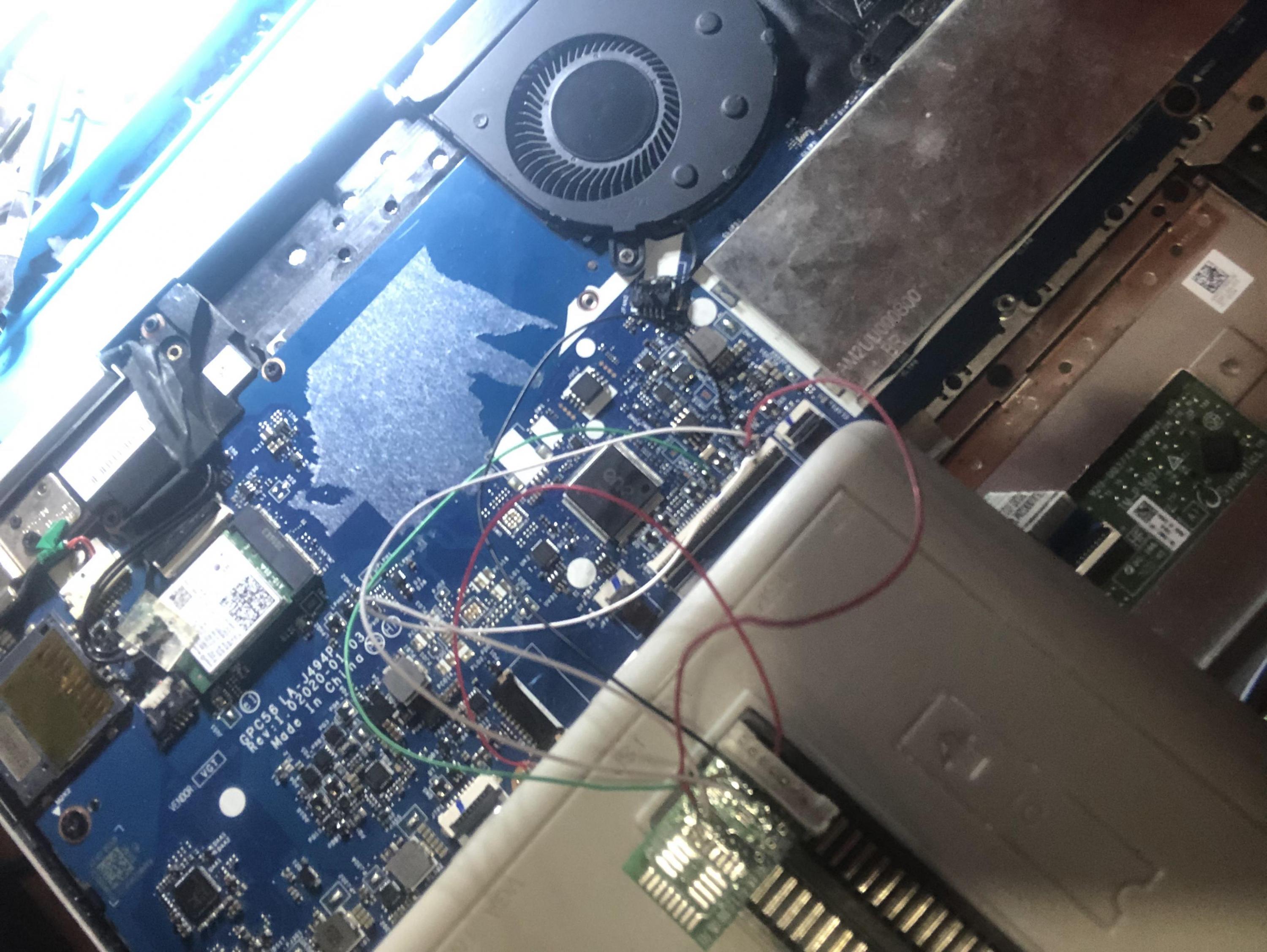

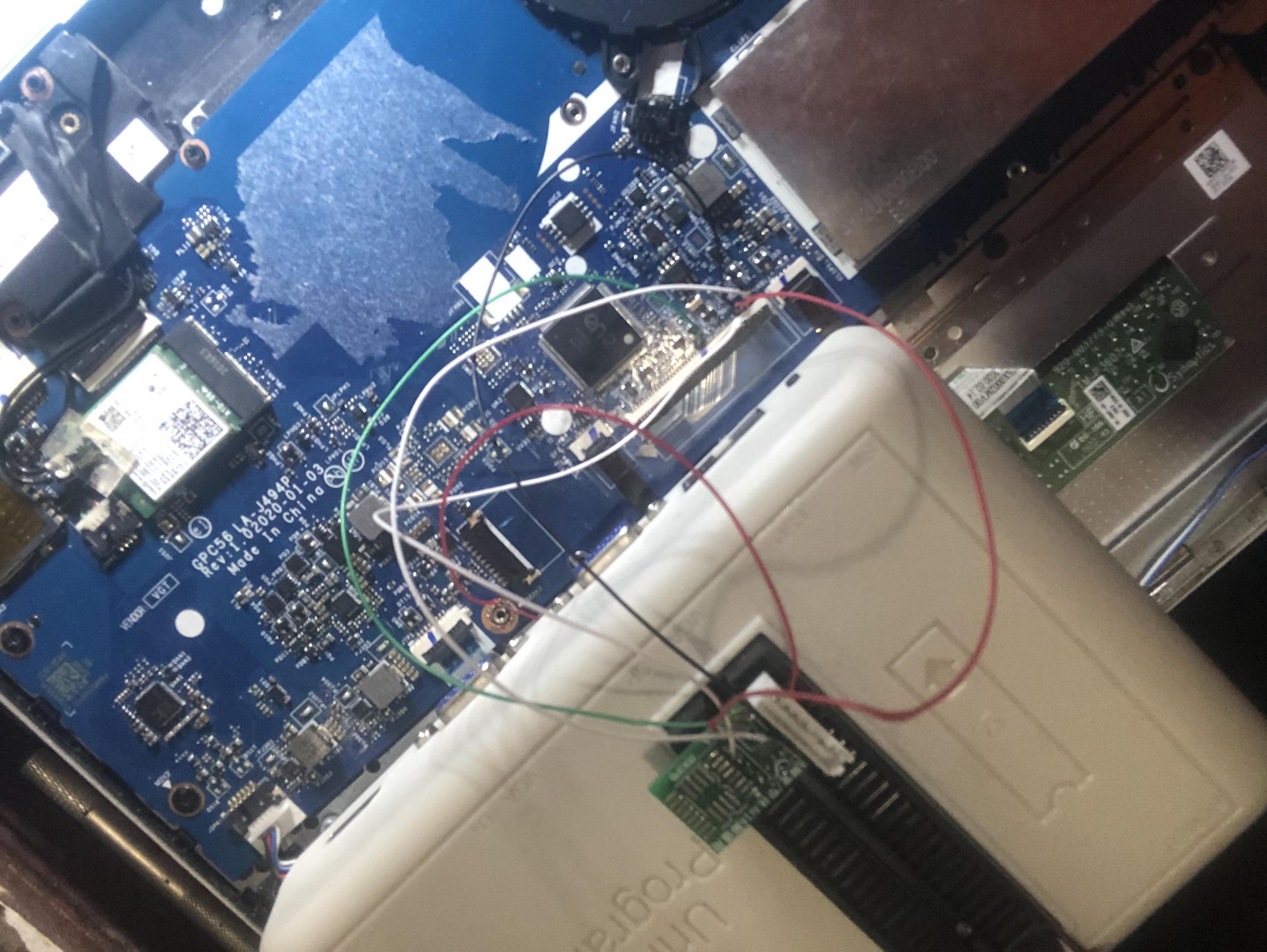

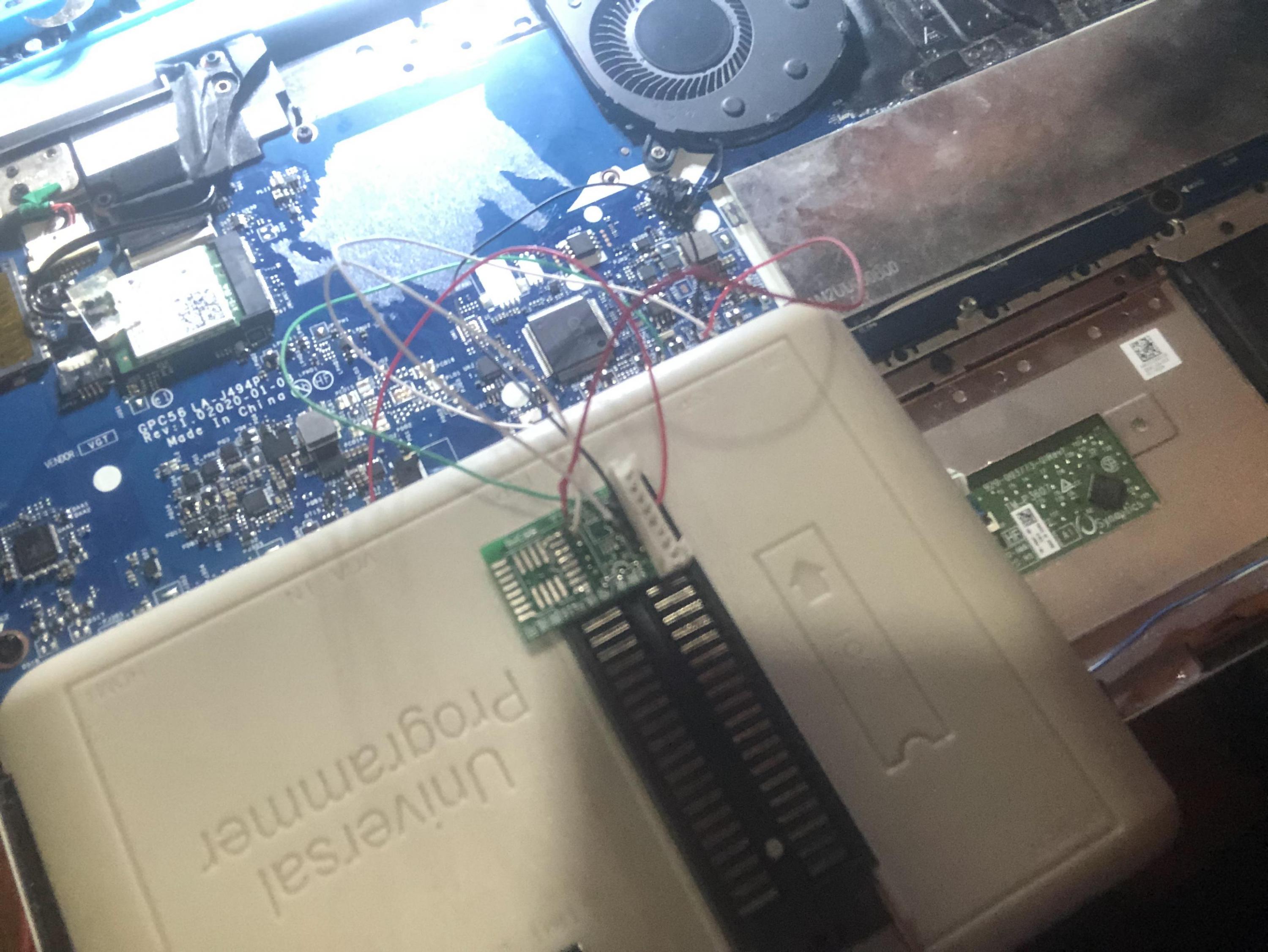

    Hi, please how do i flash ec for ene kb9542q e ? I found kb9542q b and as in attachment, i fled;
    ksi4(pin 59) - jkb pin 36 - fled to pin 1
    ksi5(pin 60) - jkb pin 35 - fled to pin 6
    ksi6(pin 61) - jkb pin 38 - fled to pin 5
    ksi7(pin 62) - jkb pin 39 - fled to pin 2
    ks03(pin 42) - jkb pin 23 - fled to pin 4
    i supplied 3v externally. I am using rt809h
    laptop model is la-j494p rev 1.0, maybe i am missing something.
    Thank you
