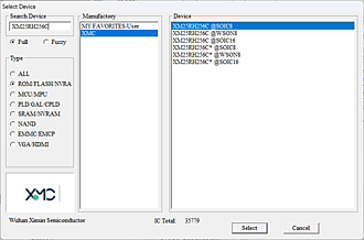

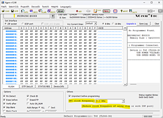

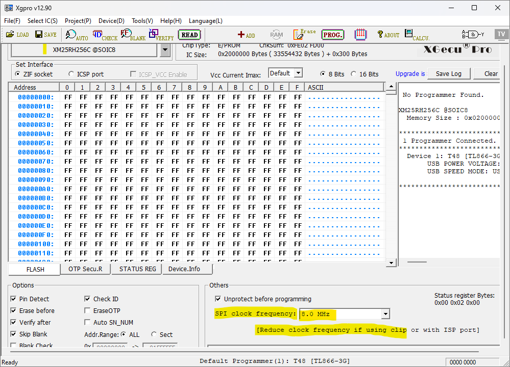

            On the Xgpro software lower the SPI clock frequency to 8MHz when using the clip/pogo pin, make sure you're holding the pogo pin adapter steadily, or maybe get someone to help either holding the pogo pin adapter in place, or clicking Read in the software, you have to hold steady for around 3 minutes, maybe more while reading/writing due to slower clock frequency
            Click image for larger version  Name:	xgpro1.png Views:	0 Size:	63.6 KB ID:	3704596

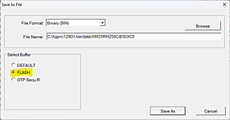

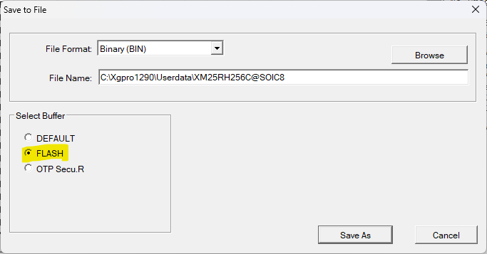

            When saving the file, make sure to select FLASH on the "Select buffer" option, like this, otherwise the dump will have additional bytes at the end, should be exactly 33554432 bytes
            Click image for larger version  Name:	xgpro2.png Views:	0 Size:	15.1 KB ID:	3704597

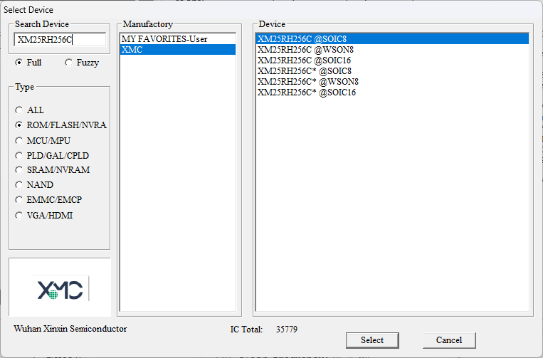

            Also try reading selecting XM25RH256C* @WSON8 (with asterisk) variant, don't know what the difference is, make at least 3 dumps each time, and compare them with hex editor, should be identical
            Click image for larger version  Name:	xgpro3.png Views:	0 Size:	34.5 KB ID:	3704598

              I have already tried with lower clock speed. Tryed XM25RH256C now, too... everything without results. I also have to uncheck the "Check ID"-Checkbox, even if I ve chosen W25Q256FV. When I do the flash-detect, there are around 10 Chips to select and the ID is shown (EF 40 90). But when I try to read it, it says
              Check-ID Error
              Checked ID is 0 x 00 00 00
              I dont think anymore the issiue is a contact-problem, as Xgpro passes the pin detection.
                • 21552
                Check-ID Error
                Don`t use flash-detect ,choose it yourself
