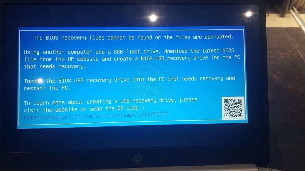

HP 14-dq****** da0pahmb8f0 bios needed
  • bestdan50
    • Aug 2015
    • 170
    • nigeria
    14-dq2055wm da0pahmb8f0 bios needed
    • 21911
    Re: 14-dq2055wm da0pahmb8f0 bios needed
    If you download and run the bios update executable from HP support you should have a virgin bios.If you have a backup you can copy your serial number etc (DMI) to the virgin bios using a hex editor,it should take less than 5 minutes to do everything.

                        • m1ch43lzm
                          • Mar 2019
                          • 929
                          • Peru
                          Originally posted by citylaptop
                          laptop model - hp 14-dq2055wm
                          s/n-5cd120msns
                          board p/n-da0pahmb8f0 rev f
                          plz provide me the working bios
                          Try, bios extracted from HP website with serial/win key inserted
                          HP Laptop 14-dq2055wm (39K15UA)
                          S/N 5CD120MSNS
                          Bios ver F.33
                          BID 87FD
                          DMI 801000-8020FF
                          Win + MPMLock 886000-88700F
                          • m1ch43lzm
                            • Mar 2019
                            • 929
                            • Peru
                            Originally posted by jamoh
                            Hello everyone
                            Please assist in cleaning the attached files for HP 14s-dq5005nia
                            proID 6G5F3EA#BH5
                            SN: 5CD34368LX
                            moboA0PANMB8F0 REV:F
                            Laptop turning on few seconds then turns off
                            Try, extracted from HP website, serial inserted
                            HP Laptop 14s-dq5005nia (6G5F3EA)
                            S/N 5CD34368LX
                            BIOS ver F.25
                            BID 8A20
                            DMI 801000-8020FF
                            • jamoh
                              • Apr 2023
                              • 12
                              • Kenya
                              S/N 5CD34368LX
                              BIOS ver F.25
                              BID 8A20
                              DMI 801000-8020FF
                              Thank you sir the laptop is working well
