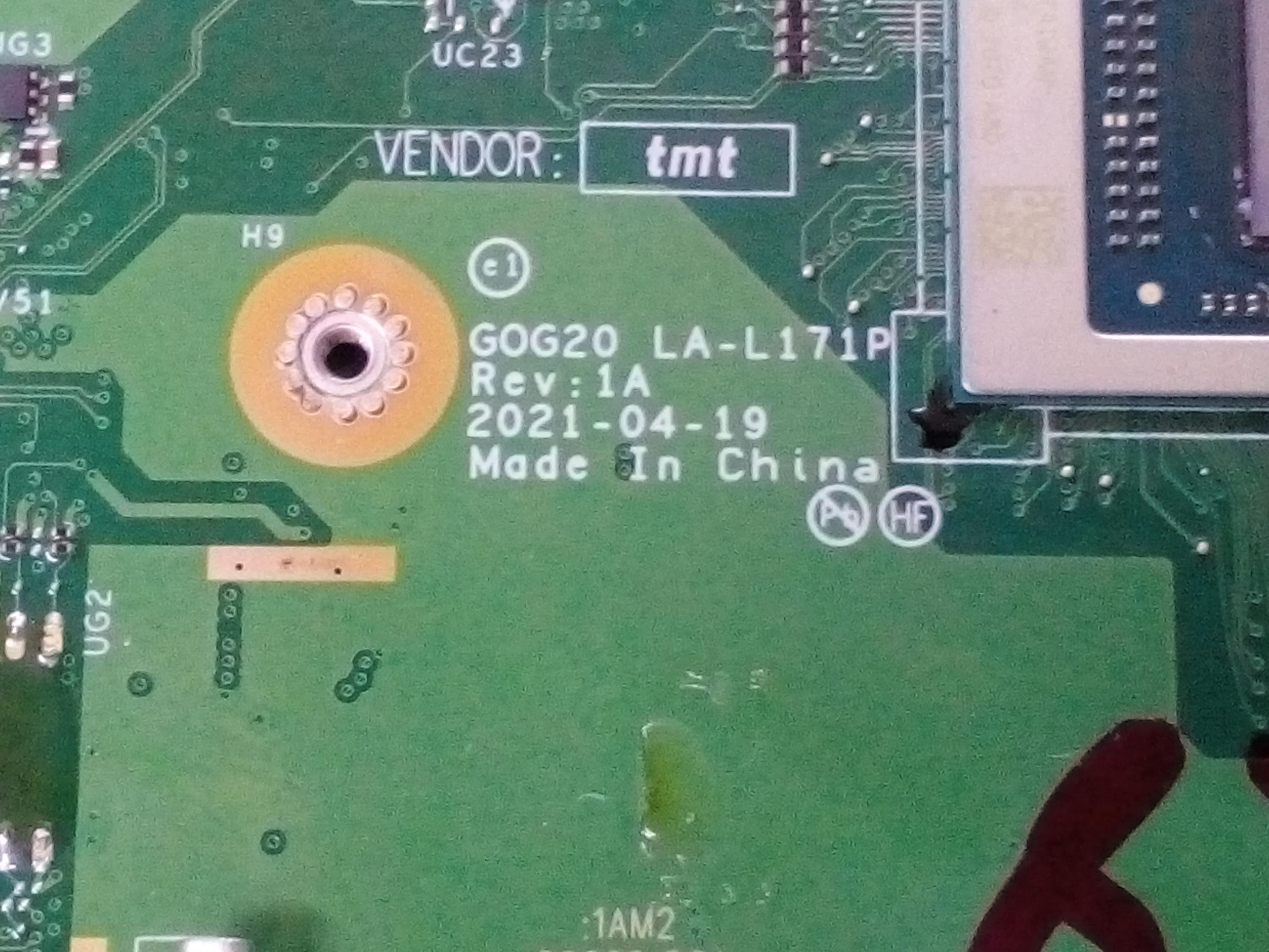

                            Lenovo ideapad gaming 3 15ach6
                            good evening, does any colleague have the bios of LENOVO IDEAPAD GAMING 3 15ACH6 gog20-la-l171p-rev-1a card

                              Re: Lenovo ideapad gaming 3 15ach6
                              Upload your original bios file, write your device serial number and someone will help you.
                                good evening, does any colleague have the bios of lenovo ideapad gaming 3 15ach6 gog20 la-l171p rev:1a card
                                s/n:mp24fad9

                                    Re: Lenovo Ideadpad gaming 3 15ACH6
                                    good night hardware 1 compare the information of the bios and they are completely different from the one that originally comes with the equipment and I already programmed them and with none it gives me a video will you have a way to compare the one that I uploaded or will you have another one in advance thanks for helping
