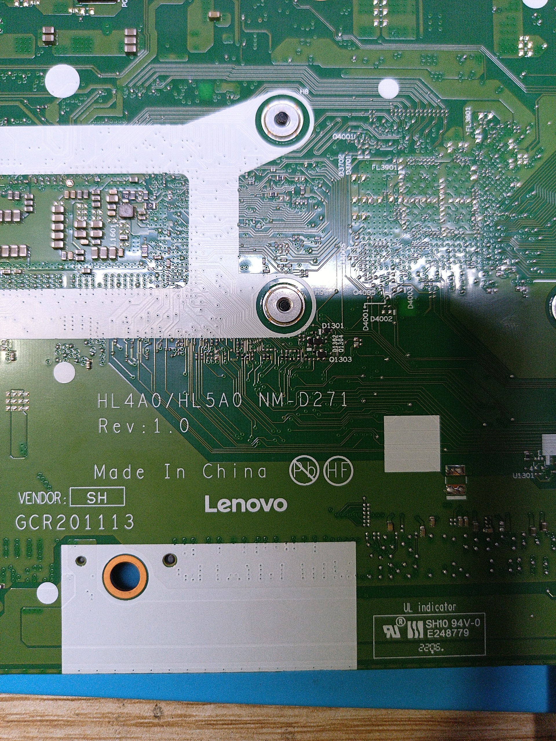

    Thinkpad L14 gen2 Intel i5-1145G7, The chematic silkscreen is "GL4A0, GL5A0, NM-C632"; One day I try to change the bios feature "Intel TXT" to enabled and save & reboot.
    Bad things happened! It does not boot up and show beep code:"0002:internal bus error". I tried to unsolder the bios to refresh the firmware, but unkonw how extract the image block from the *.FL1/*.FL2 files.
    Does someone give some tips? Or just give the back BIOS archive should help me a lot.

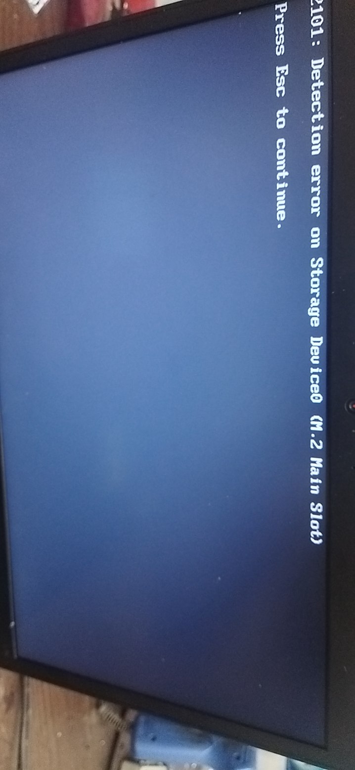

            thanks for your upload. laptop is alive but ? cannot detek ssd, i try used m2 and nvme

              Re: Thinkpad L14 gen2 Intel BIOS needed!
              original bios by attacthments
                Here's your New BIOS, try it and let me know.
                  thanks . its work.

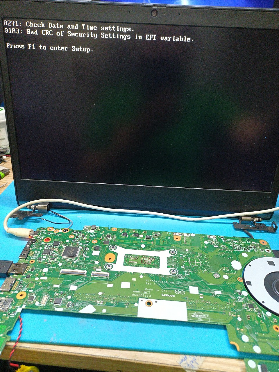

                      Anyone help me please ! bios no display
                        Is this your Serial Number "PF3Q03N5"?
                        This device must contain another BIOS chip (16MB), you should upload its file too.
                        Don't forget to write the device full model number and motherboard number.

                              Look for "U2104" on the motherboard, it's a 16MB chip with WSON 6x5 package.
                              all donations are welcome,
                                Thank you so much ! Here is it.
                                    Here is your New BIOS, try it and let me know.
                                      It's work. Thank you very much !
