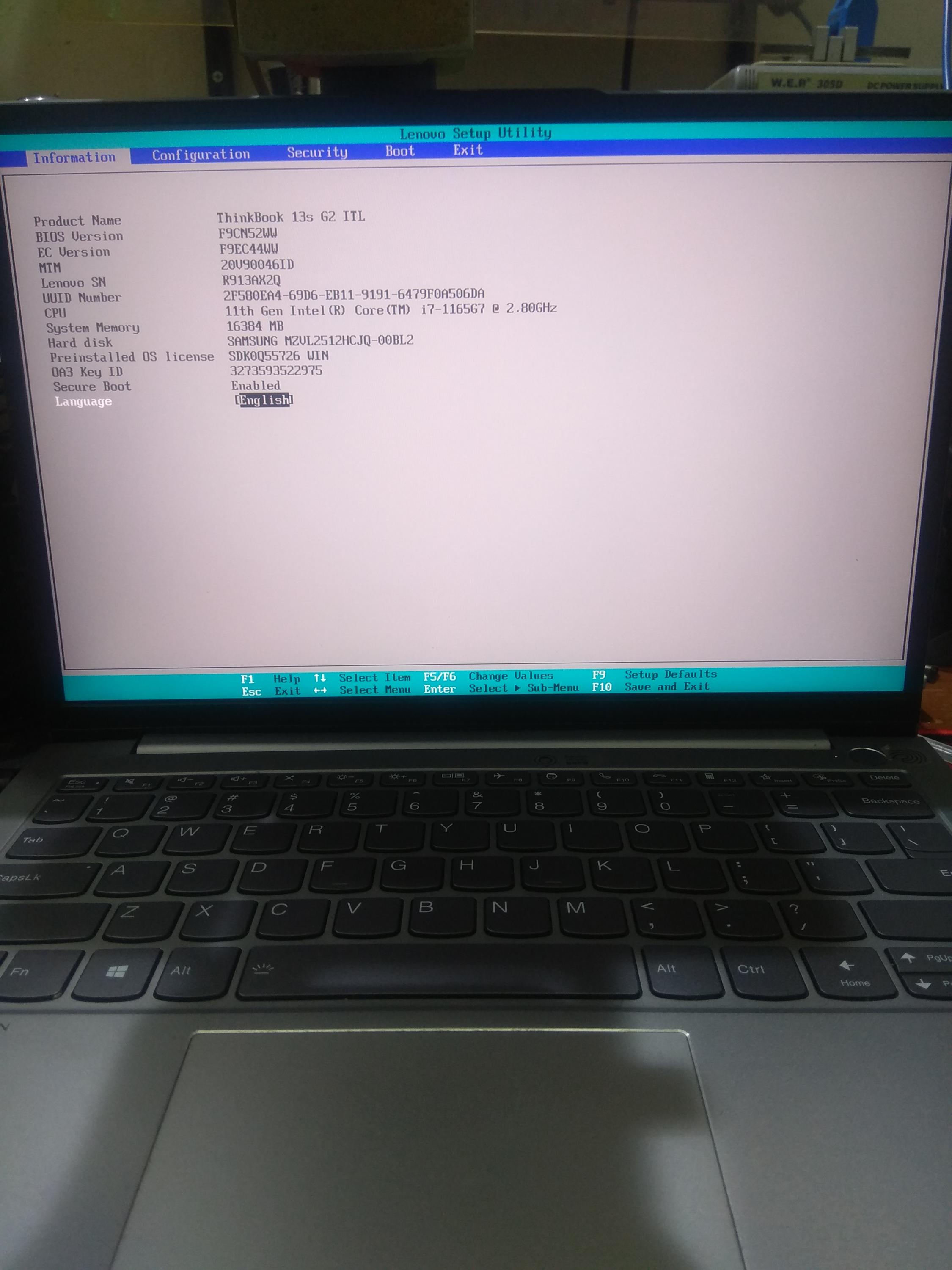

                              hi everyone i have problem with my corrupted bios, i have tried bios from this forum and they not working either no respond to power on or lcd blank screen (lcd backlight is on tho), and i have tried flash from working laptop and result is ssd is not detected, i try ssd to another working laptop and it working no problem. so im attach my corrupted bios, please rebuild my bios. thanks.

                                Re: ThinkBook 13s G2 ITL Bios
                                Here's your new bios file, hope it works fine.
                                  Thank you it works, i'lll attach picture. If you dont mind, can you tell me how to do rebuild bios ? once again thank you.
                                    You're Welcome. First you got to lenovo website and download the bios image using your serial number. After that you should extract the FD file from the exe file using innoExtractor. Then you cut the bios region from the downloaded file, and replace it with your dump bios region using UEFitool or any hex editor. Next you should move your DMI from the dump file to the new one, then clean ME Region using a proper versions.
