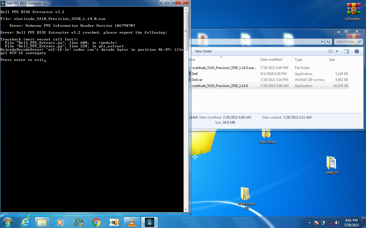

                      • Adebeebs
                        • Feb 2018
                        • 7
                        • Nigeria
                        Re: Help with Dell PFS extractor
                        this is what i am getting?
                        my first time using it
                        • lapfix
                          • Mar 2020
                          • 2701
                          • my workshop
                          YOU FIND THE EXTRACTED FILE AT THE SAME FOLDER OF Dell PFS extractor
                          Or if you want make a folder , put the dell exe and Dell PFS extractor in , than drag and drop the exe at Dell PFS extractor exe you will get the extracted files
