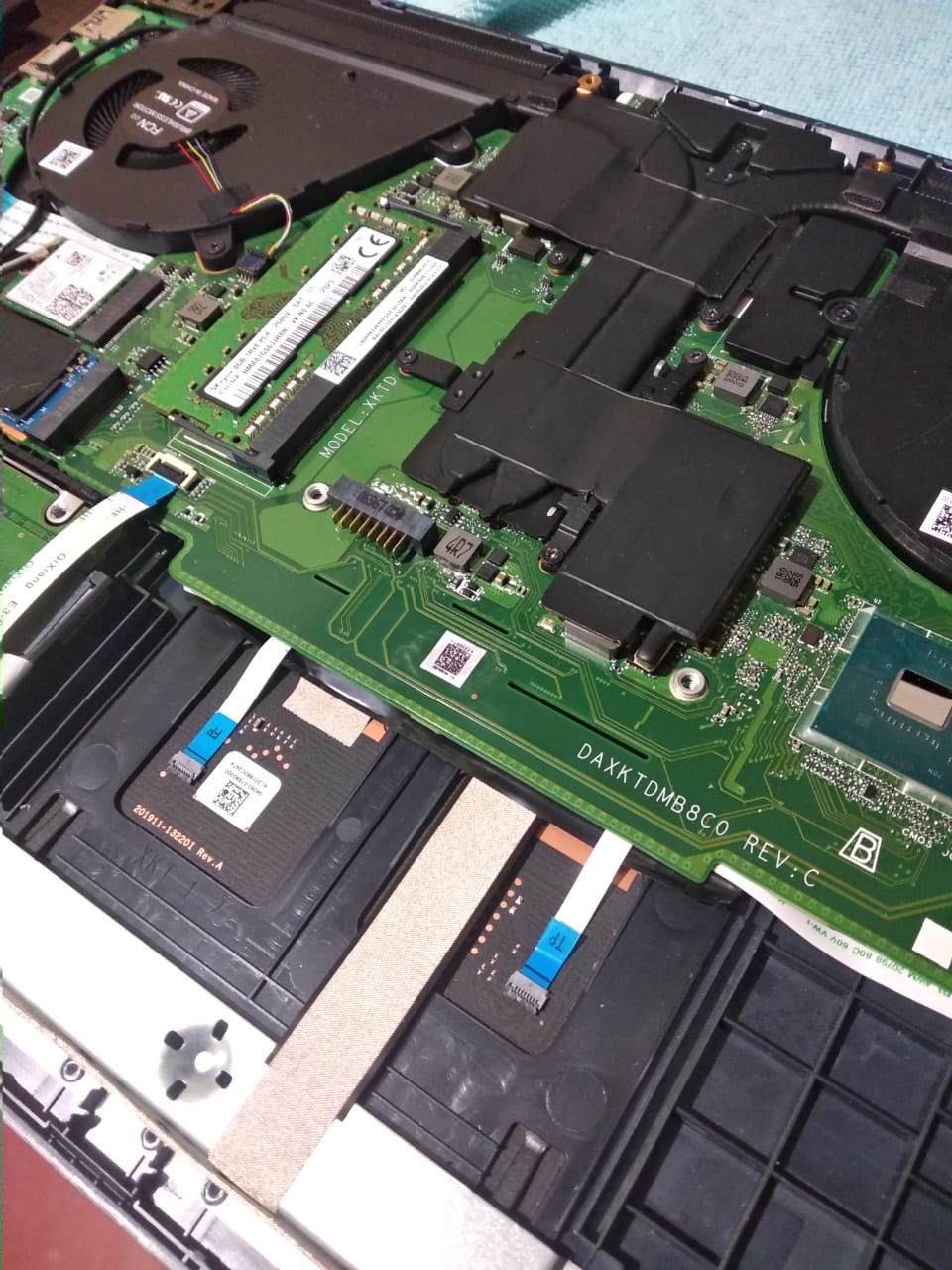

    Hi
    Dear I need help with a bios for the ASUS X571LH DAXKTDMB8C0 REV C - XKTD.
    I thank you very much. Cheers

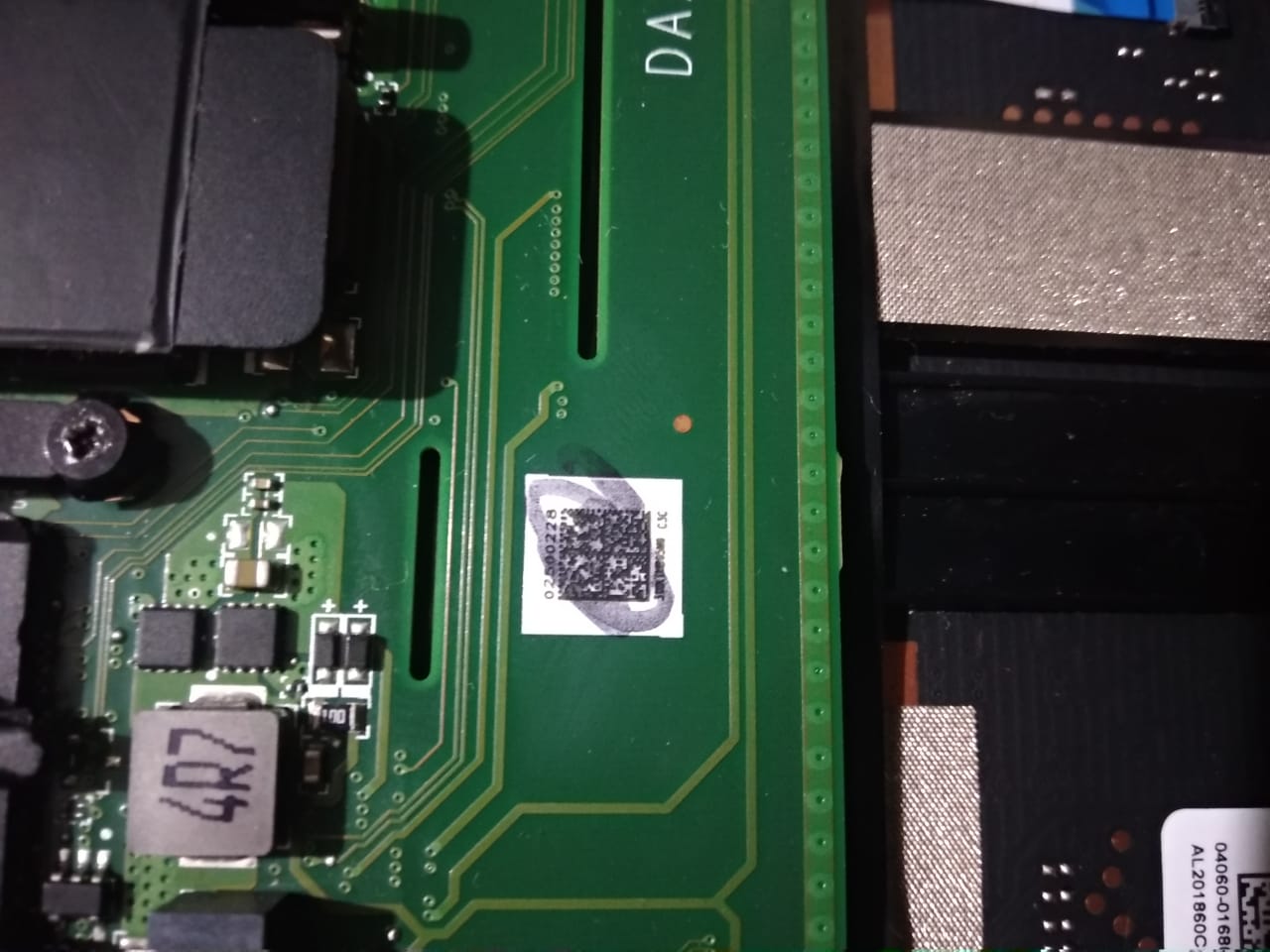

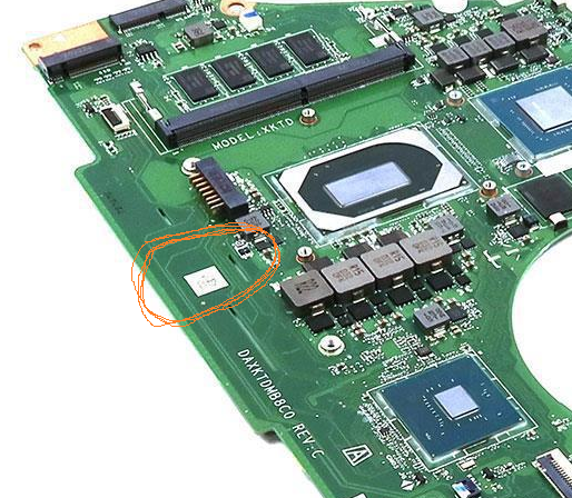

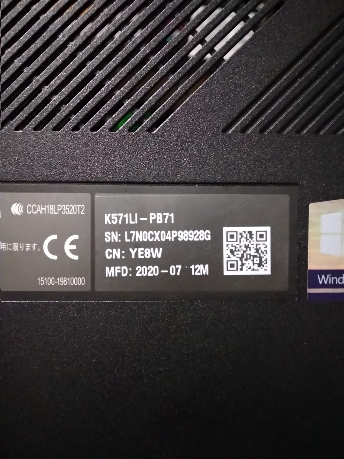

      Can you post a picture of the small white QR code on the motherboard

          Take a close-up photo, so that the characters on the QR code can be clearly seen.

            Re: Asus x571lh daxktdmb8c0 rev c - xktd

                QR code is required to identify the exact device model but the picture you posted is not what we are looking for.

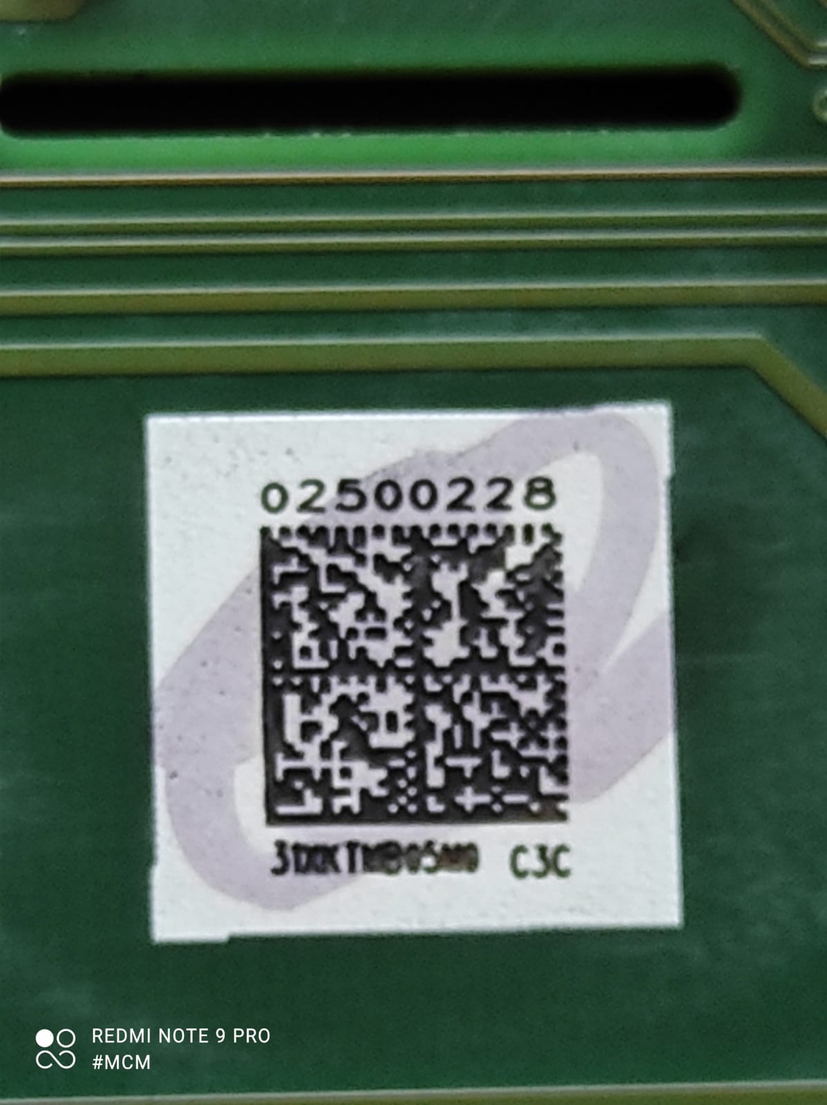

                  Originally posted by djcristian28
                  The QR code is: QCCXKT5MC02500228,L625NBCX007KPCMB,X571LI,60NB0QI0-MB2400,200,244BFE868314
                  It is the same image that they requested of my motherboard

                      Sn? what do you mean friend?

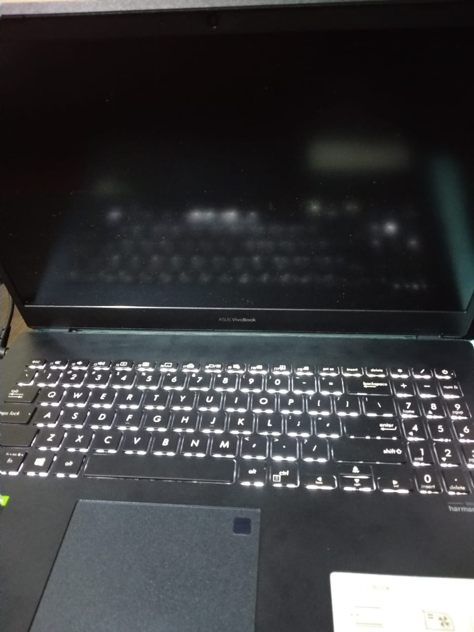

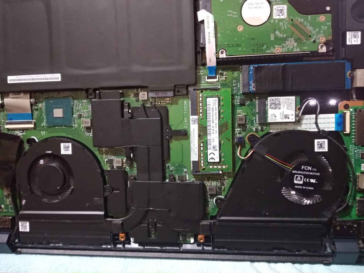

                      It didn't work my friend 😞 only the keyboard lights turn on and nothing else and the fans don't turn, what do you think is happening? thanks for your answer

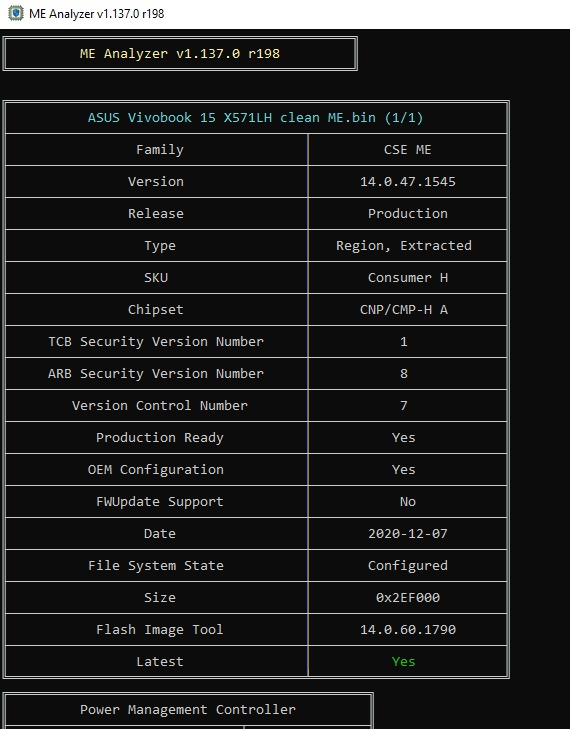

                          Try with clean ME file

                            Thanks for the file but it didn't work, why is that?
                            In the QR image of the SN that I sent, the model is x571LI and not x571LH, is that why? I placed LH from the beginning because I only found information with the same motherboard number "daxktdmb8c0 rev c - xktd" I appreciate your support in advance. I need the laptop to be able to work
                            PD. As you can see in the images, it only turns on the keyboard lights and the battery charge light.

                              Upload ur laptop original bios
                              the file that u have uploaded in post #2 is not matching with ur laptop serial number
