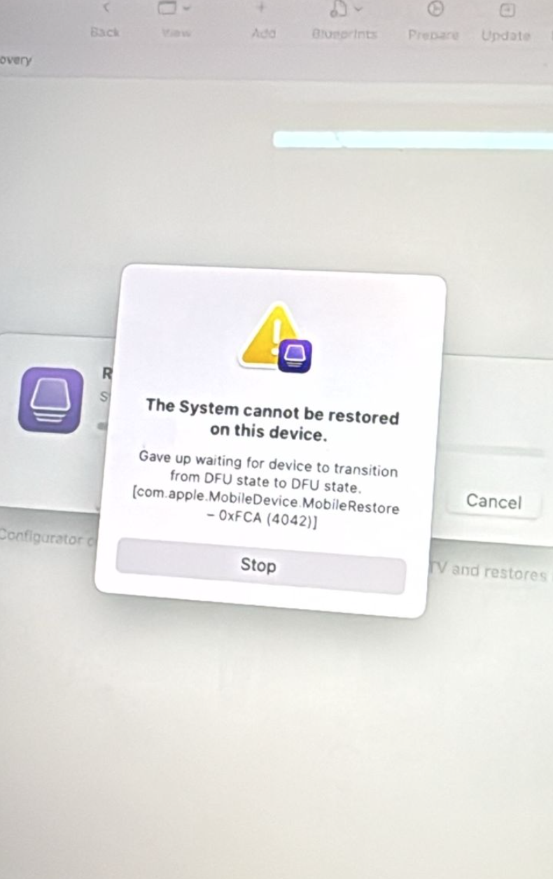

              Dear friends,
              I have a question to ask.
              I received a MacBook with a no-power issue and fixed the no-power problem.
              But then I found out the SSD was short-circuited as well.
              It was a 512GB SSD consisting of 4 NANDs from the 0 batch.
              I transferred all 4 NANDs from a working MacBook Pro board, but it ended up with a failure message: 0xFCA4042.
              Later, I tried using the JC Programmer tool to flash all 4 NANDs and solder, but the error code remained the same.
              My friend mentioned that after replacing the SSD, we also have to flash the ROM file for the T2. Is that true? If yes, if I paste it here, can anyone help to clean the file?

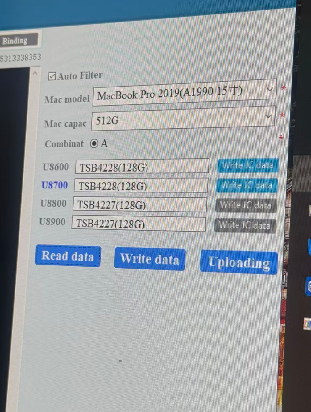

              • alfredodinolfo
                MacBook Pro 2019 (A1990)
                by alfredodinolfo
                mb code:820-01827-A;
                sn:C02Z349ALVDR;
                i9 32GB Ram 1TB
                Hi, I found short on one of 6 black nand (total 1TB).
                i removed all 6 nand ( voltages all ok) and now i want to program with JC P15 but for A1990 2019 there is only 512GB configuration.
                I try A2141 1TB configurazion with TSB4228 but the position on pcb is different ( U9300 and U9400 is no stuff on A1990 but present on A2141 and U8800 and U8900 is no stuff on A2141 but present on A1990 )
                macbook with A2141 configuration run on recovery but don't complete it.​
                anyone can help me?
