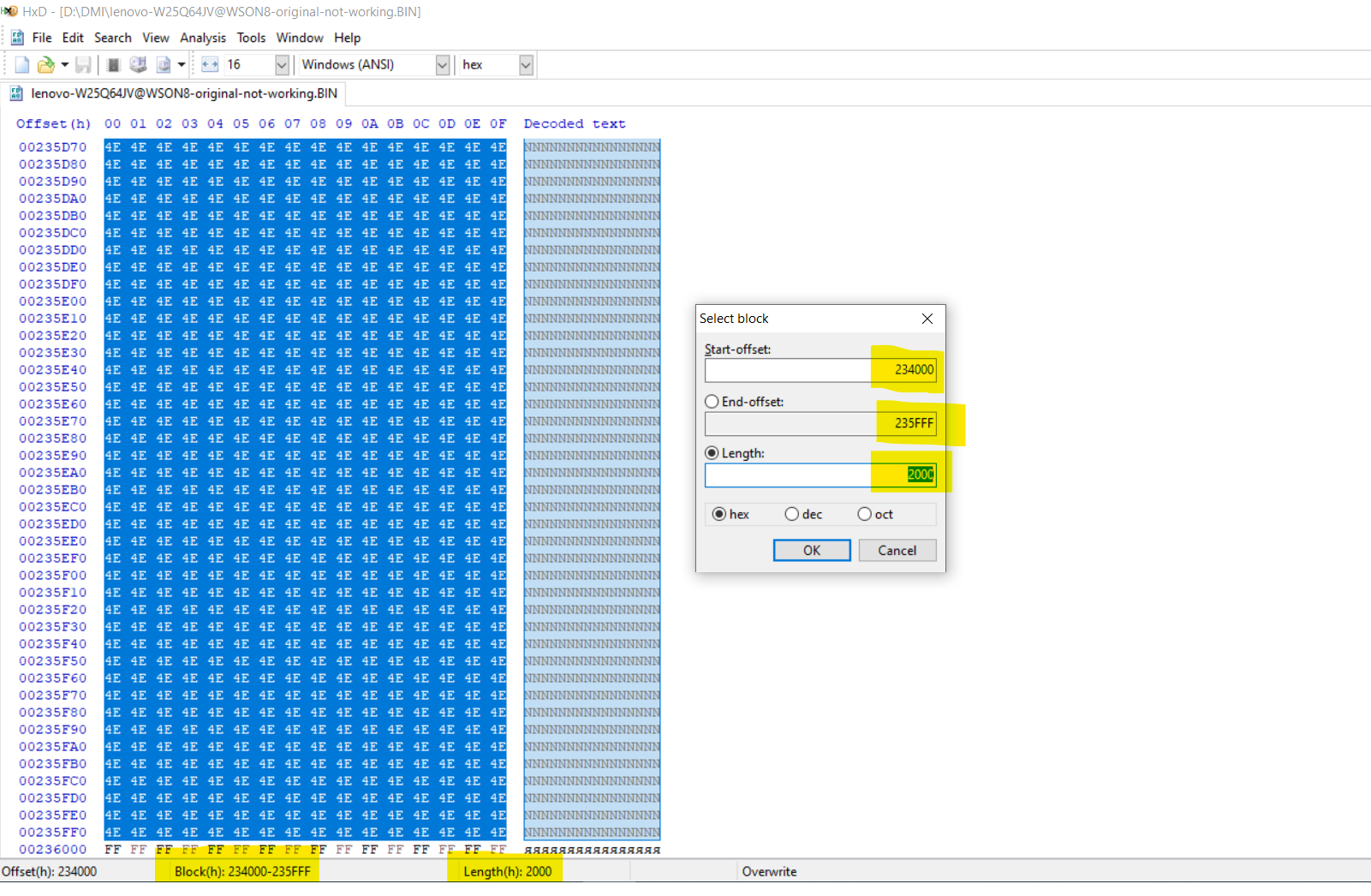

      bios extracted from the Lenovo site update
      DMI 234000 - 235FFF

          Re: Lenovo V15-IKB bios DUMP ( gs44b gs54b C561) request
          DMI 234000 - 235FFF
          OMG.. works! you are a genius (again) you saved me a lot of times!!!
          no idea on how works DMI... i need to study a bit
            use the HxD program ... enter in it the bios from [item # 1 and 3 ... check the interval posted in both bios and after .. copy paste ... that's all ..
                DMI 234000 - 235FFF
                OK, but from where these addresses comeout? with uefitool there is nothing related to DMI that can spot the exacly section to overwrite...
                  I wrote you to use the HxD program ... Vesko356 took a picture of what you have to do with this program ... and you !!! ... use another program and wonder why it doesn't work .. ..

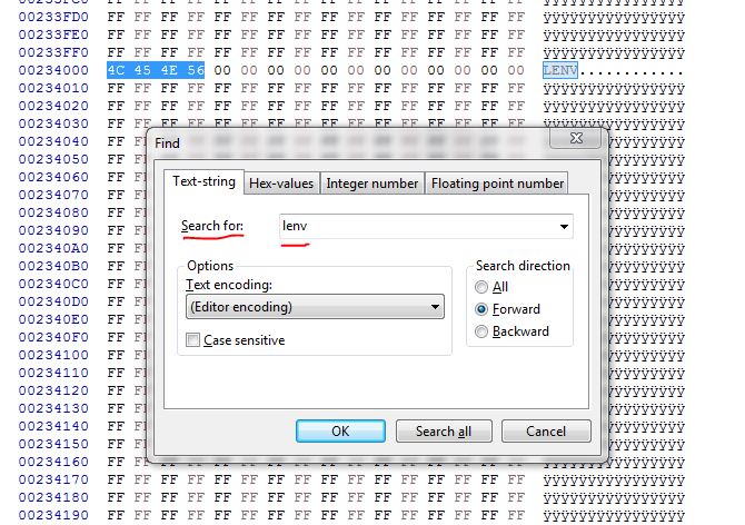

                      • 22155
                      Hi Peste, i have HxD (and the laptop is working without any issue now) ...i want just to understand from where these adresses ( 234000 and 235FFF ) come from... where did you find these locations? using a tool? a scheme? looking at original bios? looking at dumped bios? (it's a some sort of Lenovo eeproms standard?) Dmidecode ?
                      sorry, maybe boring you and others with stupid questions but if possibile i want to learn
                      Search for the word LENV .You can also compare a virgin bios with a dumped bios
                          Sorry borgin you .. "a virgin bios" do you mean the one extracted from Lenovo ufficial installer?
                          because they are different in size (the dumped one is smaller) and the LENV is placed at another address (362a10)
                            • 22155
                            The official installer needs extracting and the virgin bios has to be copied from it, for example - https://www.badcaps.net/forum/showthread.php?t=98038
