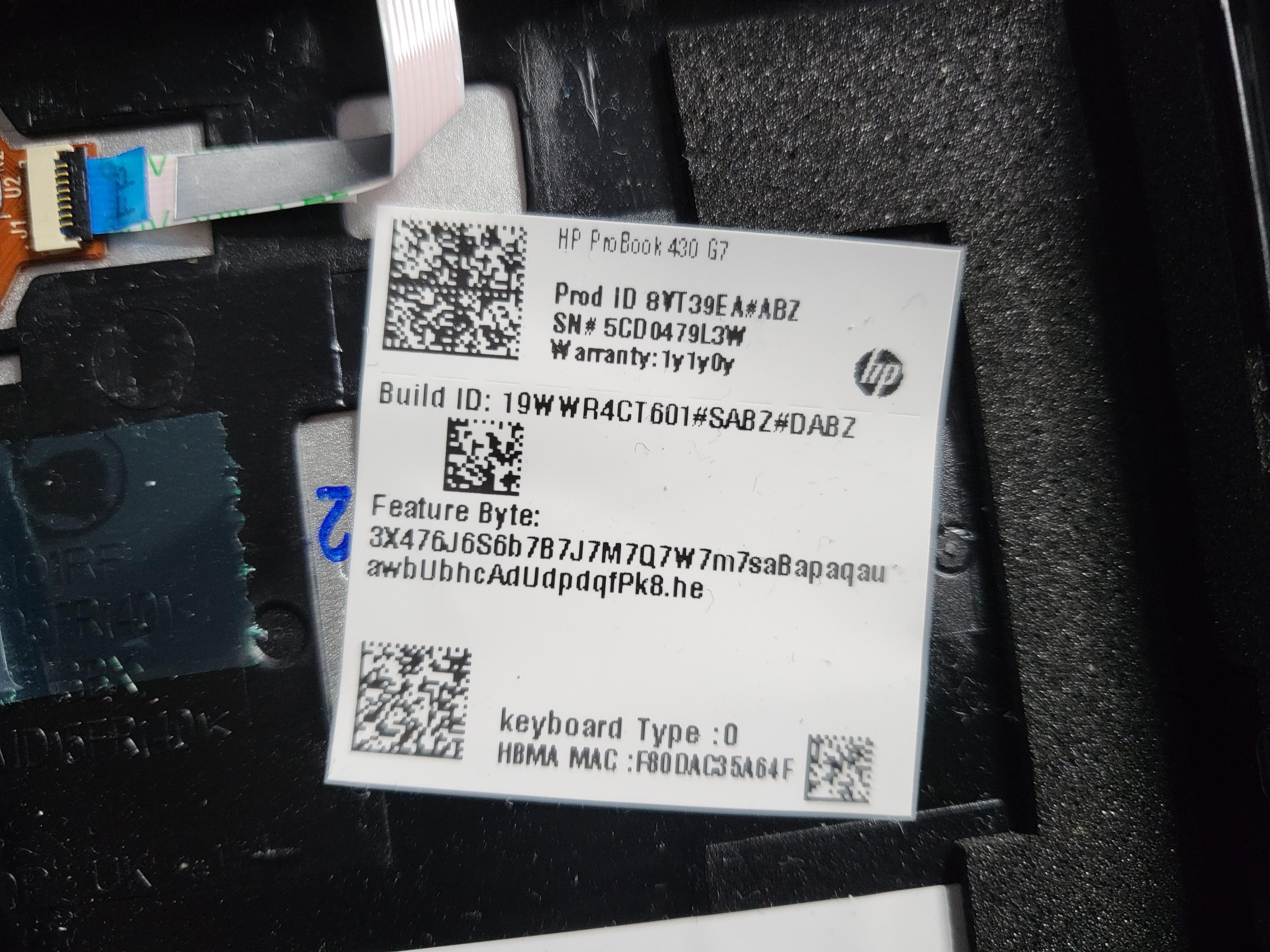

                                    hello everybody i need password unlock for my hp THANK YOU
                                    HP ProBook 430 G7
                                    ProdID 8V739EA#ABZ
                                    S/N 5CD1129XD6
                                    Mainboard model DA0X8LMB8D0 REV D
                                    MODEL X8L
