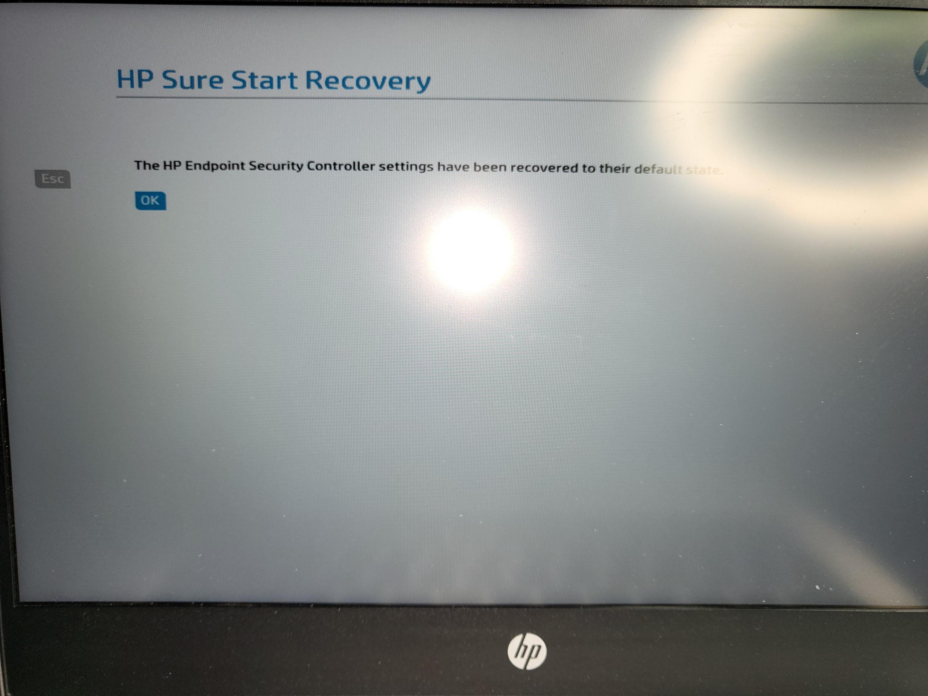

                    Re: Help hp probook 430 g7 bios pw
                    Would someone be kind enough to take a look at these? I can remove the password, but I am then stuck with the "Endpoint Controller" error. I've reset the security settings, and reflashed many times, but I just cant shake it.
                    Cheers!
                        Cheers!
                        Try
                        • Dazzer
                          • Oct 2021
                          • 6
                          Originally posted by hoaca388
                          Try
                          It works!! Thanks.
                          It wasn't painless for me as it went into Manufacturers Programing Mode, which took me a while to figure out as I had not seen this before, but thats just my lack of experience.
                          One question if I may. As all the machine specific information is gone, can that file be used on an identical laptop with the same BIOS revision?
                          Thanks again!

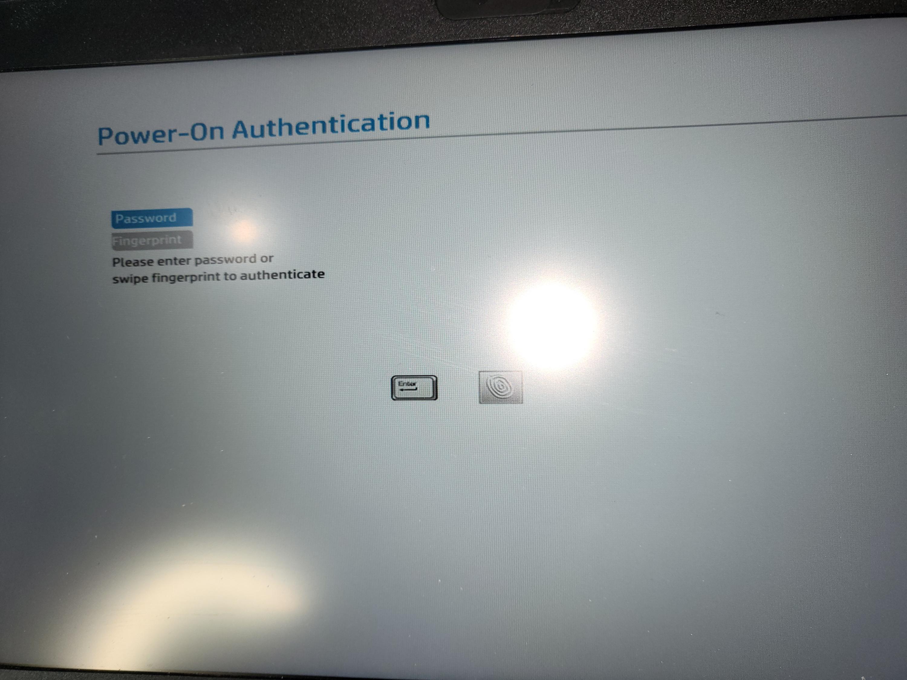

                                  • shaggy90
                                    • Oct 2022
                                    • 6
                                    • Italia
                                    Password not remove thanks
                                      This is not a password, you must clearly describe the device state, post the main bios file. Or in the first boot you have to go into bios setting for dissable all the security options .
                                        This is password
