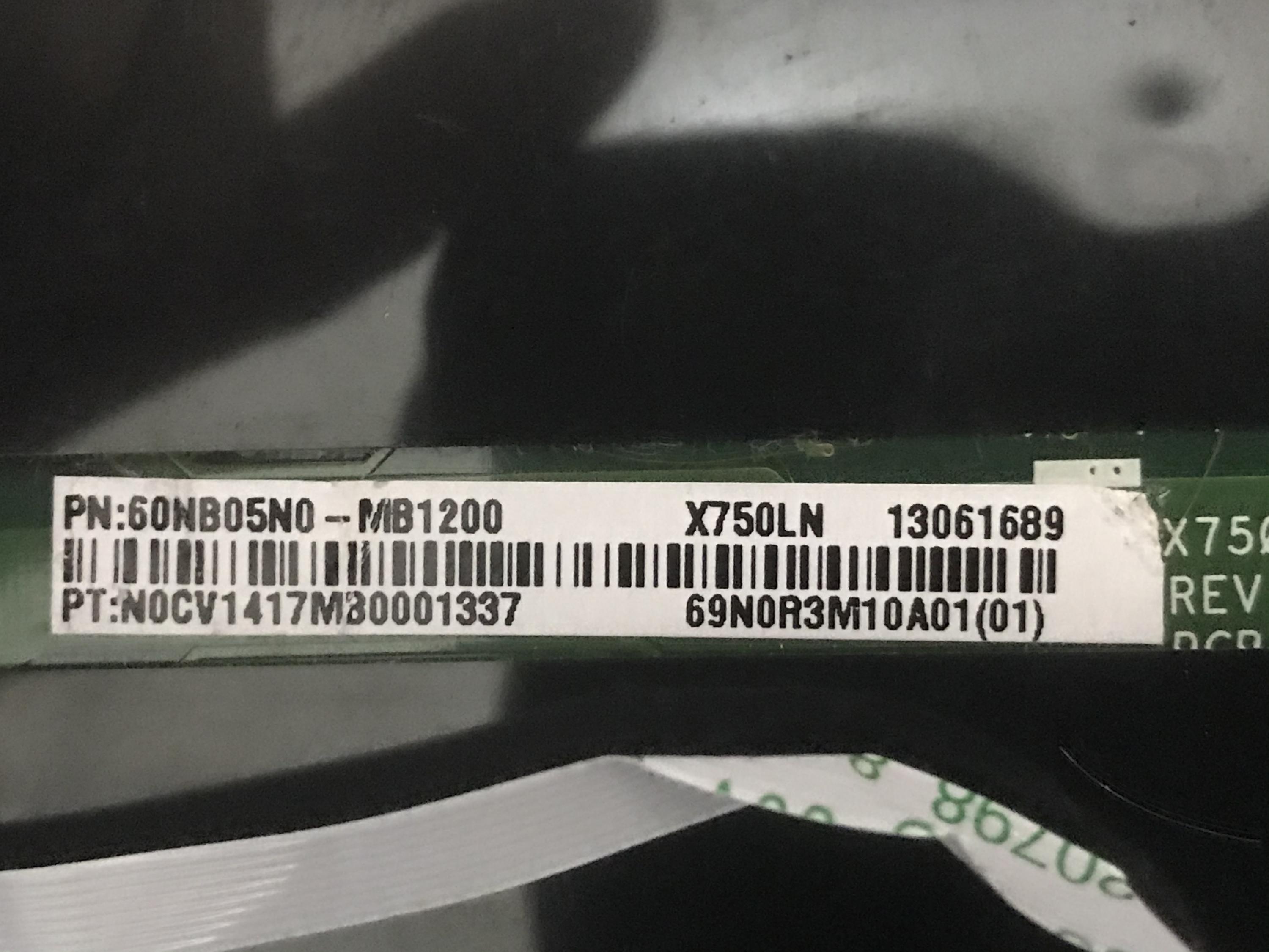

    Hello Every one Please i need bios bin file for ASUS K750L
    MotherBoard : X750LN MAINBOARD REV:2.0

      thank you, it's not working. now it turns on but no display, and when i try to turn it off its turns on imediately automatically

        Post pictures of any barcode stickers,like the ones in this thread https://www.badcaps.net/forum/showthread.php?t=96604 ,or if there isn`t a barcode sticker look for a square QR code

          this is the sticker
