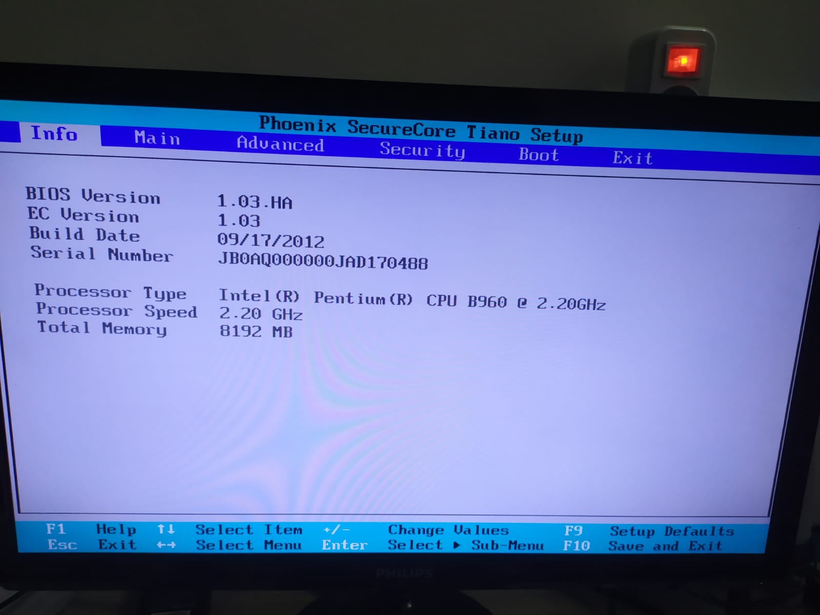

    Hello everyone can somebody unlock this bios for me?
    My problem is secure boot or uefi boot or something like that. With orginal bios no display. with this dump on link " https://www.badcaps.net/forum/showthread.php?t=36730 " i can't boot anything and i can't select the options because it's not listed on the menus.
    I upload boot bios maybe you can fix orjinal one or unlock the dump one(MB45iiv4 file)

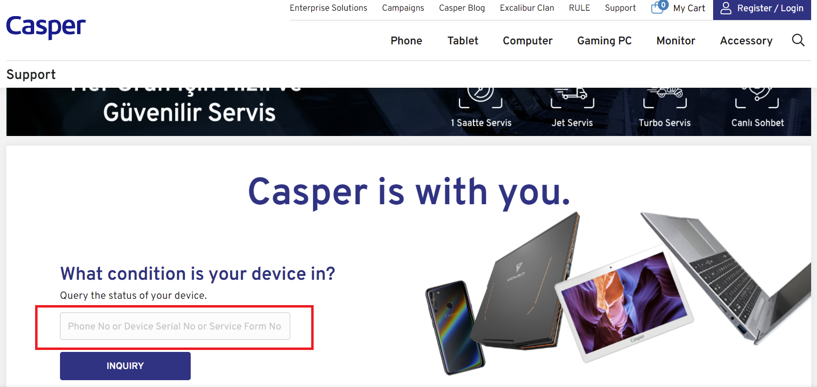

        I just want some parameters to be able to download the correct bios from the Casper homepage

          Sorry but it's bad company about support so there is no bios file on site

            Thanks for try but it didn't work for me. no video signal...
            Mb45ii4 bios file is working for me and maybe someone can unlock its hidden settings.

              Re: Casper MB55IN1-3 bios unlock
              Reflash the working one.
              there is a few options. I need more options to fix secure boot or uefi problem.

                    I requested via email and the company send me this file. can u help me with this one? i try to flash it but didn't work for me.
                    my pc working with that bios but the keybord isn't working well and it's not driver issue so i have to flash orginal bios.

                        Thanks for try but cpu gets hot light coming on but no picture...

                            Same problem again fan spining, lights on, cpu hot but no image. Mb45ii4 is working for me. The only problem is laptops keyboard. When i press q it's q but when i press win key is + and k it's 2 with fn button k is k etc... can we get only keyboard part from the yedek.bin to mb45ii4 ? i tried uefitool but i couldn't make it

                              Mb45ii4 is working for me. The only problem is laptops keyboard. When i press q it's q but when i press k it's 2 and win key is + etc... can we get only keyboard part from the yedek.bin to mb45ii4 ? i tried uefitool but i couldn't make it
                              I don't know how to do that, but I think it has something to do with EC so I send you the EC changed file.Goodluck.

                                You are just amazing. It's working. Thank you so much

                                  Bios with all hidden menu. In another forum somebody named "Maxinator500" help me. I want to share it for everyone.
