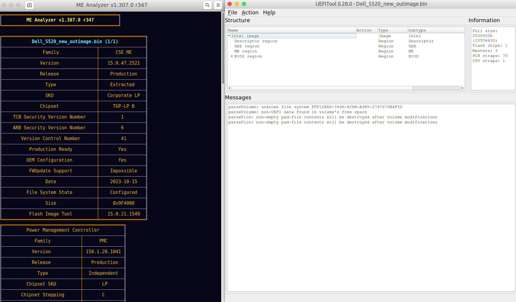

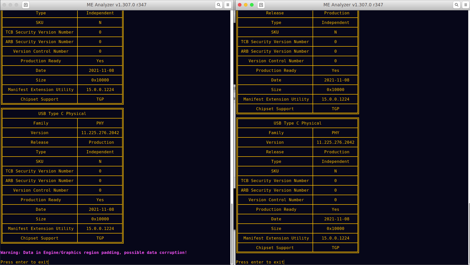

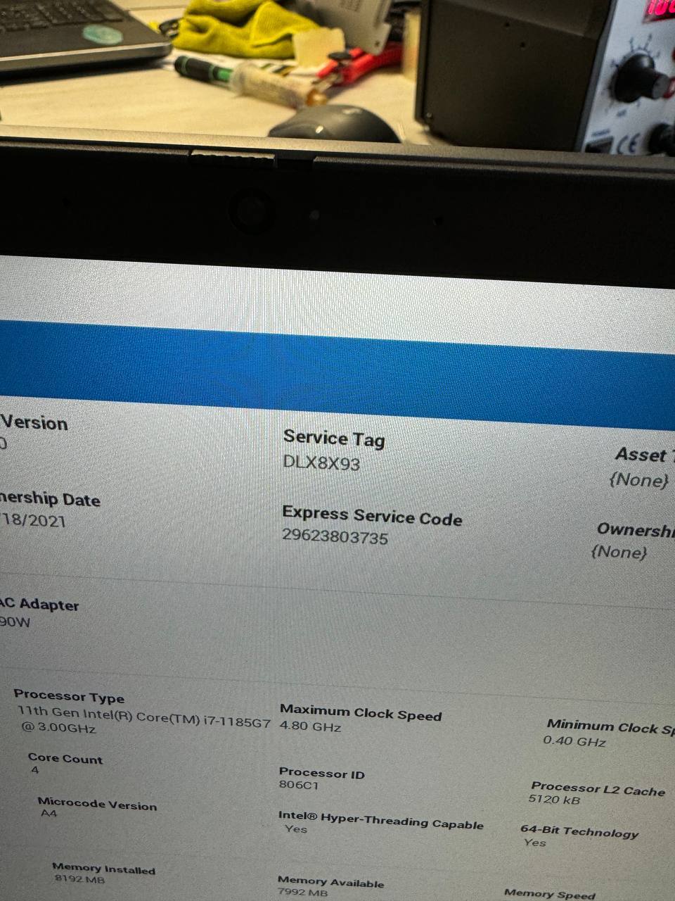

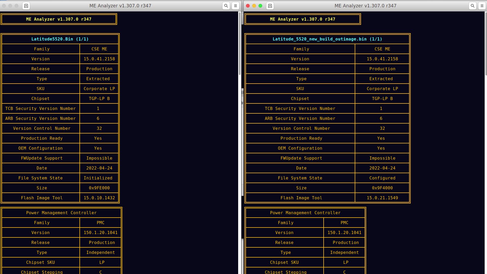

Dell Latitude 5520 Bios Password unlock
  • hoaca388
    Badcaps
    • Jan 2022
    • 11685
    #461
    Originally posted by dejankeke
    I tried but now the laptop won't start
    Here
    • Markus1741
      • Sep 2020
      • 843
      • N/A
      #462
      Originally posted by Blaze Tech
      TRY
      I have to be very surprised because no one noticed that the original BIOS uploaded here is total junk.
      The user should first learn to correctly read out and compare a BIOS file.
      But now he has already overwritten his BIOS, which is very bad because he no longer has a functioning original.
      Everything that was patched is based on its bad original BIOS.
      And now they say it doesn't work, now it can't.​
      • Markus1741
        • Sep 2020
        • 843
        • N/A
        #463
        Blaze Tech and hoaca388 carried out the patch correctly, it just won't help because the initial BIOS arrived here already damaged.
        The patching doesn't check the correctness of the original BIOS file.
        I just want to make it clear, not that anyone feels insulted.
        • dejankeke
          • Jun 2016
          • 17
          • serbia
          #464
          Originally posted by Markus1741
          Blaze Tech and hoaca388 carried out the patch correctly, it just won't help because the initial BIOS arrived here already damaged.
          The patching doesn't check the correctness of the original BIOS file.
          I just want to make it clear, not that anyone feels insulted.
          thanks for the answer and effort, unfortunately, the original bios was loaded incorrectly and now there is a problem, I solved the problem with another bios
          • futadmytro
            • Aug 2020
            • 60
            • Сполучені Штати
            #465
            Dell Latitude 5520 Bios Password 8FC8
            Please help me unlock. Tks so much.​
            • rex98
              • Feb 2023
              • 1273
              • Mandaue CEBU, Philippines
              #466
              Originally posted by futadmytro
              Dell Latitude 5520 Bios Password 8FC8
              Please help me unlock. Tks so much.​
              service tag?
              • futadmytro
                • Aug 2020
                • 60
                • Сполучені Штати
                #467
                DLX8X93 service tag
                  SMDFlea commented
                  Editing a comment
                  thread merged
              • minhdigital
                • Nov 2022
                • 748
                • Vietnam
                #468
                Originally posted by futadmytro
                Dell Latitude 5520 Bios Password 8FC8
                Please help me unlock. Tks so much.​
                Send to you
                • futadmytro
                  • Aug 2020
                  • 60
                  • Сполучені Штати
                  #469
                  Unfurtunelly no post. I think something go wrong when i read the bios chip ,becouse laptop did not post with unlocked bios and did not post with original dump. Can anybody help?
                  • Markus1741
                    • Sep 2020
                    • 843
                    • N/A
                    #470
                    Originally posted by futadmytro
                    Unfurtunelly no post. I think something go wrong when i read the bios chip ,becouse laptop did not post with unlocked bios and did not post with original dump. Can anybody help?
                    Wow ....
                    • Markus1741
                      • Sep 2020
                      • 843
                      • N/A
                      #471
                      Originally posted by futadmytro
                      Unfurtunelly no post. I think something go wrong when i read the bios chip ,becouse laptop did not post with unlocked bios and did not post with original dump. Can anybody help?
                      Can't find anything at Dell under your service tag DLX8X93? It should look like this.​
                      • futadmytro
                        • Aug 2020
                        • 60
                        • Сполучені Штати
                        #472
                        I am also surprised but I took a photo before flash bios
                        • rex98
                          • Feb 2023
                          • 1273
                          • Mandaue CEBU, Philippines
                          #473
                          Originally posted by futadmytro
                          I am also surprised but I took a photo before flash bios
                          1st boot, press F2, write service tag, disable Absolute, save (Apply changes), restart. 2nd boot press Alt+F to exit manufacturing mode
                          • futadmytro
                            • Aug 2020
                            • 60
                            • Сполучені Штати
                            #474
                            I try this dump on 3 different bios chip but laptop did not power on.
                            • Markus1741
                              • Sep 2020
                              • 843
                              • N/A
                              #475
                              Originally posted by futadmytro
                              I try this dump on 3 different bios chip but laptop did not power on.
                              Try ....
                              • Markus1741
                                • Sep 2020
                                • 843
                                • N/A
                                #476
                                Originally posted by rex98
                                1st boot, press F2, write service tag, disable Absolute, save (Apply changes), restart. 2nd boot press Alt+F to exit manufacturing mode
                                Oh there seems to be something mixed up, ME region of outimage.bin = 11.8.77.3664 that doesn't match a Dell 5520 notebook that has version 15.0.41.2158
                                • futadmytro
                                  • Aug 2020
                                  • 60
                                  • Сполучені Штати
                                  #477
                                  no luck did not power on, no ligts when power button pressed
                                  • volinakis
                                    • Jan 2021
                                    • 2728
                                    • N/A
                                    #478
                                    Originally posted by futadmytro
                                    no luck did not power on, no ligts when power button pressed
                                    try this one
                                    • futadmytro
                                      • Aug 2020
                                      • 60
                                      • Сполучені Штати
                                      #479
                                      It works!!! No password, clean service tag. Thank you!!! .This laptop loves me 3 days . You is my saveour
                                      • webhost
                                        • Aug 2019
                                        • 86
                                        • Belgium
                                        #480
                                        hello Friends
                                        can someone unlock this bios , and its good a outimage for me beacause i have 4 laptop locked the same model
                                        model : latitude 5520
                                        service Tag : 8HTHSG3
                                        CPU : 11th Gen i5
                                        thank You So much
                                        • gizaha
                                          Dell Latitude 5580 possible bios corruption
                                          by gizaha
                                          Dell latitude 5580, motherboard cdp 80 la-e151p
                                          3 amber 3 white blinks. Dell website sais it's problem "bios recovery" and suggested solution "recovery image not found"
                                          (from here https://www.dell.com/support/manuals...e7a&lang=en-us)
                                          I try plugging charger while pressing ctrl+esc, machine turns on, nothing and after 20 seconds it gives 3 amber 3 white blinks again.
                                          Since ssd is replaced and had clean install windows, i've...
                                          02-13-2024, 07:18 AM
                                        • Jeff'sTech
                                          Dell Latitude 7420 BIOS Unlock Gone Wrong
                                          by Jeff'sTech
                                          Hello everyone.
                                          I have come here with a rather specific question. I was given a Dell Latitude 7420 laptop with a busted screen, and wanted to see if I could refurbish it into my daily driver. I wanted to experiment and see if a 2-in-1 display would work as the chassis of the laptop and 2-in-1 7420 looked identical. I threw in the display and my hypothesis was correct, however, I was greeted with a locked BIOS and since I didn't know the password, I figured I'd try to unlock it somehow. I bought one of those POGO pin probe things for my CH341A programmer so I could read and make...
                                          11-08-2023, 03:30 PM
                                        • jhanra
                                          Dell Latitude 5400 Chromebook UEFI bios
                                          by jhanra
                                          Hi there masters, recently i got a dell 5400 chromebook and wanted to install windows, i searched the internet and i found out other people also wanting a UEFI bios for this model, i searched there is a R/W legacy, but there are bugs like keyboard/trackpad not working, and hard to install.
                                          so i decided to try to port one, this bios is based on dell 5400 windows version, i am testing this bios for a week now an found only a little to no bug at all in windows 10, or only a minor issue
                                          in windows 11 sound driver compatibility, but overall its ok, for me i can deal with it, 😅😅😅...
                                          11-02-2024, 04:19 AM
                                          DELL Latitude 5520 Notebook 5000 Specification for Upgrade or Repair
                                          This specification for the DELL Latitude 5520 Notebook can be useful for upgrading or repairing a laptop that is not working. As a community we are working through our specifications to add valuable data like the 5520 boardview and 5520 schematic. Our users have donated over 1 million documents which are being added to the site. This page will be updated soon with additional information. Alternatively you can request additional help from our users directly on the relevant badcaps forum. Please note that we offer no warranties that any specification, datasheet, or download for DELL Latitude 5520...
                                          09-07-2024, 06:38 AM
                                          DELL Latitude 5520 Notebook 5000 Specification for Upgrade or Repair
                                          This specification for the DELL Latitude 5520 Notebook can be useful for upgrading or repairing a laptop that is not working. As a community we are working through our specifications to add valuable data like the 5520 boardview and 5520 schematic. Our users have donated over 1 million documents which are being added to the site. This page will be updated soon with additional information. Alternatively you can request additional help from our users directly on the relevant badcaps forum. Please note that we offer no warranties that any specification, datasheet, or download for DELL Latitude 5520...
                                          09-07-2024, 06:31 AM
