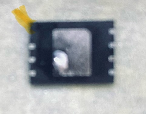

Dell Latitude 5520 Bios Password unlock
  • eurocomputerland
    • Jan 2025
    • 5
    • Romania
    #581
    What do you mean by wrong ST? (and no, I don't have a back-up BIOS only the recovery file but I cannot proceed further because on Admin Unlock screen)
    Please find attached the admin unlock screen.
    • danito
      • Jun 2016
      • 951
      • Romania
      #582
      Originally posted by eurocomputerland
      What do you mean by wrong ST? (and no, I don't have a back-up BIOS only the recovery file but I cannot proceed further because on Admin Unlock screen)
      Please find attached the admin unlock screen.
      You don't have any series on the cover?
Name:	image.png
Views:	133
Size:	27.3 KB
ID:	3549817โ€‹
      • LEO037_2029_
        BIOS_LEGEND
        • Nov 2023
        • 83
        • Argentina
        #583
        eurocomputerland try with this password = yyyyy7nn and tell me if work for you . feedback
        • eurocomputerland
          • Jan 2025
          • 5
          • Romania
          #584
          Yes, there is a label with those 3 lines:
          MFG YR-2022
          ST:16388S3
          EX:2545002867
          • peste
            • Dec 2016
            • 12859
            • ROMANIA
            #585
            Originally posted by eurocomputerland
            Yes, there is a label with those 3 lines:
            MFG YR-2022
            ST:16388S3
            EX:2545002867
            ok, I still need the bios..
            you need an SPI programmer...here is a video for example..https://www.youtube.com/watch?v=DWWi...nnel=ThisIsHow
            • alirafee
              • Jun 2015
              • 80
              • iran
              #586
              hello
              bios latitud 5520
              please unlock bios
              mfg yr 2021
              st 543GFG3
              • peste
                • Dec 2016
                • 12859
                • ROMANIA
                #587
                Originally posted by alirafee
                hello
                bios latitud 5520
                please unlock bios
                mfg yr 2021
                st 543GFG3
                try...
                • ali akbar
                  • Apr 2017
                  • 42
                  • bangladesh
                  #588
                  dell latitude 5420
                  gdf40 la-k491p
                  st-8D7B0J3
                  clean file please
                • Kiki Cares
                  • Feb 2022
                  • 29
                  • Nigeria
                  #589
                  I have Dell Latitude 5520
                  south peak 15 mb 213253-1 2twtt$la
                  password
                  I mistakenly removed the bios chip and the chip is not working again for me to read the file
                  pls have tried a lot of files and didnโ€™t work pls can you help me out
                  it will power and it will just display backlight and wonโ€™t show any character
                  blinking error light
                  • cram333
                    • Jul 2024
                    • 3
                    #590
                    Hello I lost the bin file from a Latitude 5520, I only have te ST: C7399J3
                    Can you help me to create a clean bios? Thank you!
                    • hoaca388
                      Badcaps
                      • Jan 2022
                      • 11798
                      #591
                      Originally posted by cram333
                      Hello I lost the bin file from a Latitude 5520, I only have te ST: C7399J3
                      Can you help me to create a clean bios? Thank you!
                      Post your backup bios file.
                      Mแปi khoแบฃn quyรชn gรณp cho badcaps ฤ‘แปu ฤ‘ฦฐแปฃc hoan nghรชnh, hรฃy nhแบฅp vร o liรชn kแบฟt nร y ฤ‘แปƒ quyรชn gรณp. Cแบฃm ฦกn tแบฅt cแบฃ nhแปฏng ngฦฐแปi แปงng hแป™----------------------------------------------------------------------------------------------------------------------------------------------------------------
                      • cram333
                        • Jul 2024
                        • 3
                        #592
                        Originally posted by hoaca388
                        Post your backup bios file.
                        lost it, I was not able to make a backup
                        • cram333
                          • Jul 2024
                          • 3
                          #593
                          I have loaded this bin and it seems to be functional, but..... SSDs are no been recognized. Is there something that I can do?
                          • QK Hafeez
                            • Apr 2024
                            • 71
                            • South Africa
                            #594
                            dell latitude 5520
                            โ€‹
                            can you plz unlock
                            southpeak 15
                            19819-1 8
                            thanks
                              • 20978
                              #595
                              Originally posted by QK Hafeez
                              dell latitude 5520
                              can you plz unlock
                              southpeak 15
                              19819-1 8
                              thanks
                              Service tag ? , service tag ? ,service tag ? ,service tag ? ,service tag ? ,service tag ? ,service tag ? ,service tag ? ,
                              RULES UPDATE for BIOS requests/offers AVOID BANNING, READ BEFORE POSTING
                              https://www.badcaps.net/forum/troubl...before-posting
                              BIOS guides, methods, resources and tools
                              https://www.badcaps.net/forum/troubl...rces-and-toolsโ€‹
                              • QK Hafeez
                                • Apr 2024
                                • 71
                                • South Africa
                                #596
                                service tag 9l84qg3
                                  • 20978
                                  #597
                                  Originally posted by QK Hafeez
                                  service tag 9l84qg3
                                  What is the suffix, 8FC8 or something else, have you read the password topic, have you tried anything to unlock it yourself https://www.badcaps.net/forum/troubl...23#post1622423
                                  • QK Hafeez
                                    • Apr 2024
                                    • 71
                                    • South Africa
                                    #598
                                    thanks for this going to try my self and update you
                                    • QK Hafeez
                                      • Apr 2024
                                      • 71
                                      • South Africa
                                      #599
                                      no luck sir
                                      • LBTT1121
                                        • Nov 2024
                                        • 552
                                        • Viแป‡t Nam
                                        #600
                                        Originally posted by QK Hafeez
                                        no luck sir
                                        try and feedback
                                        • gizaha
                                          Dell Latitude 5580 possible bios corruption
                                          by gizaha
                                          Dell latitude 5580, motherboard cdp 80 la-e151p
                                          3 amber 3 white blinks. Dell website sais it's problem "bios recovery" and suggested solution "recovery image not found"
                                          (from here https://www.dell.com/support/manuals...e7a&lang=en-us)
                                          I try plugging charger while pressing ctrl+esc, machine turns on, nothing and after 20 seconds it gives 3 amber 3 white blinks again.
                                          Since ssd is replaced and had clean install windows, i've...
                                          02-13-2024, 07:18 AM
                                        • Jeff'sTech
                                          Dell Latitude 7420 BIOS Unlock Gone Wrong
                                          by Jeff'sTech
                                          Hello everyone.
                                          I have come here with a rather specific question. I was given a Dell Latitude 7420 laptop with a busted screen, and wanted to see if I could refurbish it into my daily driver. I wanted to experiment and see if a 2-in-1 display would work as the chassis of the laptop and 2-in-1 7420 looked identical. I threw in the display and my hypothesis was correct, however, I was greeted with a locked BIOS and since I didn't know the password, I figured I'd try to unlock it somehow. I bought one of those POGO pin probe things for my CH341A programmer so I could read and make...
                                          11-08-2023, 03:30 PM
                                        • jhanra
                                          Dell Latitude 5400 Chromebook UEFI bios
                                          by jhanra
                                          Hi there masters, recently i got a dell 5400 chromebook and wanted to install windows, i searched the internet and i found out other people also wanting a UEFI bios for this model, i searched there is a R/W legacy, but there are bugs like keyboard/trackpad not working, and hard to install.
                                          so i decided to try to port one, this bios is based on dell 5400 windows version, i am testing this bios for a week now an found only a little to no bug at all in windows 10, or only a minor issue
                                          in windows 11 sound driver compatibility, but overall its ok, for me i can deal with it, ๐Ÿ˜…๐Ÿ˜…๐Ÿ˜…...
                                          11-02-2024, 04:19 AM
                                          DELL Latitude 5520 Notebook 5000 Specification for Upgrade or Repair
                                          This specification for the DELL Latitude 5520 Notebook can be useful for upgrading or repairing a laptop that is not working. As a community we are working through our specifications to add valuable data like the 5520 boardview and 5520 schematic. Our users have donated over 1 million documents which are being added to the site. This page will be updated soon with additional information. Alternatively you can request additional help from our users directly on the relevant badcaps forum. Please note that we offer no warranties that any specification, datasheet, or download for DELL Latitude 5520...
                                          09-07-2024, 06:38 AM
                                          DELL Latitude 5520 Notebook 5000 Specification for Upgrade or Repair
                                          This specification for the DELL Latitude 5520 Notebook can be useful for upgrading or repairing a laptop that is not working. As a community we are working through our specifications to add valuable data like the 5520 boardview and 5520 schematic. Our users have donated over 1 million documents which are being added to the site. This page will be updated soon with additional information. Alternatively you can request additional help from our users directly on the relevant badcaps forum. Please note that we offer no warranties that any specification, datasheet, or download for DELL Latitude 5520...
                                          09-07-2024, 06:31 AM
