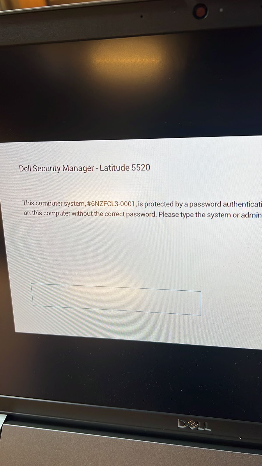

Dell Latitude 5520 Bios Password unlock
  • Vesko356
    VIP Moderator
    • Aug 2018
    • 4386
    • Bulgaria 🇧🇬
    #241
    Re: Dell Latitude 5520 Bios Password unlock
    Originally posted by itechdna
    Unfortunately i already pressed alt+f2 :/ laptop is fully assembled.. i will have to flash again bios chip ? where to find service tag number ? thanks
    You shouldn't have done that, you were a bit hasty in that case I'm afraid. You will have to do everything from the beginning because the Service Tag can only be entered in active manufacturing mode. The Service Tag along with the Express Service Code are printed on the factory label, which is usually located on the back cover.
    Become a Badcaps supporter
    Thanks to all supporters.​
    • aldopc
      • Jul 2017
      • 465
      • Chilito
      #242
      Re: Dell Latitude 5520 Bios Password unlock
      Originally posted by itechdna
      Unfortunately i already pressed alt+f2 :/ laptop is fully assembled.. i will have to flash again bios chip ? where to find service tag number ? thanks
      Friend, enter the bios in the menu on the left, look for where it says maintenance, and enter the service tag that is written on the bottom of the equipment, if you do not have the tag, let me know so I can indicate your stag
      • VictorAntunes
        • Apr 2021
        • 7
        • Brazil
        #243
        Re: Dell Latitude 5520 Bios Password unlock
        Hi, somebody can help me to remove password bios ?
        LA-K491P
        • aldopc
          • Jul 2017
          • 465
          • Chilito
          #244
          Re: Dell Latitude 5520 Bios Password unlock
          Originally posted by VictorAntunes
          Hi, somebody can help me to remove password bios ?
          LA-K491P
          all donations are welcome,
          see the donate button at the bottom of the page,
          • luisvalenzuelajr
            • Jun 2015
            • 51
            • Brasil
            #245
            Re: Dell Latitude 5520 Bios Password unlock
            good afternoon, please i need this bios unloacked, this is my backup
            • alfredposadas09
              • Aug 2020
              • 343
              • Philippines
              #246
              Re: Dell Latitude 5520 Bios Password unlock
              Originally posted by luisvalenzuelajr
              good afternoon, please i need this bios unloacked, this is my backup
              here is your unlocked file
              • luisvalenzuelajr
                • Jun 2015
                • 51
                • Brasil
                #247
                Re: Dell Latitude 5520 Bios Password unlock
                Originally posted by alfredposadas09
                here is your unlocked file
                thank you very much, it worked perfectly
                • mesta83
                  • Nov 2015
                  • 75
                  • merseyside
                  #248
                  Re: Dell Latitude 5520 Bios Password unlock
                  Hi, got a 5520 that needs unlocking please
                  • narsil
                    Enas
                    • Dec 2017
                    • 83
                    • france
                    #249
                    Re: Dell Latitude 5520 Bios Password unlock
                    Originally posted by mesta83
                    Hi, got a 5520 that needs unlocking please
                    try this
                    Last edited by narsil; 04-26-2023, 03:36 PM.
                    • H8Core
                      • Apr 2023
                      • 7
                      • Hessen
                      #250
                      Re: Dell Latitude 5520 Bios Password unlock
                      Can someone please tell me for a mainboard: SouthPeak 15 TGL 8 MB 8L with i7-1185g7, since my programming device only reads FF FF and ID(9F): FFFFFF(Unknown)
                      ID(90): FFFF(Unknown)
                      ID(AB): FF(Unknown)
                      ID(15): FFFF(Unknown)
                      indicates
                      Provide a fresh Bios.bin ?
                      and CRC32 = 0x83131B14
                      Last edited by H8Core; 04-29-2023, 08:08 AM. Reason: added CRC32 = 0x83131B14
                      • Vesko356
                        VIP Moderator
                        • Aug 2018
                        • 4386
                        • Bulgaria 🇧🇬
                        #251
                        Re: Dell Latitude 5520 Bios Password unlock
                        Originally posted by H8Core
                        Can someone please tell me for a mainboard: SouthPeak 15 TGL 8 MB 8L with i7-1185g7, since my programming device only reads FF FF and ID(9F): FFFFFF(Unknown)
                        ID(90): FFFF(Unknown)
                        ID(AB): FF(Unknown)
                        ID(15): FFFF(Unknown)
                        indicates
                        Provide a fresh Bios.bin ?
                        and CRC32 = 0x83131B14
                        A very neatly presented question, everything is clear and understandable at first glance.
                        Become a Badcaps supporter
                        Thanks to all supporters.​
                        • MahmoudNasser
                          • Jan 2021
                          • 37
                          • Egypt
                          #252
                          Re: Dell Latitude 5520 Bios Password unlock
                          Originally posted by alfredposadas09
                          here is your unlocked file
                          Hello brother
                          can I ask a question ?
                          Where do I learn to remove the password from Bios
                          Or do you use a program to unlock it?
                          • lapfix
                            • Mar 2020
                            • 2720
                            • my workshop
                            #253
                            Re: Dell Latitude 5520 Bios Password unlock
                            Originally posted by MahmoudNasser
                            Hello brother
                            can I ask a question ?
                            Where do I learn to remove the password from Bios
                            Or do you use a program to unlock it?
                            First participation, First request !!
                            post your locked file here and someone will help you
                            • drnbilisim
                              • May 2023
                              • 5
                              • turkiye
                              #254
                              Re: Dell Latitude 5520 Bios Password unlock
                              worked well
                              • MahmoudNasser
                                • Jan 2021
                                • 37
                                • Egypt
                                #255
                                Re: Dell Latitude 5520 Bios Password unlock
                                Originally posted by lapfix
                                First participation, First request !!
                                post your locked file here and someone will help you
                                Thanks for your opinion
                                I am a member of the forum since 2021, and I benefited a lot from it, It doesn't mean that I didn't post posts, so I don't know.
                                • gymo
                                  • May 2023
                                  • 5
                                  #256
                                  Re: Dell Latitude 5520 Bios Password unlock
                                  Did i do something wrong, my posts seem to have vanished
                                  • Vesko356
                                    VIP Moderator
                                    • Aug 2018
                                    • 4386
                                    • Bulgaria 🇧🇬
                                    #257
                                    Re: Dell Latitude 5520 Bios Password unlock
                                    Originally posted by gymo
                                    Did i do something wrong, my posts seem to have vanished
                                    Yes, you did.
                                    I've deleted the posts.
                                    Look carefully at the thread title and you'll find out why!
                                    Become a Badcaps supporter
                                    Thanks to all supporters.​
                                    • gymo
                                      • May 2023
                                      • 5
                                      #258
                                      Re: Dell Latitude 5520 Bios Password unlock
                                      Originally posted by Vesko356
                                      Yes, you did.
                                      I've deleted the posts.
                                      Look carefully at the thread title and you'll find out why!
                                      Ah, sorry
                                      • MahmoudNasser
                                        • Jan 2021
                                        • 37
                                        • Egypt
                                        #259
                                        Re: Dell Latitude 5520 Bios Password unlock
                                        Hello
                                        Please unlock this file
                                        • walid1992
                                          • May 2016
                                          • 35
                                          • tripoly
                                          #260
                                          Re: Dell Latitude 5520 Bios Password unlock
                                          Please unlock this file
                                          • gizaha
                                            Dell Latitude 5580 possible bios corruption
                                            by gizaha
                                            Dell latitude 5580, motherboard cdp 80 la-e151p
                                            3 amber 3 white blinks. Dell website sais it's problem "bios recovery" and suggested solution "recovery image not found"
                                            (from here https://www.dell.com/support/manuals...e7a&lang=en-us)
                                            I try plugging charger while pressing ctrl+esc, machine turns on, nothing and after 20 seconds it gives 3 amber 3 white blinks again.
                                            Since ssd is replaced and had clean install windows, i've...
                                            02-13-2024, 07:18 AM
                                          • Jeff'sTech
                                            Dell Latitude 7420 BIOS Unlock Gone Wrong
                                            by Jeff'sTech
                                            Hello everyone.
                                            I have come here with a rather specific question. I was given a Dell Latitude 7420 laptop with a busted screen, and wanted to see if I could refurbish it into my daily driver. I wanted to experiment and see if a 2-in-1 display would work as the chassis of the laptop and 2-in-1 7420 looked identical. I threw in the display and my hypothesis was correct, however, I was greeted with a locked BIOS and since I didn't know the password, I figured I'd try to unlock it somehow. I bought one of those POGO pin probe things for my CH341A programmer so I could read and make...
                                            11-08-2023, 03:30 PM
                                          • jhanra
                                            Dell Latitude 5400 Chromebook UEFI bios
                                            by jhanra
                                            Hi there masters, recently i got a dell 5400 chromebook and wanted to install windows, i searched the internet and i found out other people also wanting a UEFI bios for this model, i searched there is a R/W legacy, but there are bugs like keyboard/trackpad not working, and hard to install.
                                            so i decided to try to port one, this bios is based on dell 5400 windows version, i am testing this bios for a week now an found only a little to no bug at all in windows 10, or only a minor issue
                                            in windows 11 sound driver compatibility, but overall its ok, for me i can deal with it, 😅😅😅...
                                            11-02-2024, 04:19 AM
                                            DELL Latitude 5520 Notebook 5000 Specification for Upgrade or Repair
                                            This specification for the DELL Latitude 5520 Notebook can be useful for upgrading or repairing a laptop that is not working. As a community we are working through our specifications to add valuable data like the 5520 boardview and 5520 schematic. Our users have donated over 1 million documents which are being added to the site. This page will be updated soon with additional information. Alternatively you can request additional help from our users directly on the relevant badcaps forum. Please note that we offer no warranties that any specification, datasheet, or download for DELL Latitude 5520...
                                            09-07-2024, 06:38 AM
                                            DELL Latitude 5520 Notebook 5000 Specification for Upgrade or Repair
                                            This specification for the DELL Latitude 5520 Notebook can be useful for upgrading or repairing a laptop that is not working. As a community we are working through our specifications to add valuable data like the 5520 boardview and 5520 schematic. Our users have donated over 1 million documents which are being added to the site. This page will be updated soon with additional information. Alternatively you can request additional help from our users directly on the relevant badcaps forum. Please note that we offer no warranties that any specification, datasheet, or download for DELL Latitude 5520...
                                            09-07-2024, 06:31 AM
