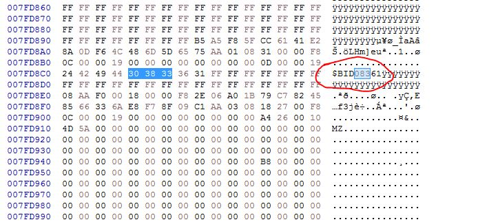

    Hi All, I am working on this Hp 15-cc523ca MB DAG71MB16D0 Rev D. The problem was that it was dead & the 5V IC SY8288CRAC was burnt & shorted the 19v rail. I replaced it, now no short at all & the 19v rail is fine on all points, but still it does not turn on. I get 3.3v on the power ON/OFF button connector & now assuming it might be a corrupted BIOS. Can anybody re-build this original BIOS. Thanks in advance

    See this thread https://www.badcaps.net/forum/showthread.php?t=103498 .Look at post #3
    Download your bios https://ftp.hp.com/pub/softpaq/sp134...0/sp134416.exe .Just follow the same steps in that post ,the only difference is the end offset
    220000 - 22803F (Length 8040)
    You can flash the virgin bios but you will lose all DMI info.You can copy the DMI easily with a hex editor and insert it into the virgin bios in less than a minute.The alternative is to use HP DMI tools.

        SMDFlea, Ok I think I have made the changes correctly, can you please verify whether I have done it the correct way. I have uploaded the Original BIOS & the Hp downloaded BIOS (Changes done).. My Hp uses ths 0836B BIOS Version. Thanks in Advance

          No its not right your bios version is BID08361 .Your DMI offsets are 220000 - 22803F (Length 8040) .Download your bios,run the exe to extract them https://ftp.hp.com/pub/softpaq/sp134...0/sp134416.exe open your backup and the extracted 08361 with hxd they will be side by side,enter the offsets in both, copy from your backup,paste insert into the 08361

            Thank you very much... I did it now, but still motherboard is missing 3.3/5V, I have no reason why., I will open a new Trouble shooting string... Thanks

              SMDFlea, Now please check whether I have done it correctly, first time doing it, so I am bit protective with the changes... Thanks in advance

                Perfect
                You can do any HP Insyde bios the same way (usually) you just have to find the offsets as they can be in different places.The win key offsets can be added seperately it doesn`t have to be,and isn`t always in one big block
