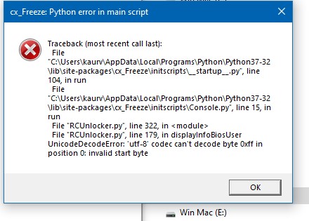

                            #1433
                            Re: HP BIOS unlock tool
                            Hi, just patched 9470m and now I get white screen instead bios on startup, program should support that model?
                            badcaps.net
                            • peste
                              • Dec 2016
                              • 13243
                              • ROMANIA
                              #1434
                              did you read the first page? did you make a copy of the original bios before writing? write the copy back to the chip and see what happens..
                              • qba82
                                • Jun 2021
                                • 9
                                • Poland
                                #1435
                                I have uploaded old bios and it works again, but it has bios password, after that I have downloaded bios from internet for that model, cleared ME region, and it finally works
                                badcaps.net

                                  #1436
                                  Hey Can you please help me with this BIOS PASSWORD, I managed to upload the date
                                  Can you please help
                                  • anhbanxoi
                                    • Sep 2021
                                    • 178
                                    • VN
                                    #1437
                                    Can you please help
                                    It's not BIOS file. the content is empty (filled by FF).
                                    • animorca11
                                      • Apr 2023
                                      • 8
                                      #1438
                                      i AM SORRY for bothering you, I bought CH341A and I have tried to read the bios but nothing works any help ?
