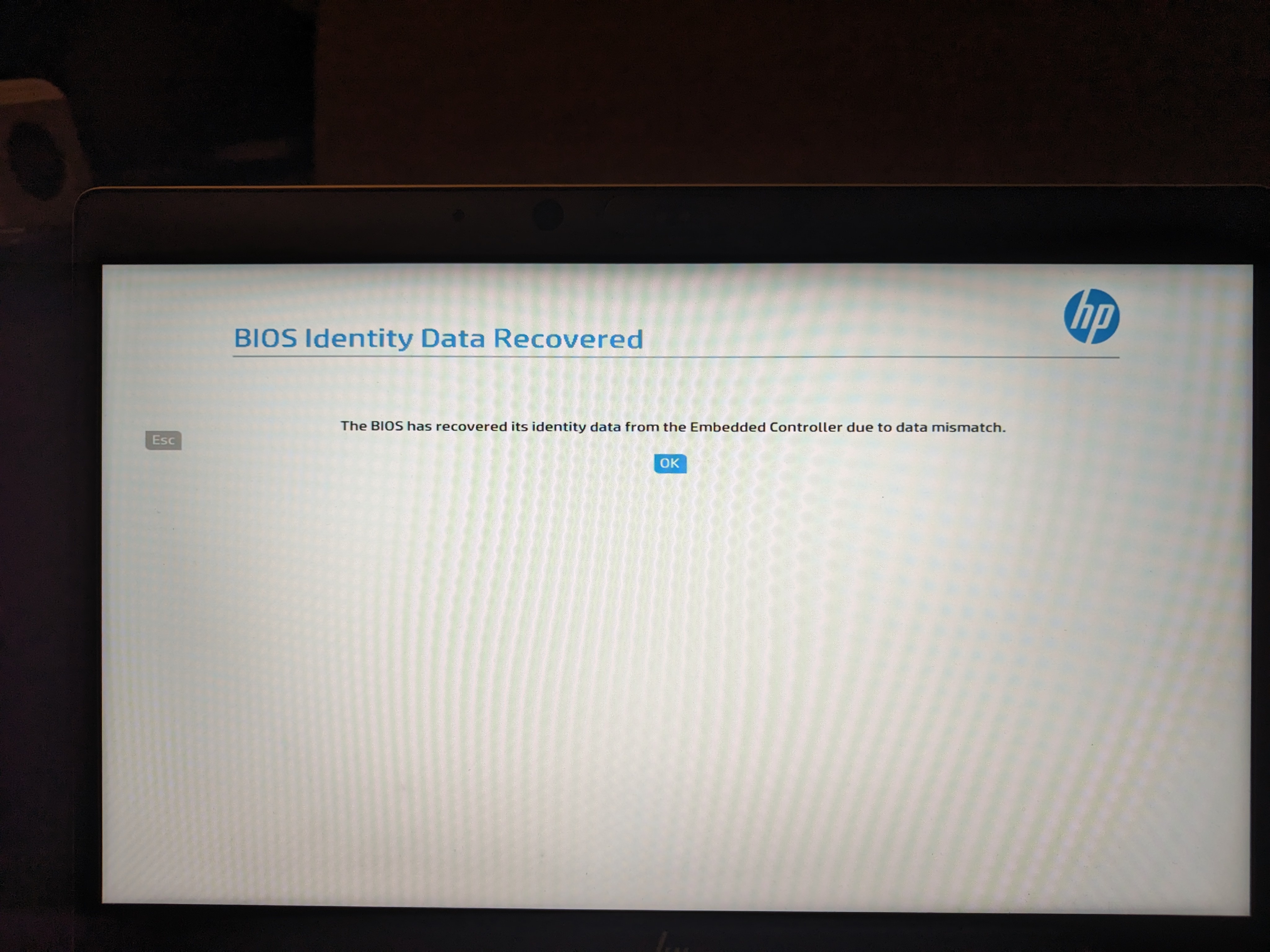

            Hello, I recently got two locked HP EliteBook 840 G5, I've seen that this tool supports them - however I am not able to get it working.
            When I dragged the locked dump onto the exe, I get a supposedly unlocked file, but when I flash it, the BIOS is still locked.
            I am flashing/reading from the 32MB chip.

              #1566
              Here are my locked dumps.
              For File 1 :
              First boot loaded bios factory defaults, save and exit and then at the next boot reseted security settings .
              In the first boot go to bios menu and disable security options (Default).
              You must fill your DMI manually.
              For File 2 : try to read again twice and compare them , i think the one you uploaded is not GOOD

                  #1569
                  Originally posted by lapfix
                  For File 1 :
                  Thank you for the response, however, after flashing the 1 unlocked.bin to the corresponding laptop, it just showed "The BIOS has recovered it's identity data from the embedded controller due to data mismatch." and it is still locked.
