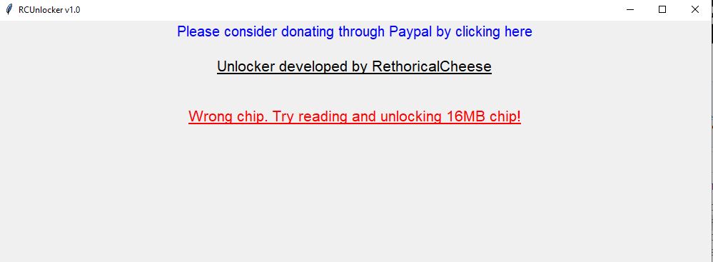

                    I used the HP unlock tool with 840 G6 8gen but no success

                      Re: HP BIOS unlock tool
                      Because G6 is supported by rcunlocker, not this old tool. Use rcunlocker on your original EC dump.

                        #1331
                        Thank you but when i drop the 32mb file on rcunlocker i have an error

                          #1332
                          i found it it was in the back of the motherborad
