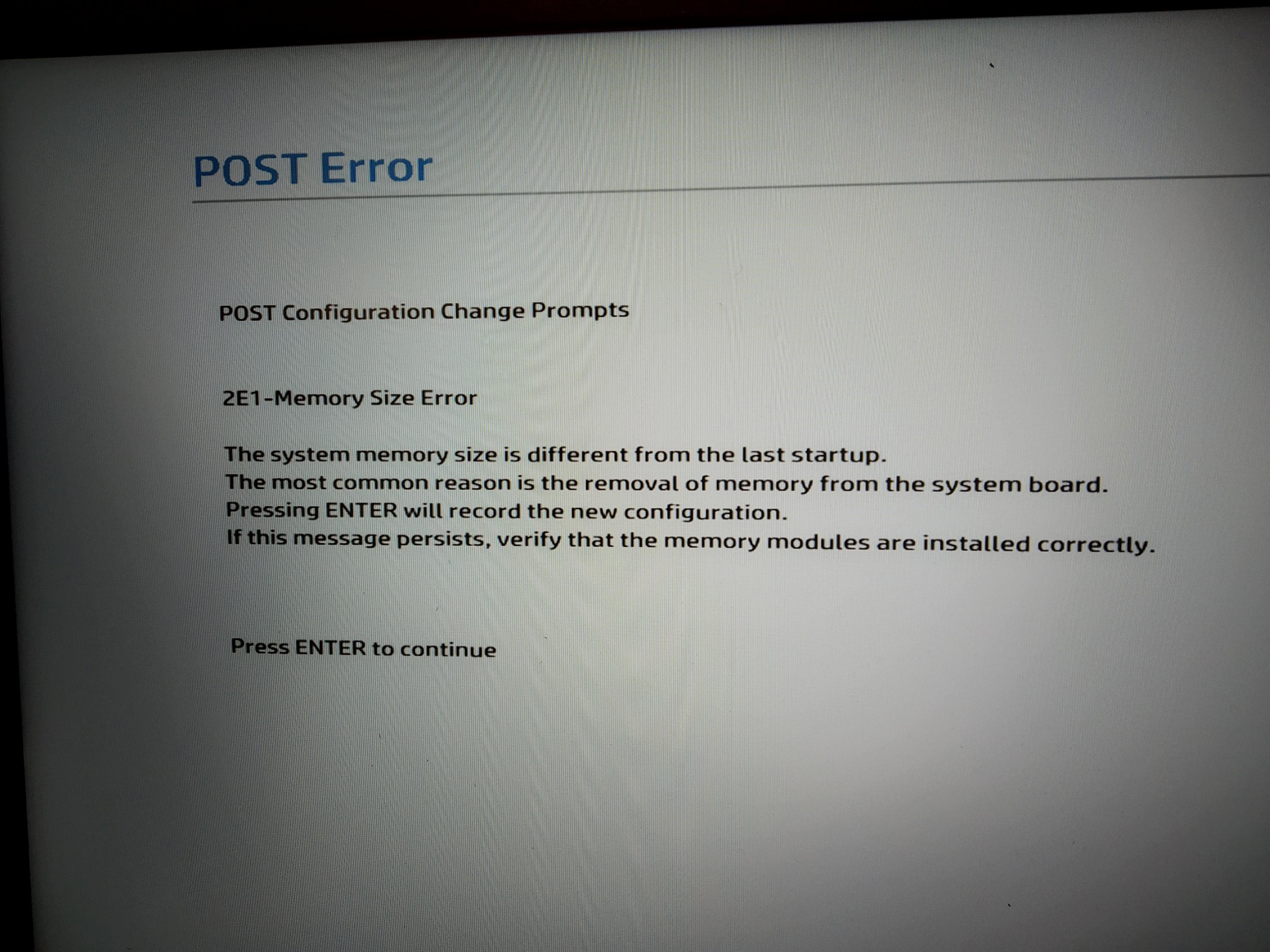

                                    Re: HP BIOS unlock tool
                                    Originally posted by RethoricalCheese
                                    AA55 must stay as it is. And zeroing is not exactly the right word. You need to copy clean UserCred section with the same length from another file. There are other values in that section which have to be present for it to work. That's the main reason I did not want to clear up to AA55 automatically.
                                    Hello again, I read through this thread and came up with all of your comments. You are right, this section also needs to be replaced from a Non-locked bios to remove the Power-On Authentication. For my bios dump I did the following:
                                    1. Use the HPUnlocker_v1 tool to create an unlocked .bin.
                                    2. Open this unlocked bin file with HxD Editor.
                                    3. Search (Ctrl+F) for the keyword "UserCred" as Unicode. Note: In my case this appeared three times, but only one of them is the section needed.
                                    4. Select from the beginning (Starting in 55 00 73 00 65 00 72 00) until the flag "AA 55" appeared. This was of length "DE6" (hex) or 3558 (dec).
                                    5a. Open the empty file provided by peste and select/copy exactly the same section as in the previous step.
                                    Originally posted by peste
                                    try..
                                    5b. To make it easier for anyone, I attached the template as "empty-user-power-on-template.bin", so you only need to copy it directly, instead of doing step 5a.
                                    6. Paste write (Ctrl+B) the template into the selected section from step 4.
                                    7. Double check that the file has the same size as before replacing the template. (Ctrl+A), in my case the length was 1000000 hex.
                                    8. Save it as a new bin file.
                                    9. Flash this file into your chip. (I used flashrom in Linux, I can really recommend it)
                                    10. On booting i found a "Post Error" saying the memory size is different from last time, i pressed enter. Now there is no password on boot nor on bios!
                                    11. Just to make sure, go to bios > security and reset the security to default.
                                    I hope that is helpful for someone in the future. If more people can confirm this method it could be possible to automate this process inside the HPUnlocker tool, right?
                                    Thanks to RethoricalCheese for his tool and to all the guys posting here!
