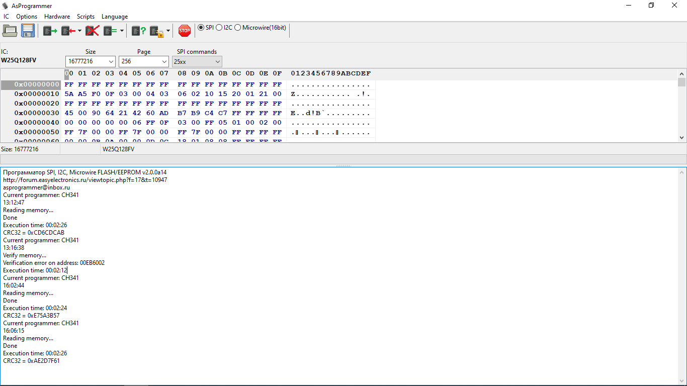

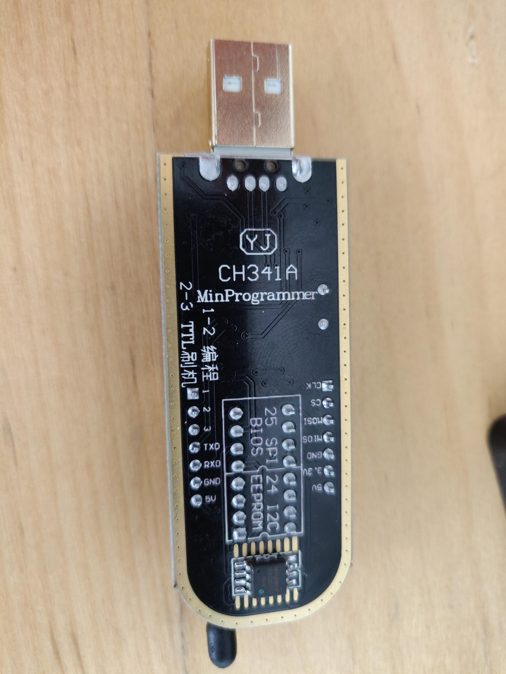

            I desoldered the chip (is a winbond W25Q128FV) and try to read it using am CH341A Programmer and a test clip (https://www.aliexpress.com/item/32716202129.html)
            I have read the content of the chip 4 times and got 4 different bin files. Under these circumstances I don't want to risk the total destruction and to try to flash the file generated by the removal tool. Can you possibly recognize my problem? The files are partly the same but some areas are completely different.

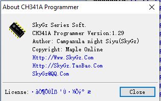

              What software do you use?
              • quidep
                • Apr 2020
                • 19
                #187
                Re: HP BIOS unlock tool
                CH341A Programmer V1.29, see also the screenshot.

                    Thank you for your advice! I've tried it using AsProgrammer v 2.0 and found by the way many threads in different forums about the same problem as in my case:
                    Verification Failure CH341a - W25Q128FV Help
                    W25Q128FV can't be flashed
                    RE: [Guide] Using CH341A-based programmer to flash SPI EEPROM
                    I've soldered the chip directly to the programmer now and I've used following versions of the different programmer SW:
                    CH341A Programmer 1.19
                    CH341A Programmer 1.29
                    AsProgrammer 1.4.0
                    AsProgrammer 1.4.1
                    AsProgrammer 2.0.0a14
                    But I have still the same problem, the dumps are not exactly the same. Do you have any other idea?

                      Whats the lenght of your programmer wires?
                      I have kept them less than 20cm and everything works perfectly. Tho I havent used CH341A for a while now.
                      Miniprog and such seem unreliable to me aswell. One of my favourites and quite cheap option is using raspberry pi.
                      Pi Zero being as cheap as CH341A. It is 5€ if you can find any.
                      I use Zero W or 3B but any of them should work just as well.
                      Flashrom as the software.

                        One thing I've recognized is: last dumps, created using desoldered chip and SW except CH341A Programmer 1.29 which is suspected to be buggy, differ only in the area between 00EB6000 and 00EB6FF0. Is it possibly intended to be different for some special purpose like encryption or something else?

                          No wires at all since I've soldered the chip directly to the programmer PCB which is connected directly to a USB port.

                              I did it, more than one time, using different versions of the SW listed in one of my previous posts. See the screenshot for AsProgrammer v 2.0 mentioned in the topic 188.

                                So, I did it again... Using Raspberry Pi 4 and flashrom, same problem, differences at 00EB6000. Any other suggestions?

                                  Something new: as mentioned somewhere in web I added a decoupling capacitor between VCC and GND. I used 2.2uF or 10uF. There are still differences in the same range but lesser than without capacitors. A hardware issue?
