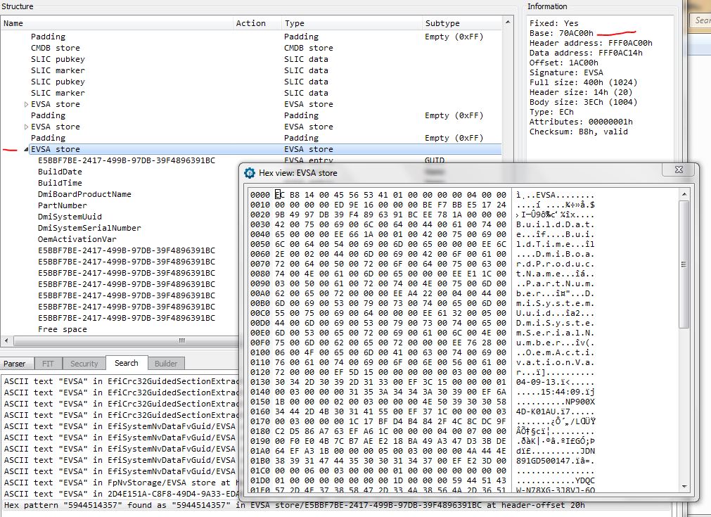

          A lot of the older samsung bios get corrupted NVRAM . Try merging the bios update. https://www.badcaps.net/forum/showthread.php?t=88206 .The platform ID is ABK if its the original bios.
          Extract the DMI from the EVSA store using UEFITool (extract as is, just this EVSA store,not all of them) or with a hex editor 70AC00 - 70ADFF

            Thanks Peste & SMDFlea.. really appreciate!!! Going to do it for the first time.. Let's see how far I can go with this. So you mean I have to Extract the DMI from the EVSA Store & drag it to the Samsung Extractor with the Original BIOS Bin Files???
              • 20781
              Re: Samsung NP900X4C-A01CA BIOS
              No,the downloaded bios update needs extracting with the attached tool, then that extracted file wants copying/merging over the orig bios

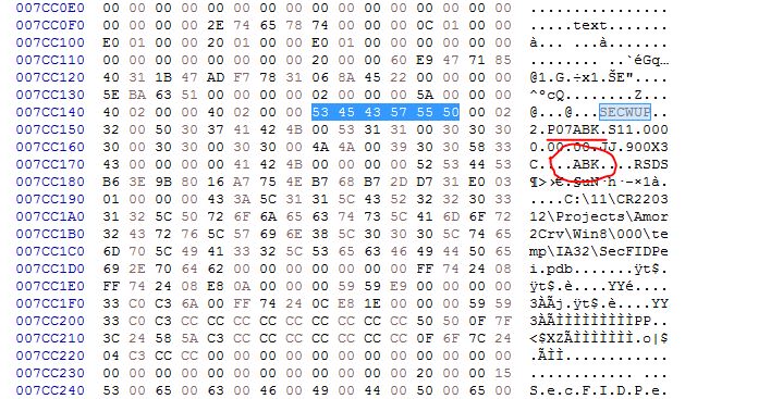

                  The extracted file needs editing as it has a capsule header ,Select off-sets 0 - 1CF (length 1D0) ,delete.Then there`s more editing to do to make it the right size... its a 3MB update (bios region).

                                      After getting the file as you did in Post #16. This file isn't a Full BIOS Image (It's just a BIOS Region), so I replaced it with the old one (You can use UEFITool or HxD) then I cleaned the ME Region.
