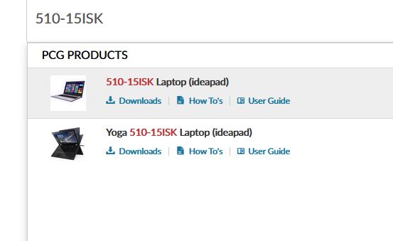

                    • 22279
                    Re: Lenovo yoga 510-15isk - bios need
                    Originally posted by basic
                    same result
                    product name :INVALID
                    MTM : INVALID
                    LENOVO SN : INVALID
                    MAYBE THOSE ARE CAUSES ..
                    You have a Yoga version,this is the right bios https://www.badcaps.net/forum/showthread.php?t=74216 .You have no DMI in your backup as far as i can see ,so it can`t be copied from your backup.
                    The two 510-15isk models both have a different bios.
                    • basic
                      • Oct 2017
                      • 229
                      • 86357289244
                      thanks a lot my friend works perfect now
