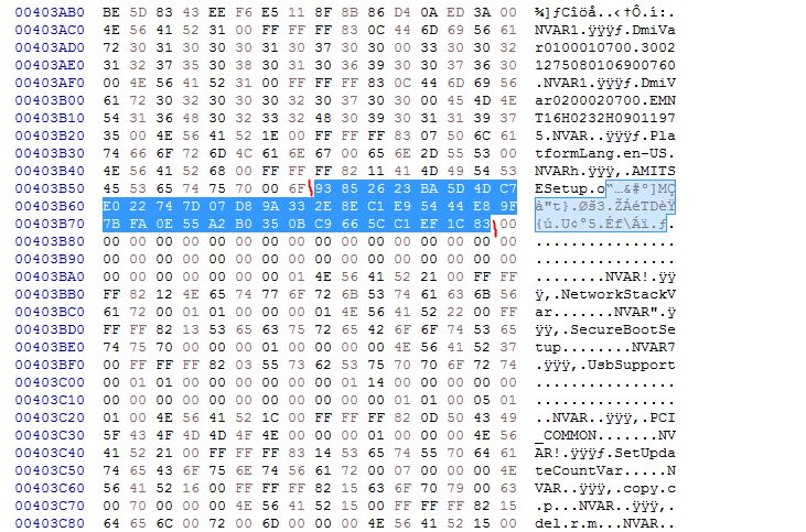

    Hi guys
    i have a Medion E2215T - MD 60213 laptop. It was bought from someone who no longer lives here on Gran Canaria
    The hard drive is embedded on the PCB and it will not boot into an OS I just get the requester for a BIOS password which is unknown so I can't get into the BIOS and boot from USB either.
    I tried removing the battery and leaving it overnight but it made no difference
    Can I clear the password by removing he BIOS chip and reprogramming it with a new bin file using my Eprom programmer? If so does anyone have a suitable BIOS bin file? Assuming the password is held in the BIOS. It must be held somewhere
    Thanks guys

    post the bios backup and someone will help

        Re: Medion E2215T BIOS Password problem
        Damn - it's a 25Q64FW
        That's a 1.8V Eprom and my TL866CS doesn't do 1.8V
        Looks like I need another programmer
          You can buy cheap 1.8v adapters that should work with your programmer.
            Originally posted by dicky96
            Thanks. I'll get the chip unsoldered and read it.
            Try this password !$NOIDEM?#
              I desoldered the BIOS chip and read the contents (before seeing the suggested password form SMDFlea)
              Seeing as I already removed it, here is the original file (attached)
              Does someone know how to clear the password and for that matter does someone know where I can learn to do that myself?

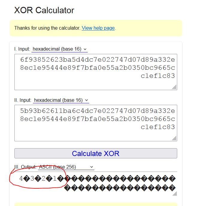

                • 21293
                Heres the password rich .The pass is stored in the AMITSESetup NVRAM variable .
                More info about bios passwords here https://www.badcaps.net/forum/showpo...42&postcount=4
                AMI Decryptor https://www.badcaps.net/forum/showthread.php?t=102275
                https://gist.github.com/en4rab/55088...f3039e3c8ab6fd
