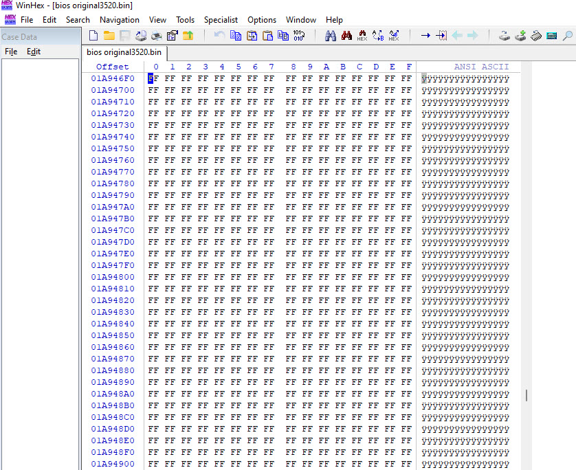

                              #134
                              Re: unlock bios for dell latitude 3520
                              hi guys,this is mi first time posting someting in my life, srry if i don't do it properly in advance.
                              Can some one help me unlock this latitude 3520 bios?
                              • Ghamidi
                                • Mar 2020
                                • 306
                                • France
                                #135
                                bad backup more FFFFFFFFF hex value
                                • omartancol
                                  • Jul 2020
                                  • 11
                                  • Queretaro
                                  #136
                                  is there someting i can do? i has read the bios with ch341A and the same name program, then tryed to rewrite the bios with multiple errors in the verification, that's wen i realised i needed other programer or program to do it properly and found that with AsProgramer i could dumped my bios the right way, but now i only have this bad backup of my bios
                                  • Ghamidi
                                    • Mar 2020
                                    • 306
                                    • France
                                    #137
                                    Try this file
                                    • omartancol
                                      • Jul 2020
                                      • 11
                                      • Queretaro
                                      #138
                                      Try this file
                                      it worked!! thx for taking time to help me , i was really lost, i really apreciate it man
                                      • Ghamidi
                                        • Mar 2020
                                        • 306
                                        • France
