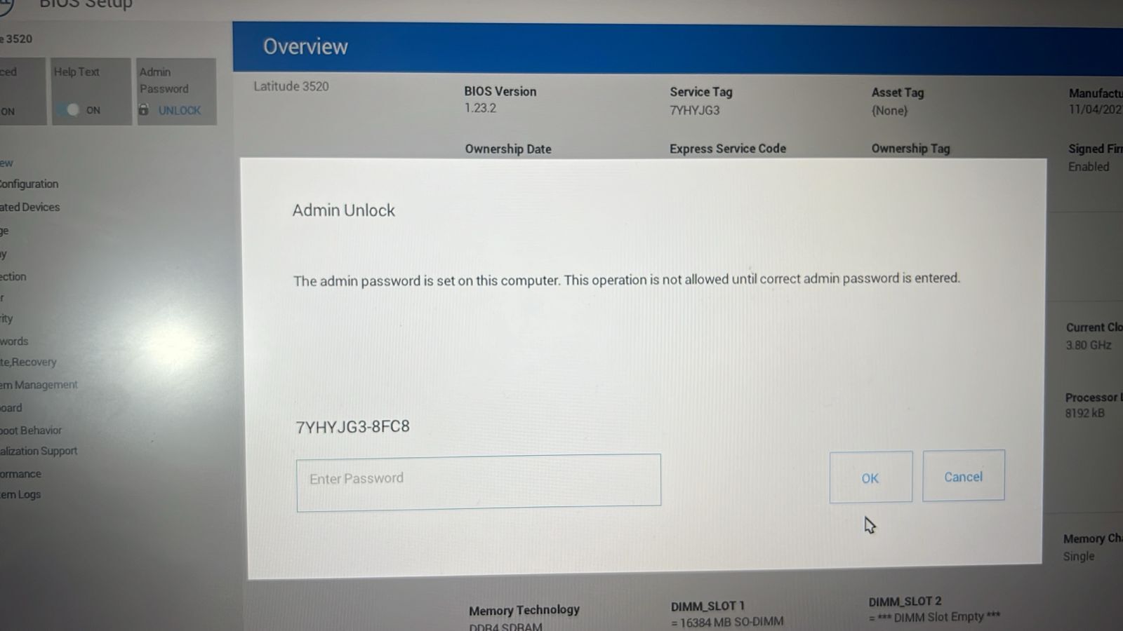

                    #190
                    Hello
                    Can you help me with remove bios password from Dell Latitude 3520 11Gen
                    S/N H1jcr93
                    Thank You
                    • Markus1741
                      • Sep 2020
                      • 994
                      • N/A
                      #191
                      Originally posted by Andromedus_81
                      Hello
                      S/N H1jcr93
                      Thank You
                      Try this unlocked file ... Good luck ...

                      • Andromedus_81
                        • Aug 2023
                        • 67
                        • United Kingdom
                        #192
                        Thank You is working. Can i ask you one more thing. Did yo know ME Region values for this model Start and length? and can I use yours unlocked bios for the same model with bios password if is the same model?

                          #193
                          Hello, I think this won't work.
                          You should always clean the me region if you want to use it on another notebook.
                          You would also have to change the Windows key because otherwise it always stays the same.
                          It is easier for every new notebook to read the file and perform an unlock.
                          I may be wrong, but that's how I would do it.
                          Best regards
                          • Andromedus_81
                            • Aug 2023
                            • 67
                            • United Kingdom
                            #194
                            Thank You, but how I can unlock new bios dump in the same model?
