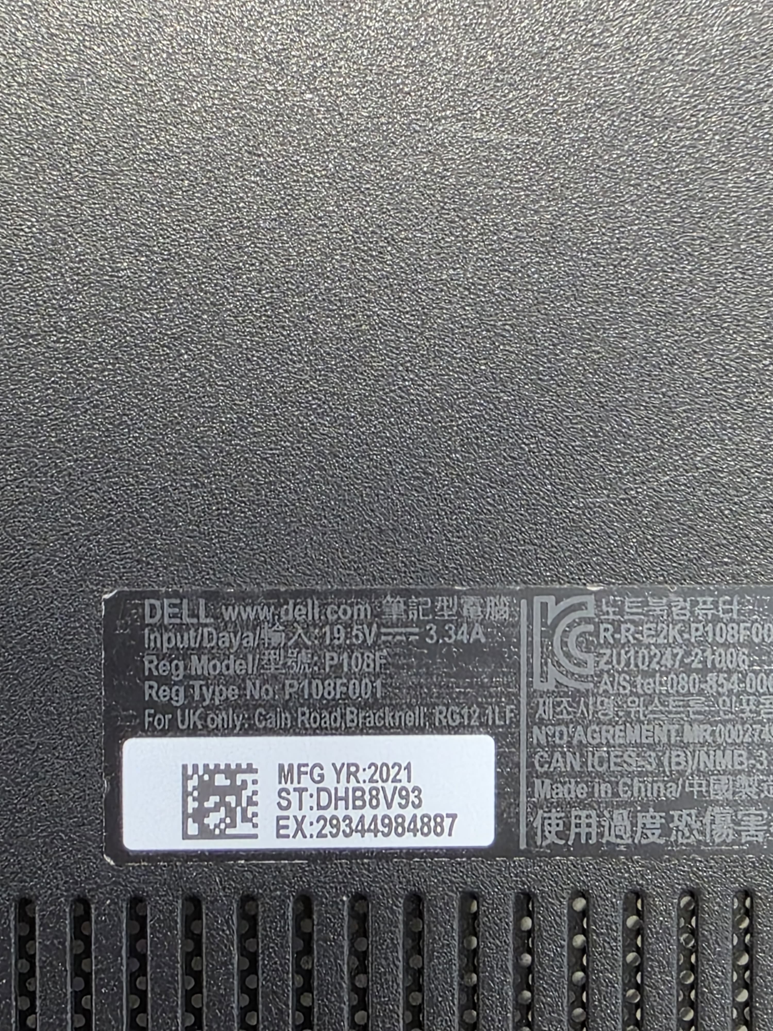

          • volinakis
            • Jan 2021
            • 2875
            • N/A
            #386
            Originally posted by azim14kh
            dell latitude 3520
            TYPE the laptop service tag, full name and model. And also state the problem of laptop, bios locked, doesn't start, etc.
            • azim14kh
              • Oct 2023
              • 10
              • Switzerland
              #387
              Dell Latitude 3520
              Cyberg-L15 MB TGL 203070-1 motherboard number
              service tag DHB8V93
              dosnt start , after start very slow
              • volinakis
                • Jan 2021
                • 2875
                • N/A
                #388
                Dell Latitude 3520
                service tag DHB8V93
                try this one (clean ME)
                • azim14kh
                  • Oct 2023
                  • 10
                  • Switzerland
                  #389
                  many thanks many thanks many thanks
                  it worked
                  • volinakis
                    • Jan 2021
                    • 2875
                    • N/A
                    #390

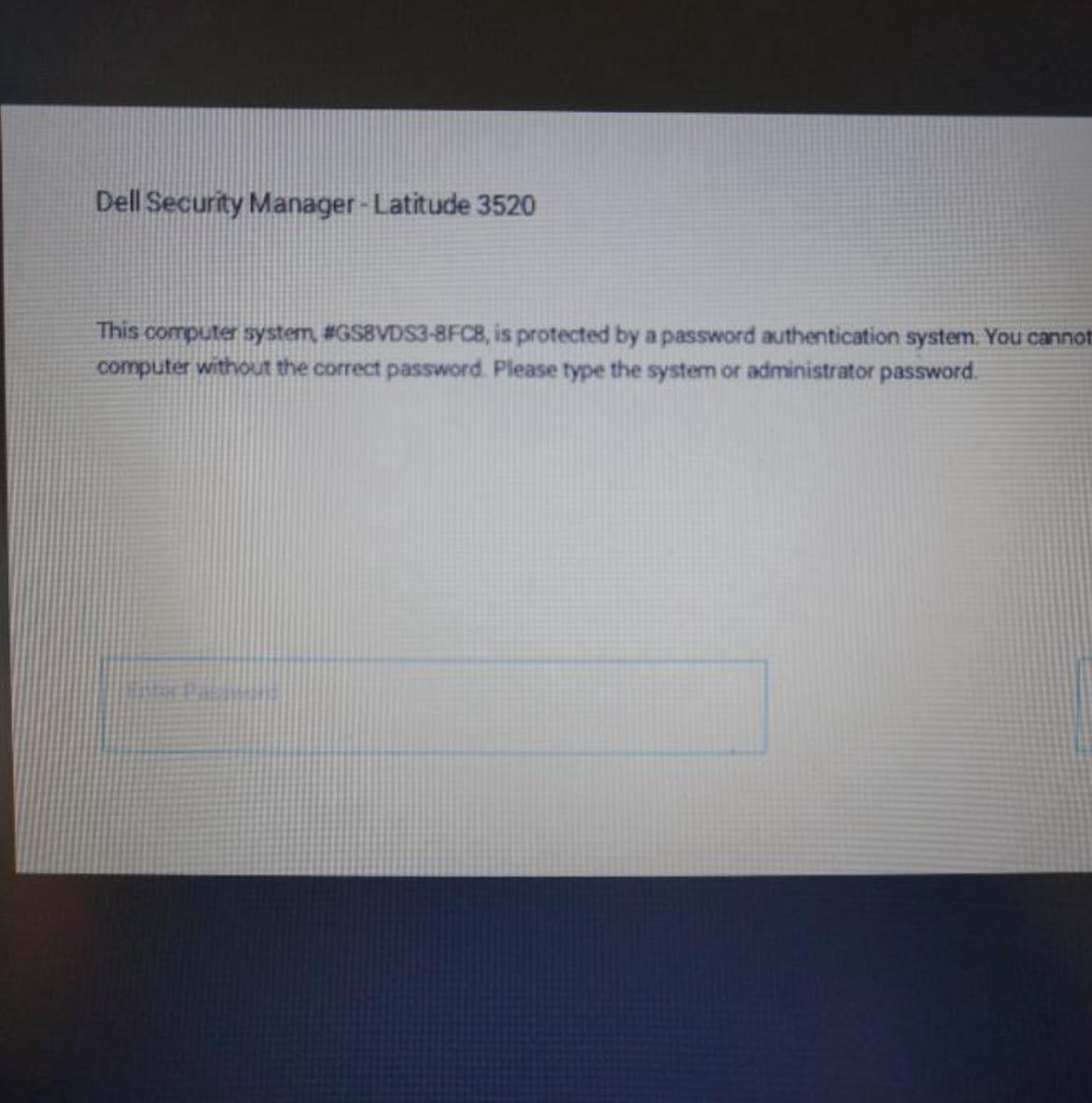

                                #396
                                Help me pass bios! thanks!
                                MFG YR:2023
                                ST:GS8VDS3
                                EX:36536471427
                                • hoaca388
                                  Badcaps
                                  • Jan 2022
                                  • 12432
                                  #397
                                  MFG YR:2023
                                  ST:GS8VDS3
                                  EX:36536471427
                                  Where is your original bios backup ?
                                  • SnapK
                                    • Jul 2025
                                    • 2
                                    • TPHCM
                                    #398
                                    No initial backup

                                        #400
                                        Originally posted by Weelcup
                                        Dear friends
                                        I need you help unlocking bios pass.
                                        dell latitude 3520
                                        st= B8K4BS3
                                        Thanks in advance
                                        3.4. Dell
                                        Dell laptops store the password in EC. However, some generators exist depending on the code suffix.
                                        See: https://beta.bios-pw.org/ .If the website is offline try: https://web.archive.org/web/*/https://bios-pw.org/
                                        Note: All passwords must be entered with a US QWERTY Keyboard,you can use a USB one.
                                        Note: The 6FF1 suffix has a bug,use your service tag with the 1F5A or BF97 suffix instead,Example: 1234ABC-BF97 .
                                        Note: The list of examples does not include some other suffix codes that do work,such as E7A8 .
                                        Note: If the BF97 suffix does not work try it with the E7A8 suffix instead.
                                        Note: There is no publicly available 8FC8 generator available at the moment.
                                        The CTRL-ENTER-ENTER keystroke after the password only applied to laptops with a suffix (xxxxxxx-8FC8 for example), until Dell also required it in some laptops using System Disable 16-Hex algorithm, on which only the Password+ENTER was needed at first and then in some models you needed the CTRL-ENTER-ENTER to properly delete the system passwords, otherwise the password would remain SET upon the automatic system reboot if just doing Password+ENTER until the proper CTRL-ENTER-ENTER keystroke was performed in certain models.
                                        8FC8 Patcher software: https://www.badcaps.net/forum/troubl...l-8fc8-patcher
