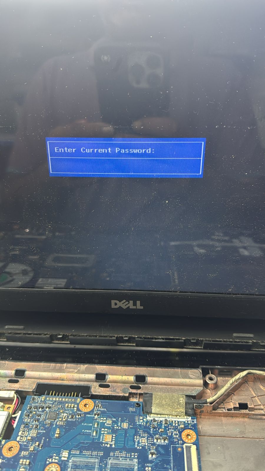

    BOARD NUMBER
    VAWOO LA-9104P REV:1.0 A00
    2012-09-13
    SERIAL NUMBER IS NOT AVABILE SIR

      How do you know there is a password in the bios ?

        SENDING YOU PIC

            Hi guys, I need support for a Dell Latitude 5510 , with a locked Bios Admin PW. The computer was from an Internet sale and was locked and Login Windows is also not possible, Reinstall also not possible since all external USB are not allowed to start from. Tried bios-pw.org, but got no passcode.
            Service Tag is: D3HQDB3-8FC8
            Any help is appreciated

              post the original content of the bios chip

                Thanks Peste for your reply. Sorry to ask you that, but how can I get the original content out of my Bios? I can see all the Bios settings but everything is locked down by this admin pw.

                  You must have a programmer, for example this CH341A : https://www.youtube.com/results?sear...mer+how+to+use

                          use this tool drag the 8mb bios to the tool. https://www.badcaps.net/forum/troubl...l-8fc8-patcher
