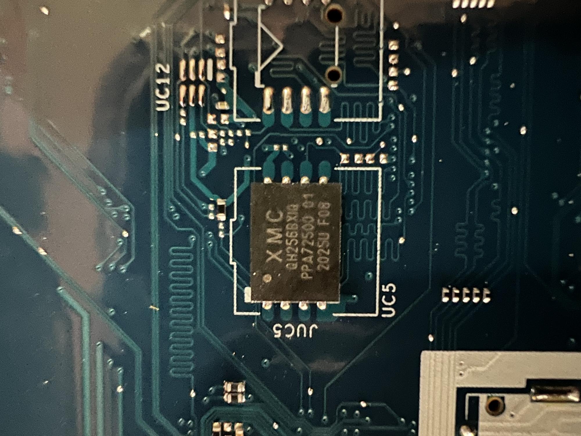

              found this chip qh256bxlq
              • onizzbox
                Banned
                • Nov 2018
                • 604
                • Brazil
                Re: dell latitude 5510
                @bacardi2001
                Perfect! Read the chip

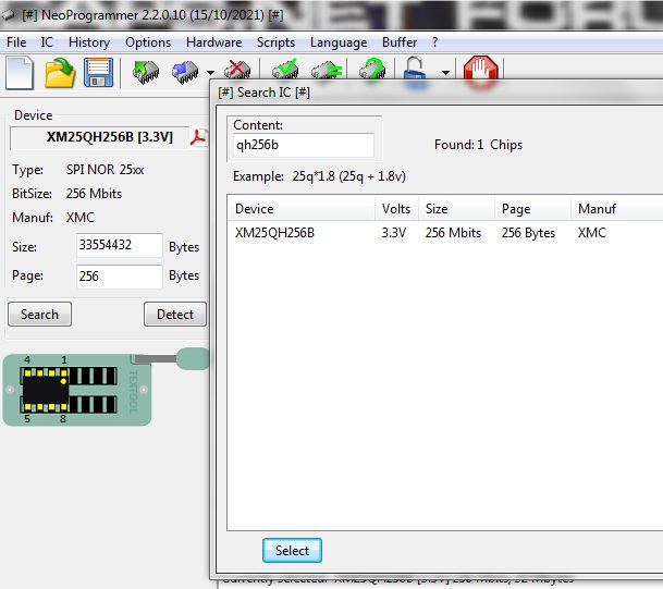

                      that chip isnt detected when i search for it with the software

                        is this the right chip?

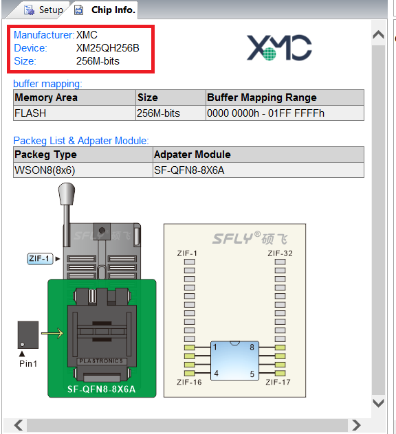

                            Can you manually select MX25QH256B ?

                                its not for the ch341a
                                  • 21032
                                  #36
                                  Re: Bios Password Dell Latitude 5510
                                  The CH341A will read it with NeoProgrammer software

                                      i just keep getting…ic is not responding…i don’t even think the clip pins are touching the chip pins
                                        • 21032
                                        #39
                                        The chip type is WSON8,it has NO legs on it,so the SOP8 clip will not work. If you can desolder the chip you can get a cheapo adapter like this one https://www.aliexpress.com/item/32847804960.html
                                        If you can`t desolder it you will need to solder wires to the traces,or buy a WSON8 pogo adapter like this https://www.aliexpress.com/item/1005001830846980.html
