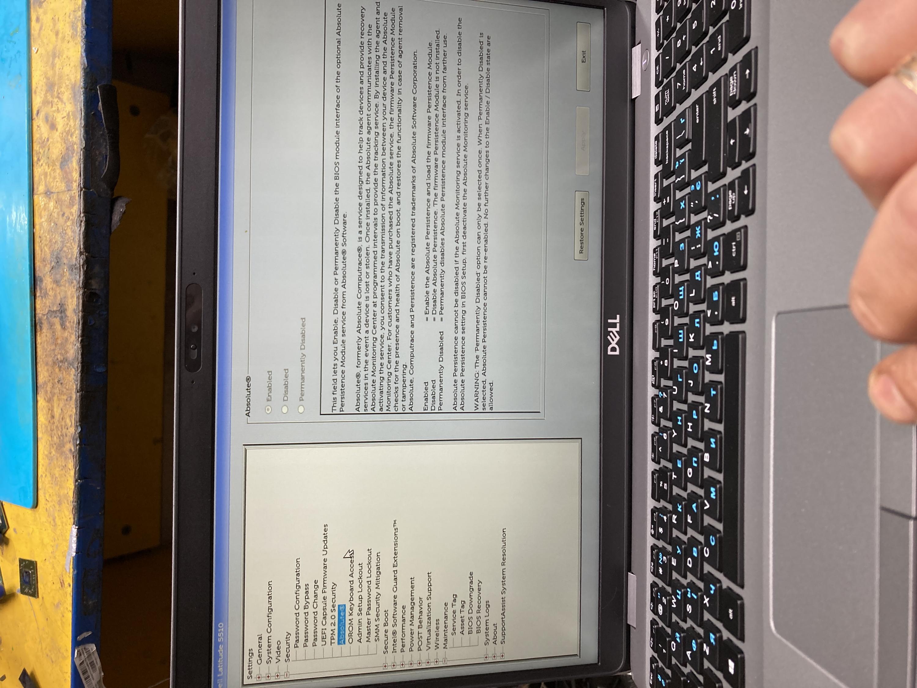

                    • volinakis
                      • Jan 2021
                      • 2872
                      • N/A

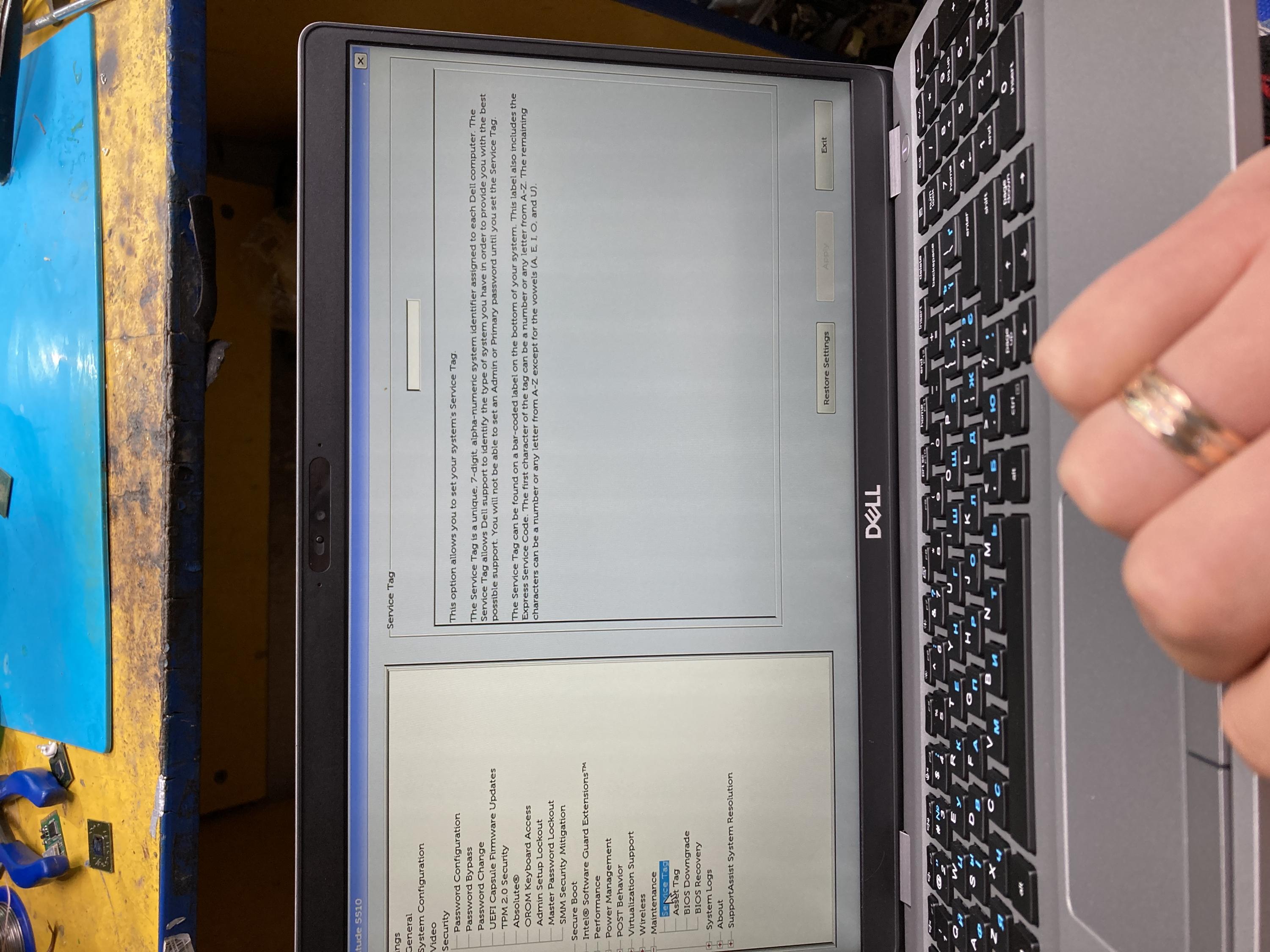

                      #90
                      Re: Bios Password Dell Latitude 5510
                      Originally posted by paul13
                      work but i cannt deactivate Absolute...
                      with new bios you had to deactivate Absolute, write service tag, save, then press alt+F to exit manufacturing mode.
                      • paul13
                        • Jul 2020
                        • 12
                        • ukraine
                        #91
                        in this bios enable, disable and permanently disable is not active and i cannt change
                        • volinakis
                          • Jan 2021
                          • 2872
                          • N/A
                          #92
                          man, write back bios provided by partner and your motherboard will be in manufacturing mode. Press F2, disable Absolute, write service tag, save, restart, then press alt+F to exit manufacturing mode.
                                  I haven't pressed Alt+F yet, This is the first inclusion after the firmware
                                  Latitude 5510
                                  Service Tag: BHSZZ53
                                  For the steps to do , follow post 92.
                                  https://www.badcaps.net/forum/showpo...8&postcount=92
                                  • paul13
                                    • Jul 2020
                                    • 12
                                    • ukraine
                                    #97
                                    Originally posted by lapfix
                                    Latitude 5510
                                    This work!!! Thank you!!!
