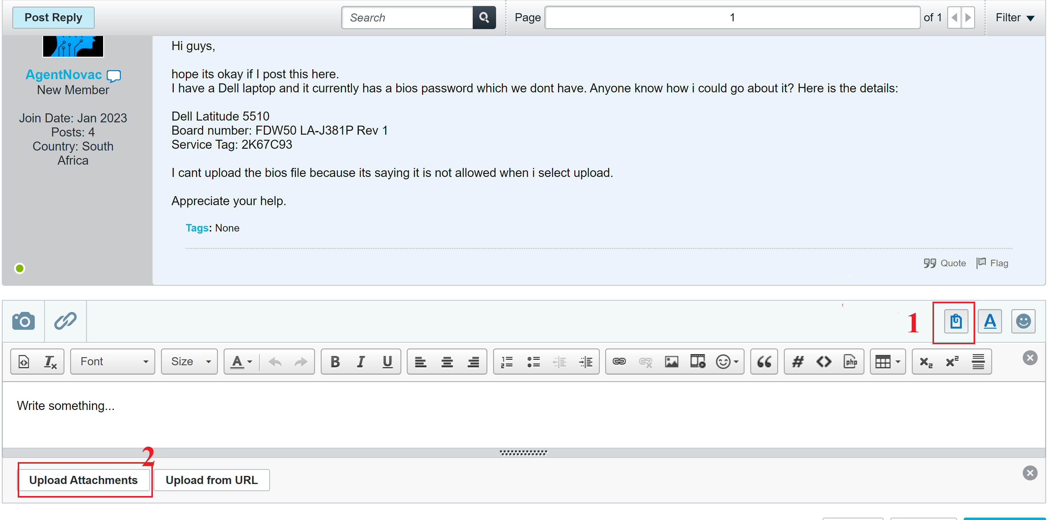

                  Hi guys,
                  hope its okay if I post this here.
                  I have a Dell laptop and it currently has a bios password which we dont have. Anyone know how i could go about it? Here is the details:
                  Dell Latitude 5510
                  Board number: FDW50 LA-J381P Rev 1
                  Service Tag: 2K67C93
                  I cant upload the bios file because its saying it is not allowed when i select upload.
                  Appreciate your help.

                    #150
                    Compress files with Winrar or 7zip. Click image for larger version
