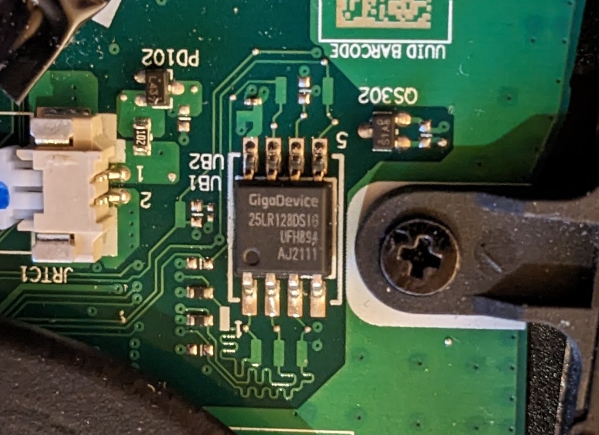

    I have a Ideapad 3 14ALC6 with motherboard Hs461 hs561 hs761 nm-d521 rev 2.0, and i will CH341a programmer, but chipset GD25LR128DSIG not found in data list (ASProgrammer or Neoprogrammer). Is there a way for me to add the chip for programmer with CH341a 1.8v adapter?
    The closest chip I could find listed was the GD25LQ128C 1.8v
    https://www.mouser.cl/ProductDetail/...RWx_mC8RhKqzrw

      Re: Hs461 hs561 hs761 nm-d521 rev 2.0 bios plz
      Originally posted by Raraneda
      Great post, one question:
      try a similar chip from the data list and see if you can read the bios chip, then post the content here..

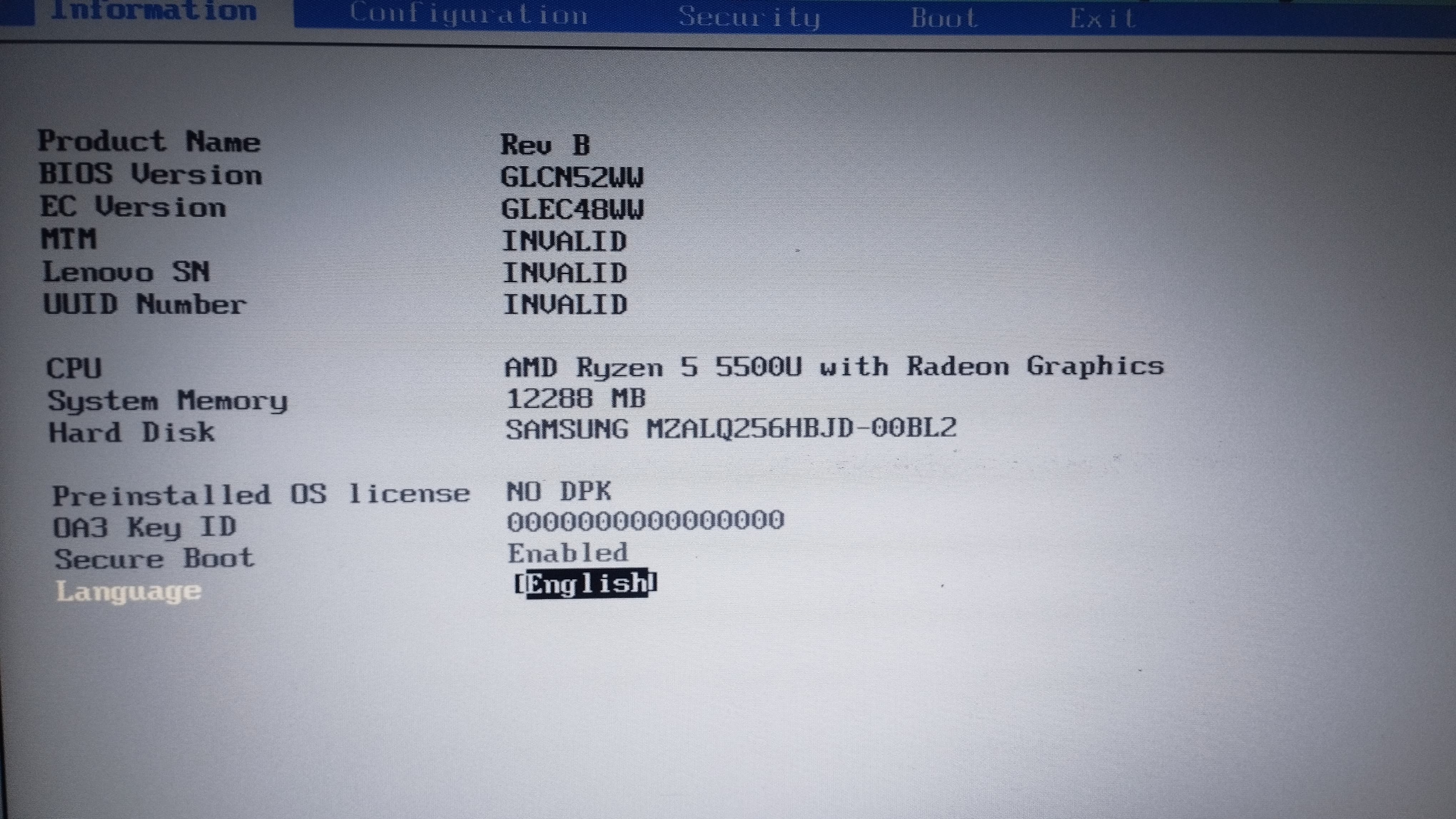

            I updated the bios of the ideapad3 15alc6, but my laptop went blank, the latest update was glcn52ww, I tried post 4, but failed, please help to turn it back on
            s/n : PF2Z76VV
            • hardware1
              • Sep 2021
              • 2925
              • N/A
              #46
              s/n : PF2Z76VV
              Try the BIOS from Post #31.If it works fine we can transfer your DMI.
                OK, I'll try
                • John889988
                  • Aug 2023
                  • 4
                  • Indonesia
                  #48
                  thanks, it works on my laptop, but the s/n is different

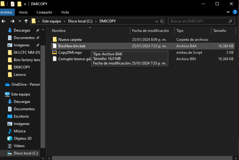

                                          Hello good morning,
                                          I did indeed follow the steps of publication # 52 (. How to make a macro script) and replace the following fields in the new BIOS.
                                          7. Copy 0x0520000 into Seletion start and 0x05207FF into selection end ,then click on OK
                                          10. Click back to the oldbios.bin tab and make a new selection (step 6) with 0x062D000 and 0x062D03F and follow steps 8 and 9 again
                                          I saved and installed the .bin.bak file on the laptop but it doesn't work. (If it turns on but the DMI information is not)
                                          I don't have a healthy backup BIOS. I only have the backup after being corrupt. maybe the DMI information was lost because the BIOS was corrupted.
                                          There is another way to insert the DMI information into the new BIOS or there is no longer a solution 😥
                                          Thank you for helping me.
