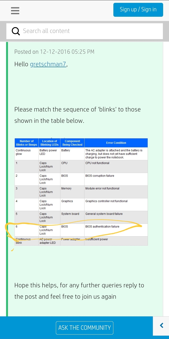

              #86
              Re: HP Elitebook 850 G8 bios locked
              Originally posted by hoaca388
              In the first boot, you have to go into bios setting for dissable all the security options.
              After flashing the bios and verifying the flash
              I got a 6 blinking caps lock led
              Which on hp website indicates a BIOS authentication issue
              Any suggestions??

                #87
                Check your process again, is it good to solder the bios chip to the motherboard, is the data written to the chip through the programmer guaranteed?

                  #88
                  I did a mistake reading the chip , but i don't think it's going to effect
                  The chip is 3v and i tried to dump ut using 1.8v adapter then i realized it's 3v chip
                  But it read and write fine..
                  Is that a problem??
                  • m3mo3y
                    • 31
                    • Sweden
                    #89
                    Yup it was a bridge solder joint 😥 and fixed and the laptop boots fine now with no password
