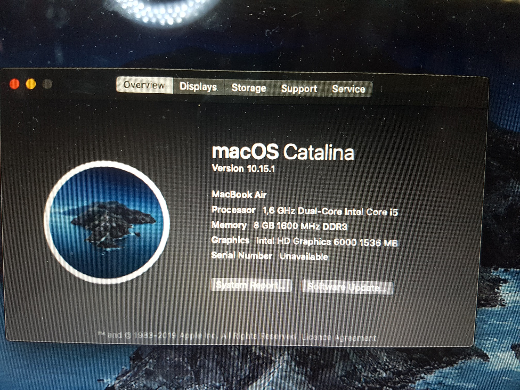

    Got this original dump from a 820-00165-A 2015 with no serial
    Everything seems to work fine, except theres no SN
    I tried to look for the "ssn" string but in this dump only one result and its not the Serial string
    It has Big Sur on the SSD, so I suppose something changed on this firmware version
    Anyone knows where to insert the serial?
    SN:CPWS37FDH3QD
    Heres the dump, in case someone has some minutes to help
    Thanks!

      thanks but even without trying it, I can check that the file checksum is invalid
      will try to fix it tomorrow and test the file anyways
      Nobody knows where the ssn string is in the original file?

        Works after correcting checksum, but its in Chinese
          Re: 820-00165-a 2015 - no serial
          Your entire Fsys block is missing/corrupt. Try this one, it's from a 2015 dump with clean ME, SSN updated and checksum corrected. I don't recall what FW revision it is though, so you may need to run the Big Sur installer through to update it.
