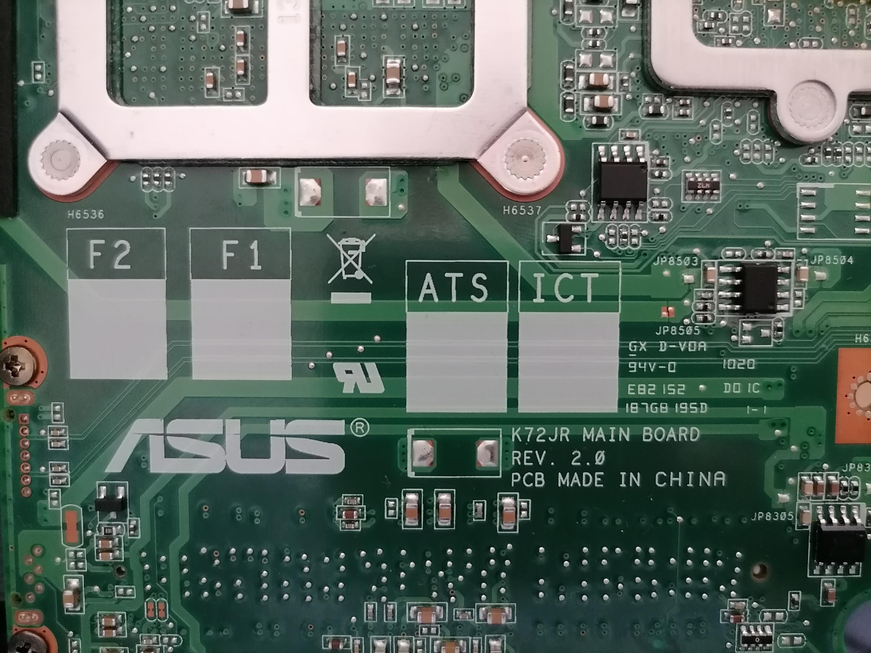

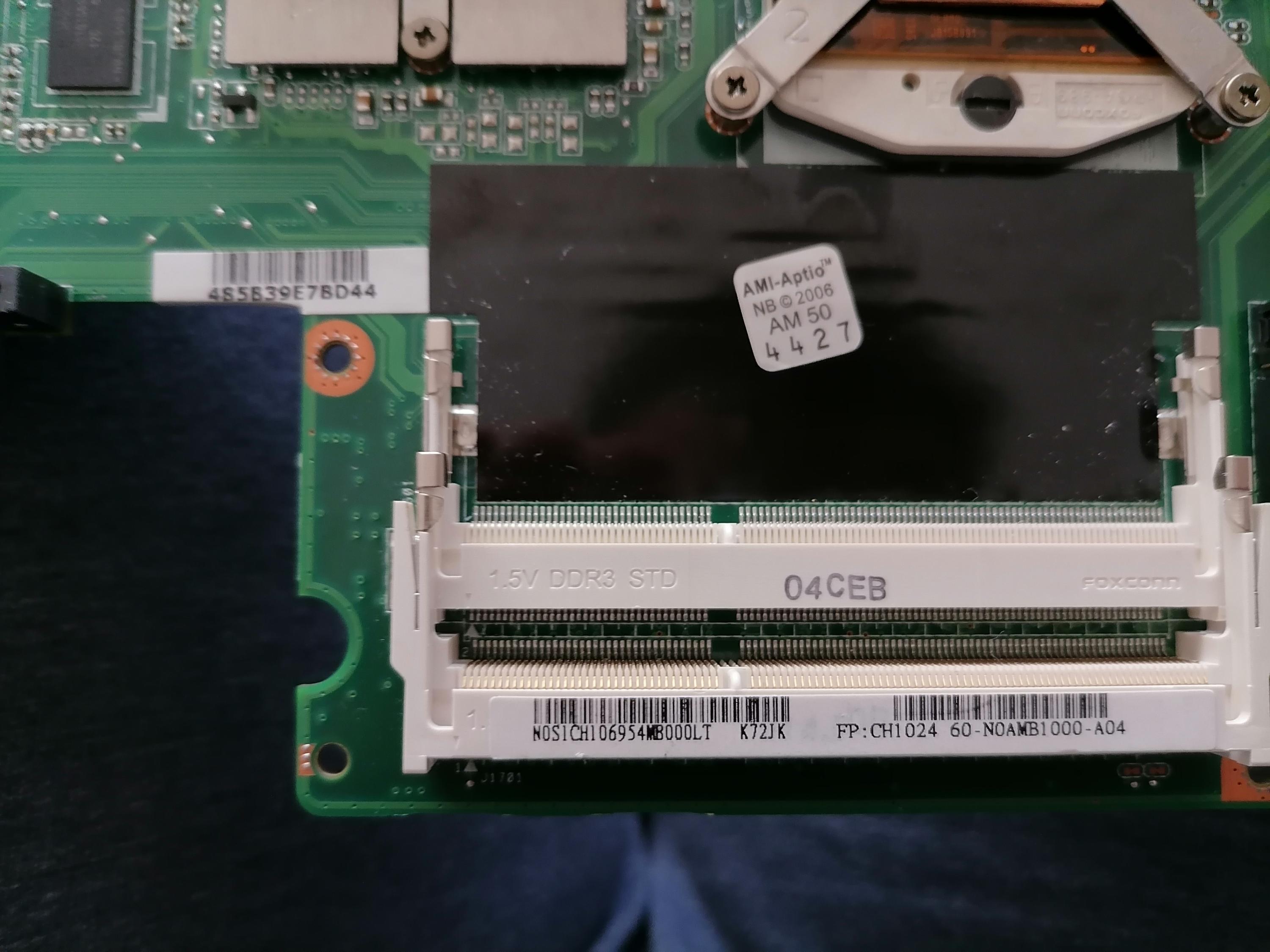

    I had "bricked" Asus K72JK laying around, long story short, I managed to create clean bios using this tutorial ([TUTORIAL] fix asus bios with bios from asus web support (by razor_amd)), but now I'm missing (MAC, UUID and few less important things). I tried using FD44Editor but it seems that K72JK is not supported.
    Are there any DMI tools for Asus notebooks?
    Old corrupted bios:
    New clean bios:
    Pics that might be useful (sorry for bad quality):

    Update,
    I managed to find the serial number in the dump, and a sticker with MAC address on the motherboard.
    Then I followed https://winraid.level1techs.com/t/he...owngrade/33678 to write them in the Bios and add random UUID.
