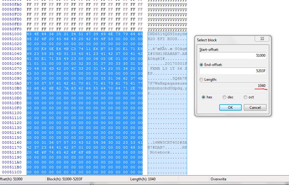

    Hello, can someone fix this bios
    with the other one i extracted from the hp website it works but no info
    • 21081
    Re: HP 15-ba025nv, la-d711p rev 3.0, FULL FAN NO IMAGE, FIX BIOS
    Copy the DMI from the offsets provided in the picture.Copy from the old and paste-inset into the new bios using the same offsets.

      Thank you i will try and post results
      do you know if there is a way to fix
      manufacture programming mode is in unlock mode
      from editing the bios file?
      so i don't have to run the hp program afterwards

        Yes just leave it,it will lock itself after 30 or so reboots.

          it worked for the info, but the 30 reboots did not work, i will do it with the hp program

                  This file already contains a filled DMI block (i.e. is copied from a working machine), the file in post #1 (working no info 082F6.rar) is virgin dump from HP, the DMI information should be copied from the old dump to the one at the first post.
                  I don't see any point in using any other file other than a virgin one from the manufacturer's site.
