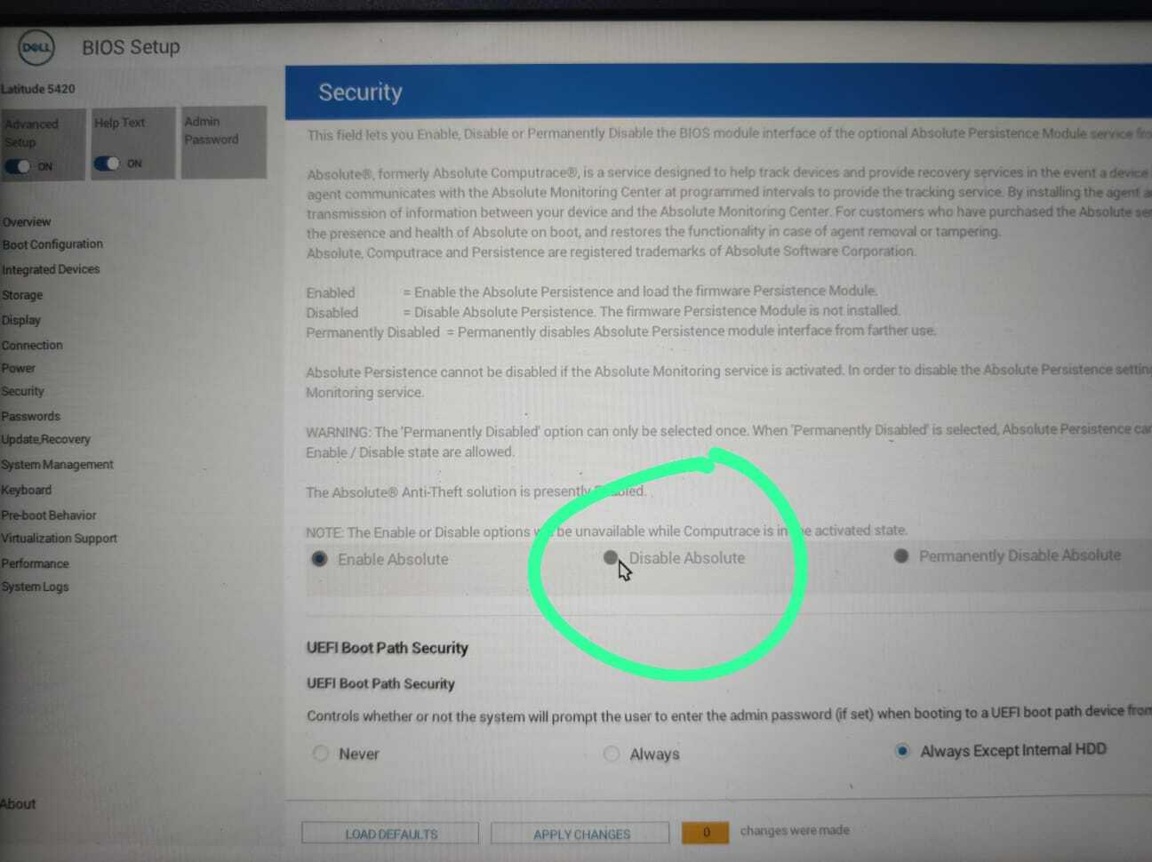

      Dell Latitude 5420 Main GDF40 LA-K491P rev 2.0
      model P137G
      ST C4C44F3
      need disable absolute
        model P137G
        ST C4C44F3
        try and feedback

          #864
          Originally posted by LBTT1121
          try and feedback
          Thank you, the device is working but it keeps getting stuck on the Dell logo.?
          Dell Latitude 5420 Main GDF40 LA-K491P rev 2.0 (cpu 11th)
          model P137G
          ST C4C44F3

              #866
              Originally posted by shiyab
              hi try
              Thank you, the device is working, but the image does not appear.
