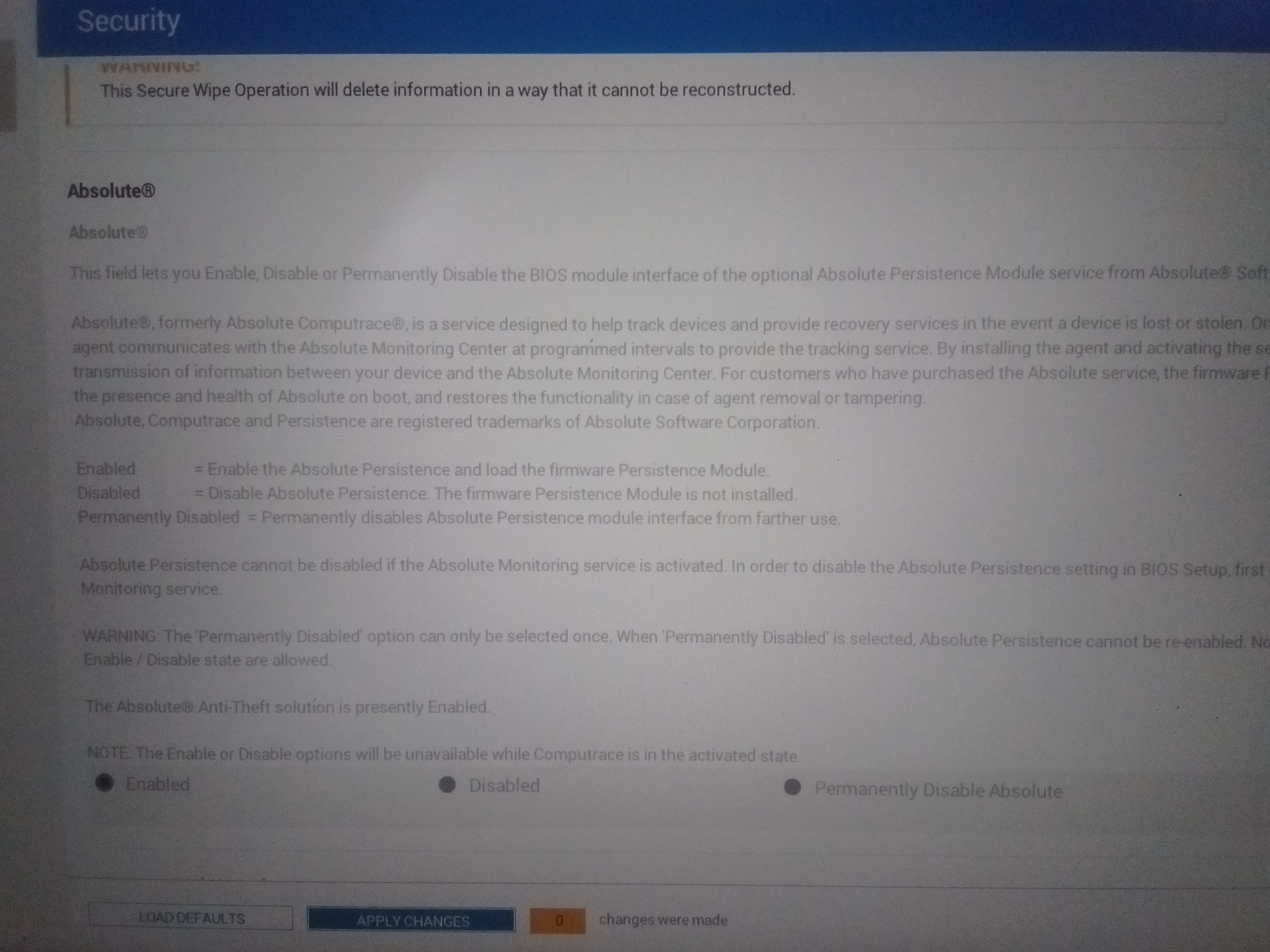

    1st boot, press F2, write service tag, disable Absolute, save, restart. 2nd boot press Alt+F to exit manufacturing mode

      • Tanner Daugherty
        • Oct 2024
        • 6
        #743
        the bios patch was successful however I've found that Absolute is enabled and greyed out, would it be possible to disable Absolute as well?
