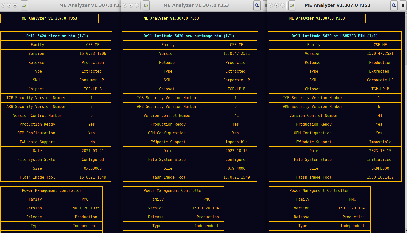

          Hello everyone. My Dell 5420 does not display the image. When I load a file on the forum, the screen only lights up and shows the image. Please help me. Main code" LA-K491p, ST: HSVK3F3.
          Thank you​

              Thanks. I loaded your clear file but still no image and no screen light. Can you help me rebuild my file. Thanks all !!!

                #707
                Dell_latitude_5420_new_outimage.zip
                Try this file ....

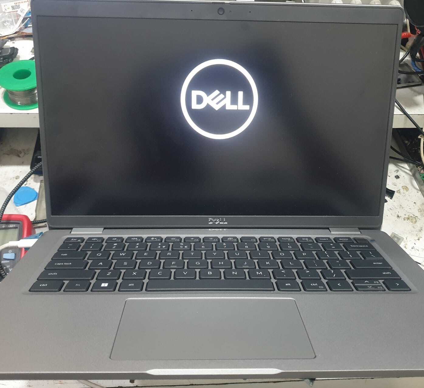

                              i tryed this (outimage # 107 ) with this file Laptop getting power on but hang on Dell Logo
                                here try
                                • rjsoft9
                                  • Aug 2018
                                  • 21
                                  • India
                                  #716
                                  Originally posted by rex98
                                  here try
                                  Thank you for your reply & your valuable time but Same hang on Dell Logo

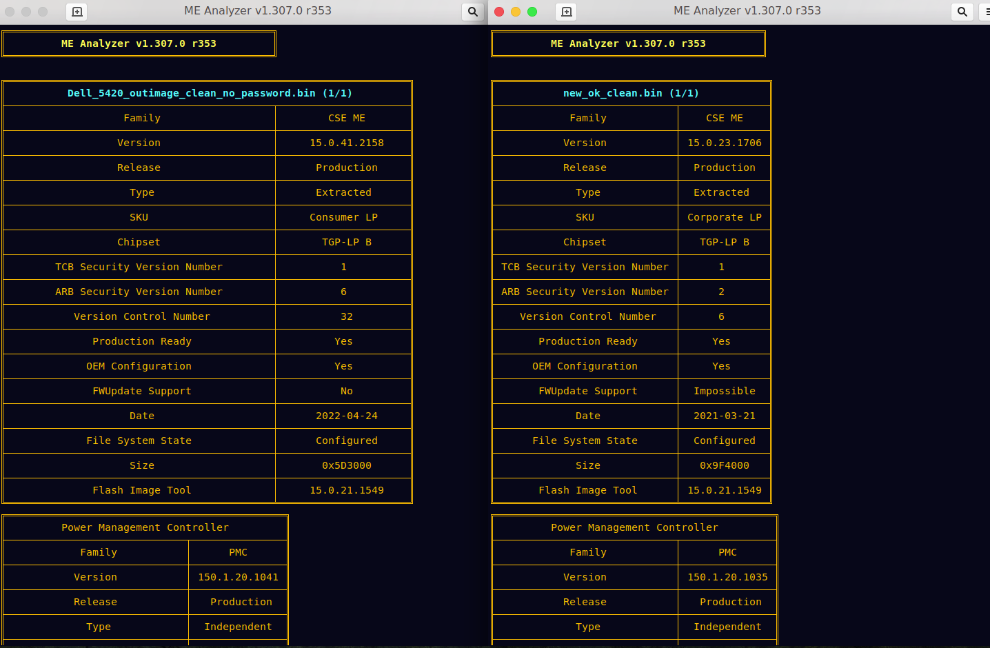

                                    Sorry that my BIOS doesn't start but I think it's because my BIOS is a Consumer LP and it should probably be a Corporate LP.
                                    That won't fit.
                                      SMDFlea commented
                                      Editing a comment
                                      You can view the product specs (laptop configuration) that the laptop shipped with at dell support. Enter the service tag at the support page,then look at the right side under "Quick Links" -> "View product specs"

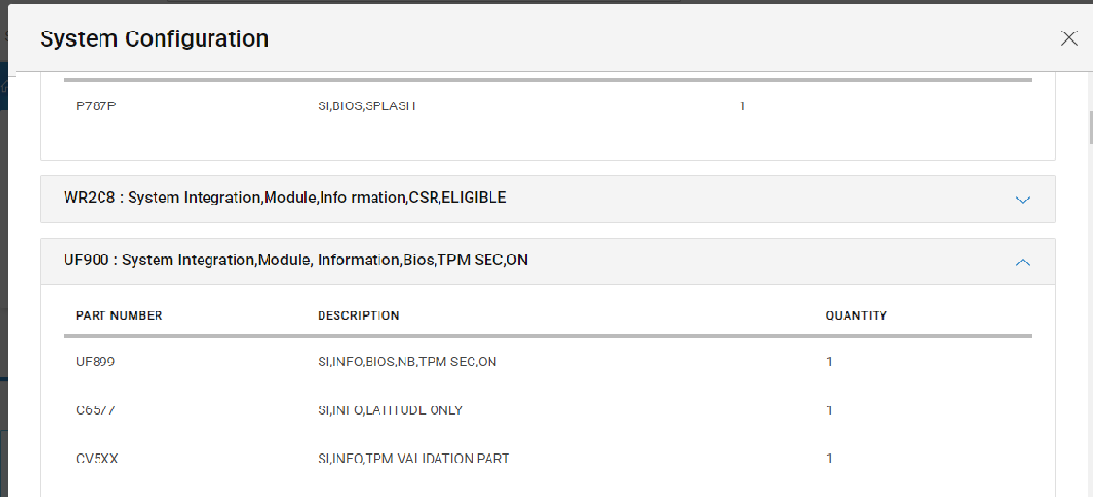

                                    i found System Configuration
