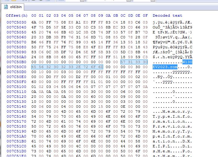

                Re: Bangho bes-1308
                Originally posted by SMDFlea
                Post U27 backup if the passwod above doesn`t work.
                here u go buddy
                  • 22289
                  Re: Bangho bes-1308
                  try this bios
                  • el panke
                    • May 2019
                    • 78
                    • argentina
                    Re: Bangho bes-1308
                    try this bios
                    wont turn on with this one
                      • 22289
                      Re: Bangho bes-1308

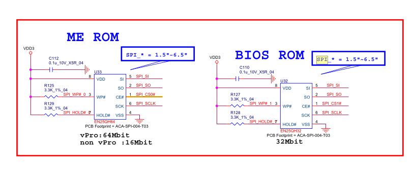

                      I posted a virgin bios for a clevo W130EV ,thats what your backup is from,so maybe its the wrong one see the picture.
                      I found a bios on a "paid" site, "Clevo W130SV - 6-71-W13e0-D02 - W130ExMB-0D"
                      Try the W130SV bios here: https://repo.palkeo.com/clevo-mirror/
                      login username: repo
                      password: repo
                      The bios is 12MB it will need cutting into 8MB and 4MB using a hex editor.The bios is split accross 2 X chips. Do you have a chip at U32 already ?
