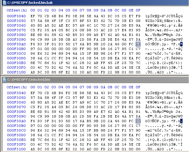

                        • just_bios
                          • Mar 2021
                          • 39
                          • Netherland

                          • Markus1741
                            • Sep 2020
                            • 873
                            • N/A
                            Re: Latitude 7210 2-in-1 Bios Password
                            Originally posted by just_bios
                            hey..
                            can u pls unlock my bios too..
                            tia..
                            Hello try this unlock tool it works ....
                            https://www.badcaps.net/forum/showthread.php?t=125468

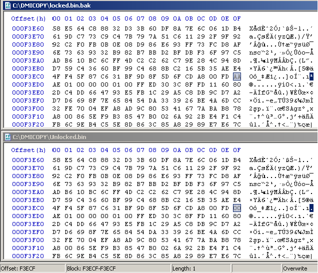

                              hey..
                              script changed 4 values.. let me test it..
                              Code:
                              034: C:\USERS\DESKTOP\DELL\UNLOCKED.BIN
                              035: C:\USERS\DESKTOP\DELL\UNLOCKED.BIN
                              036: File has been loaded, checksum: 16bits_0x53B1 ,32bits_0x66D253B1 :
                              037: Chip pins contact is detected OK.
                              038: Chip ID verification OK.
                              039: Start writing chip......
                              040: Auto erasing...
                              041: This type of chip capacity is big, so erase time is take longer, please be patient!
                              042: Erase successful,Elapsed time:61.92 seconds.
                              043: Start writing...
                              044: Write successful,Elapsed time:41.62 seconds.
                              045: Auto verifying...
                              046: [B][COLOR="Red"]Verification successful[/COLOR][/B],Elapsed time:30.77 seconds.
                              047: Status register1 values: 0x40, Status register2 values: 0xFF .
                              048: Elapsed time: 135 seconds,average speed of 248503 bytes/sec.
                              049: >------------------------------------OK---------------------------------------<
                              thanx..

                                it worked.. device gives "manufacturer mode activated" then turned it off but touchscreen is not working..modded bios "unlocked.bin" can damage it..?
                                • volinakis
                                  • Jan 2021
                                  • 2800
                                  • N/A
                                  press F2 to enter bios setup, write service tag, save, restart, press alt+F to exit factory mode.
                                  • just_bios
                                    • Mar 2021
                                    • 39
                                    • Netherland
                                    yes i did it.. factory mode gone.. but touchscreen is not working.. i will restore bios eeprom..
